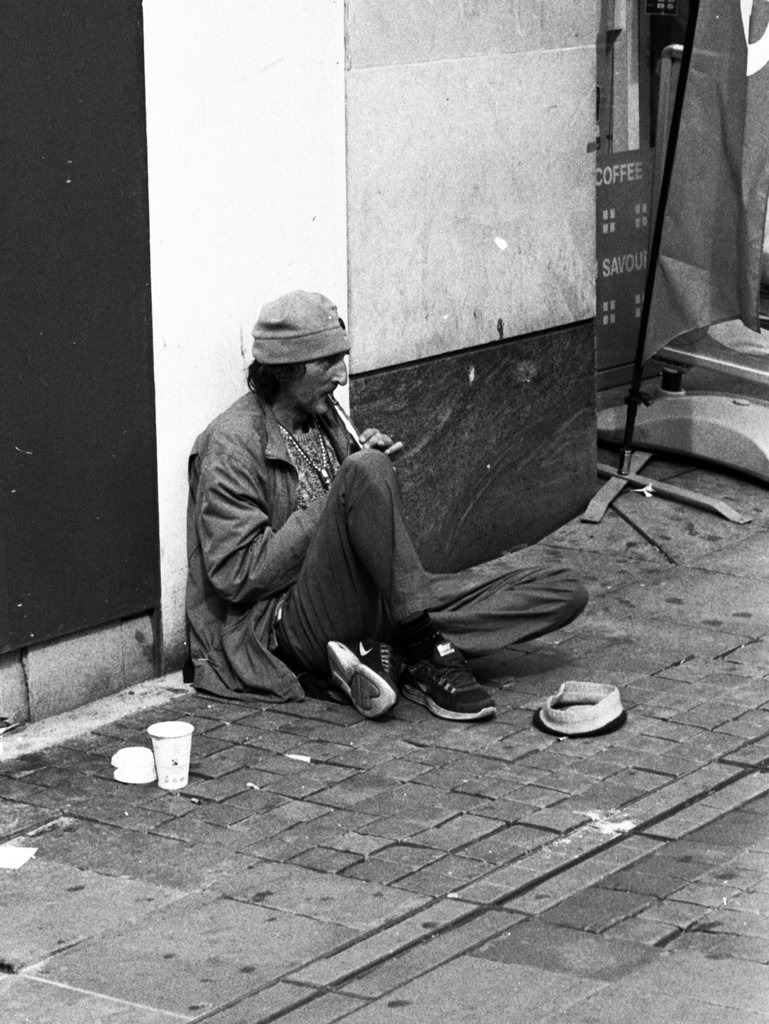

Hi all,
I was hoping to draw on the wealth of experience here.
I like to shoot HP5 and process in Rodinal (substitute) because I love the 'age' that it gives the images. Only problem is that I tend to get quite noticeable grain, (I previously processed FP4+ in Rodinal with great results).
Have read on many sites that this is common for this combination, but is there a preferred method to at least minimise the grain clustering?
Have consulted the 'Darkroom Cookbook' and 'Film Developers Cookbook'.
My method has always been Rodinal 1:25, 20c, 6 minutes, agitation first minute, 10s every minute after.
This is the result. Cheers :-
The combo is what it is.
Minimizing exposure and development may help.
Switching up to medium format will help. Similarly getting closer to your subject may help, say head and shoulders portraits instead of full length, helps make subject details more prominent than grain.
Switching to Delta 400 or TMY or TX or back to FP4 may help you refine your results too.
But, part of the 'age' or look or feel or whatever you want to call it is the grain. And, nice sharp grain actually helps photos look sharper.
Everything in the system affects the perceived graininess. Lighting, lens contrast, flare, how its printed...
My advice though, before you change anything, is to put the print on the wall (thumbtack or frame) above the sofa, get back off the sofa and with your feet on the floor and standing up straight look at the print and ask yourself does it look good? Leave it there for a week. If the grain still bothers you after a week, try one of the fixes above.
It's an inherently grainy combination. If you insist on that film+developer combo, then try developing at 18C and using less agitation, e.g. 30s at start then for 5s every 3 minutes. Obviously you will need to develop longer, and it will change the tonal curve somewhat, maybe to something you don't like any more.
You can also use grain to your advantage, found this this morning, not HP5 (it was shot on TX) but close enough to get the idea across. Dead Link Removed
If you don't like grain then I can't think of a worse combination. HP5+ is by nature a grainy film, grainier than 400TX. You have at least two options. Switch to FP4+ and Rodinal or HP5+ and a fine grain developer such as Ilford ID-11.

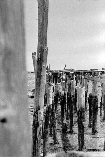

If you like that look and do not want to see as much grain, use thornton. If the chems are not found locally, B&H will ship internationally.
Thornton is a high acutance developer, especially when used standing. Being 2 step developer the dev times are short enough not to have any of the typical streaking associated with stand. The recipe is posted on this site.
Here is something shot with neopan 400. Sorry I have no samples for hp5+, but you would be in the same ball park.
