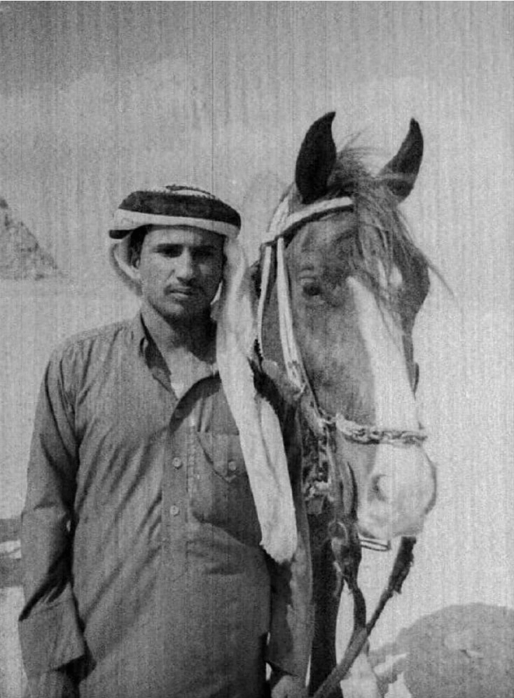

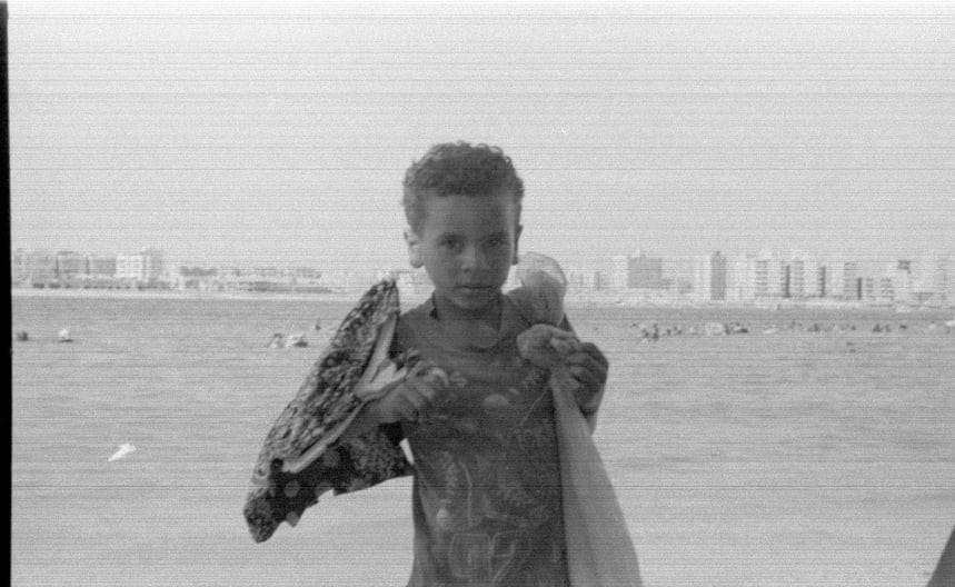

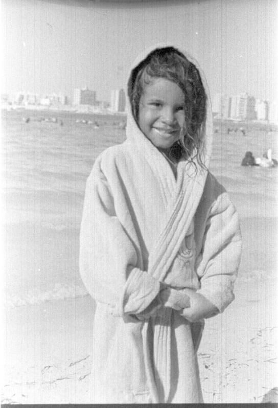

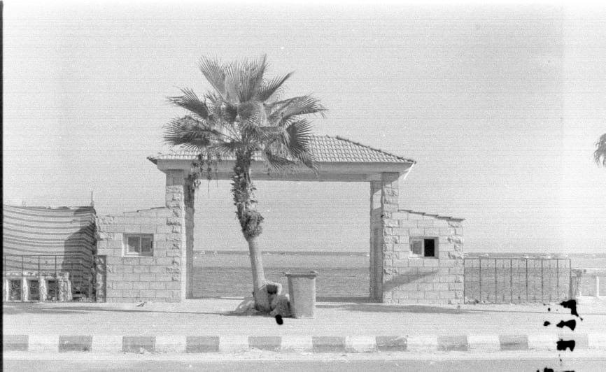

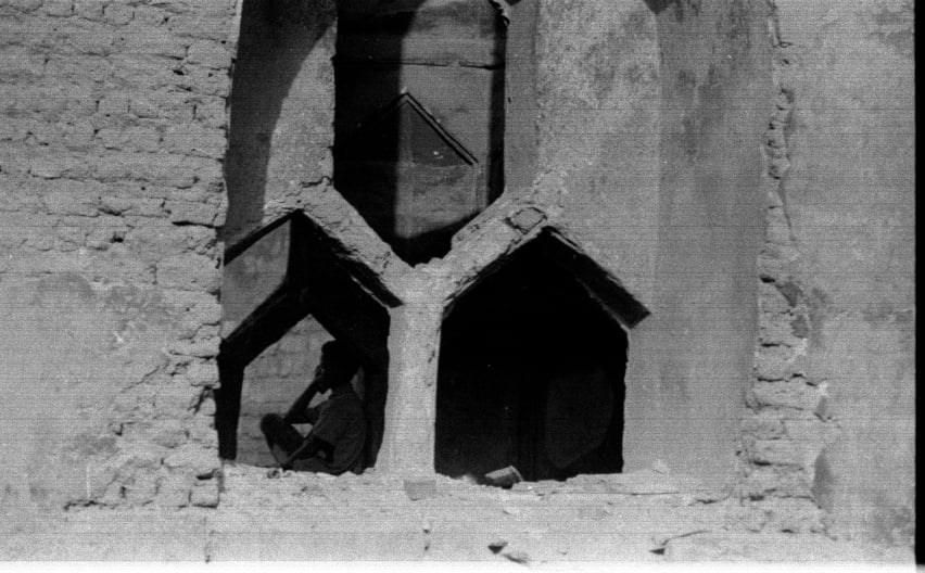

I received these results from the same friend in Cairo.
Expired in the year 2000 and photographed on ISO 6 - developed with chemistry (Kalogen), 1:100 - 11 minutes - 20 degrees.
Where is the problem here?
Did he get too much light?
Did he get (development) too high or too low?

About these images - effects of expiration date + exposure problems? Slide film cannot pick up as many info as negatives do, so in slides the exposure should be on-point. Last pictures especially hint me of metering problems in harsh contrast. Try less harsher light (around the time of Golden hours), Zone system or metering from your subject (meter close if don't have a spot meter), not including the background in the reading.

Since you have known good C-41 color developer, assuming you have enough of this film to test with, I'd try a roll or partial roll in the same E-6 process, but using C-41 color developer in place of the E-6 color developer. This should produce color positives with small color shifts (due to not quite right dye formation by CD-4 instead of the CD-3 you'd have in E-6). If that works, you'll have confirmed that either it was a one-time problem (like getting the chemicals out of order -- happens to the best of us) or your E-6 color developer has gone completely inert.
Another test would be to develop a black and white leader in the E-6 color developer -- you can do this in the light. If it turns black in a couple minutes, the color developer is probably fine and it was a process error; if not, that color developer is dead.

At the very beginning of the thread, you showed that you successfully developed some of the film using a black and white developer. The contrast was low, so perhaps developing longer would boost it. Perhaps try a few different developers to see which one works best.
Increased agitation frequency will boost the contrast further, if needed.
Yes, this roller was developed by one of my trainees at his home, without him coordinating with me.
Basically he got that roll for free so he took that risk and used the Kalogen developer I had given him some time ago.
