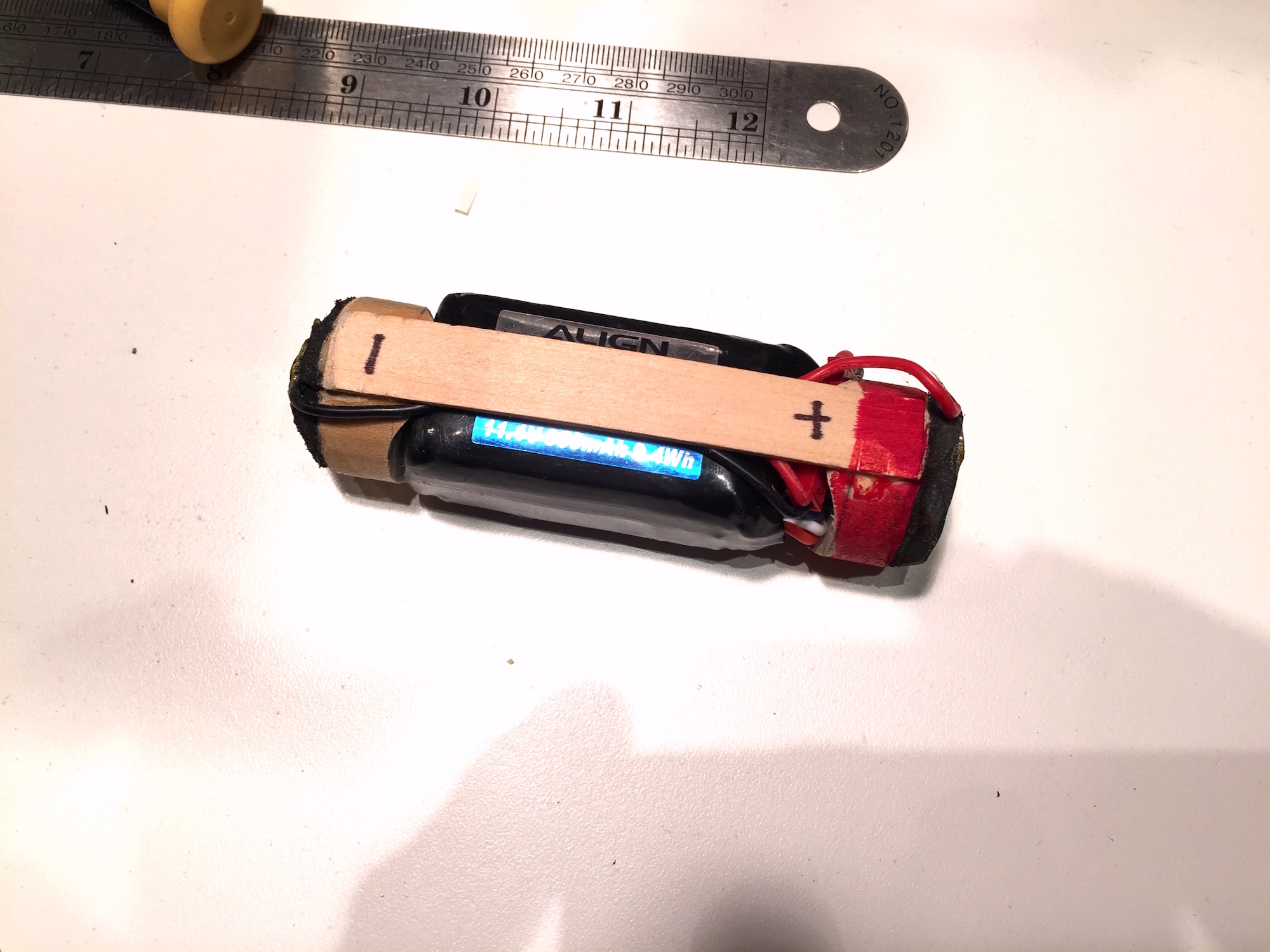

I found lithium batteries excellent replacements for Nicad and NiHm cells. Obviously, leaving the flash on will destroy the battery and the battery needs to be removed from the housing for a balanced charge, but the batteries I'm using cost about $5 (3-cell; 12.6v)
