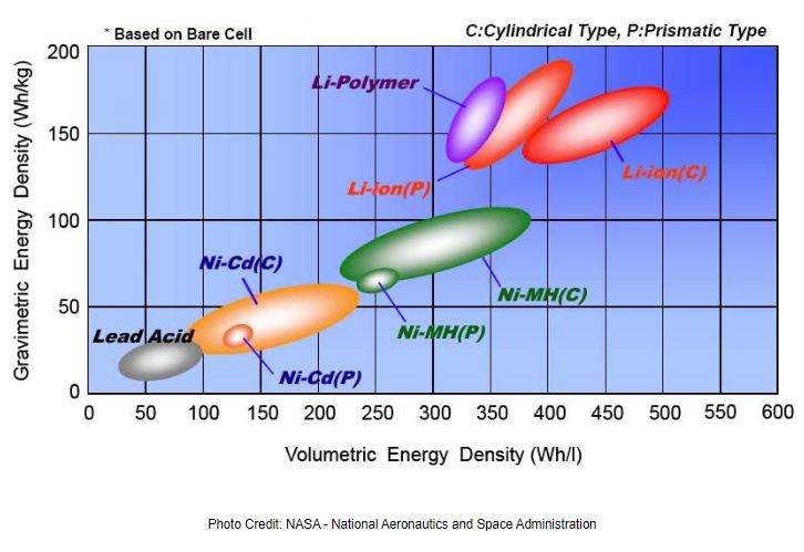

Quantum packs for sure can receive some hacking with Lithium battery. There's a reason Lithium batteries power electric aircraft. They are lightweight and your shoulder will appreciate that.
