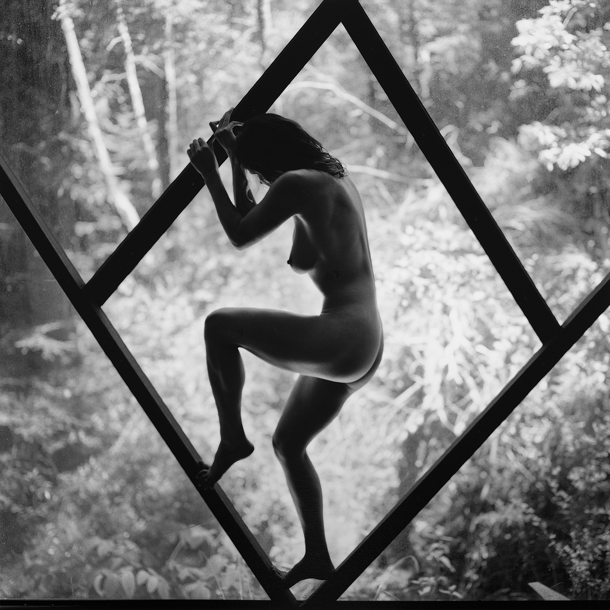

No hybrid, I want standard silver gelatin print, evetualy Lith print. I scan only to see which photo I decide to put in the chemicals, as contact printing never resonated with me.

Thank you all for input. I use Fomabrom FB and Fomaspeed RC variable grade papers, Ilford PQ universal, V35 Focomat. Paper size - I use usually 30x40cm.

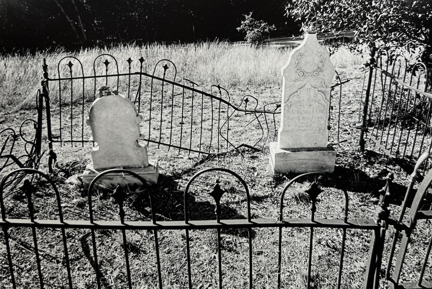

About dodging and burning: when I have bigger areas - I have no issue with that, but when I need to dodge something very thin, like those skinny arms and legs - I always get unsatisfying results. Area around face, legs and arms are also dodged, and I see uneven results there. That is why I ask about alternatives, what would you guys try.

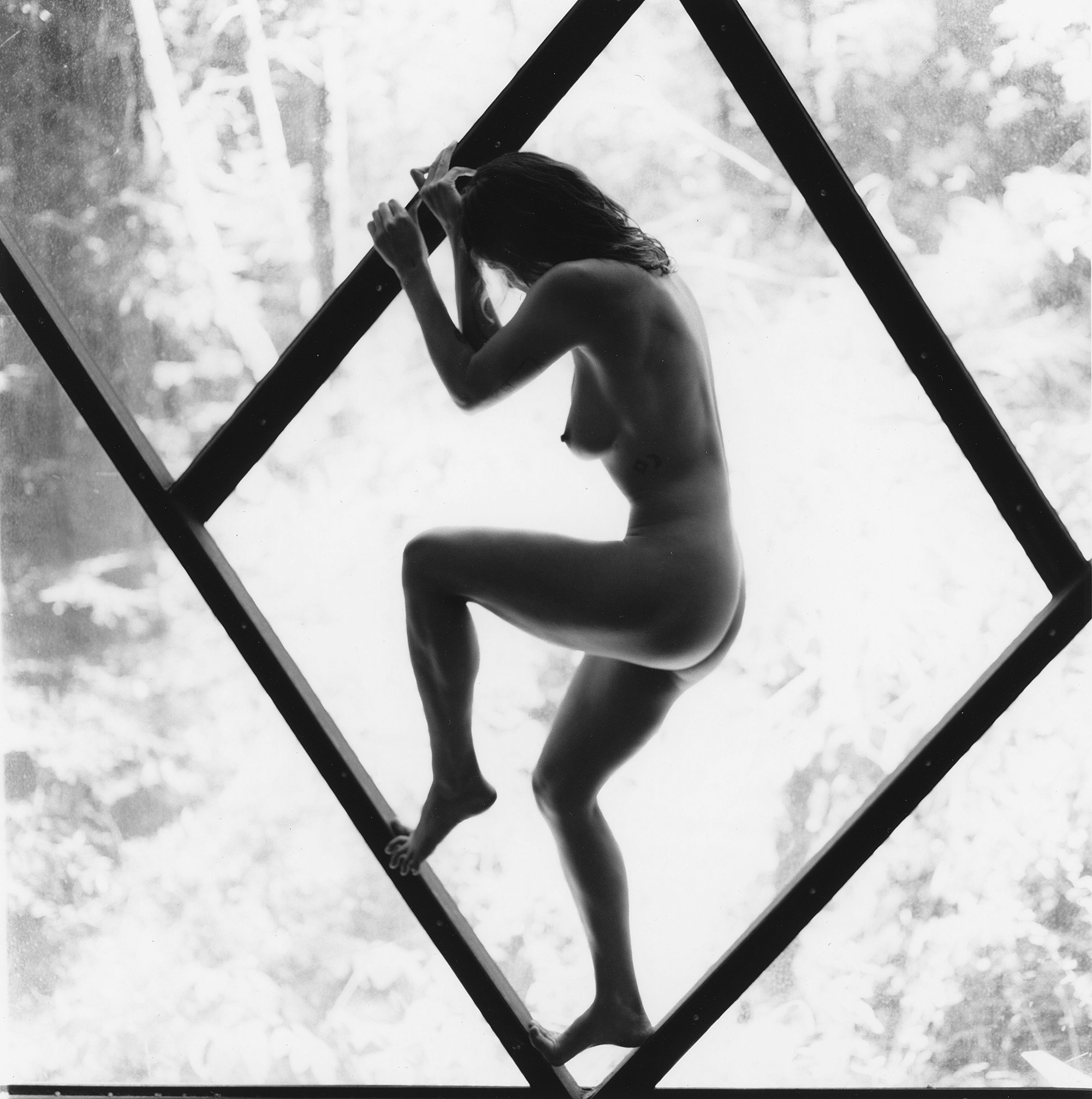

In the case of the image you posted in #1, the solution is simple IMO: start with a shorter base exposure, then burn all the rest. Much easier than dodging the figure.
If the result is too harsh (i.e. transition between burned and adjacent areas too harsh), improve technique.

I'd find the exposure that gets detail in facial features, adjust contrast, and accept the photo as is. The suggestion to pre-flash might actually help in that instance, since it would add some density to the highlight areas of the print.
No way would I dodge the face. Faces are the most looked-at part of such photos and the exposure should be correct right there. Base the rest of the print around that.

Wouldn't the figure in the image still be under-exposed?
If one were to make a print correctly exposed for the figure and cut that figure out and paste it to a second print correctly exposed for the background, careful work could make a picture like e.g. Fading Away by Henry Peach Robinson.
But really the shot needed fill flash or a reflector in the first place.
If one were to make a print correctly exposed for the figure and cut that figure out and paste it to a second print correctly exposed for the background, careful work could make a picture like Fading Away by Henry Peach Robinson.
Yes... i get it now.
For a capable darkroom aficionado though, IMO it would be less work and easier ....to print for the figure..... make a simple cardboard cutout mask and burn in the remainder of the image.....
I may be missing something. So does the whole negative get a shorter exposure? I can see that a shorter base exposure might help the figure which I think is the problem part of the negative then when all the rest is burned as you suggest but don't you stil have to dodge the figure but avoiding the white halo effect that often arises when the area all around the dark figure is much lighter and doesn't that take him back to the art of dodging and burning?
Yes I accept that a dodge here is easier than ít would be on the second picture where the thin legs and arms create bigger problems

With respect to the first example I agree with those who have suggested finding the right exposure/contrast for the person’s face and see where everything else falls. If it’s not too jarring to ruin the whole thing and you don’t want to do more work I’d stop there. The person/face is the main subject so you want to do a good job on that.

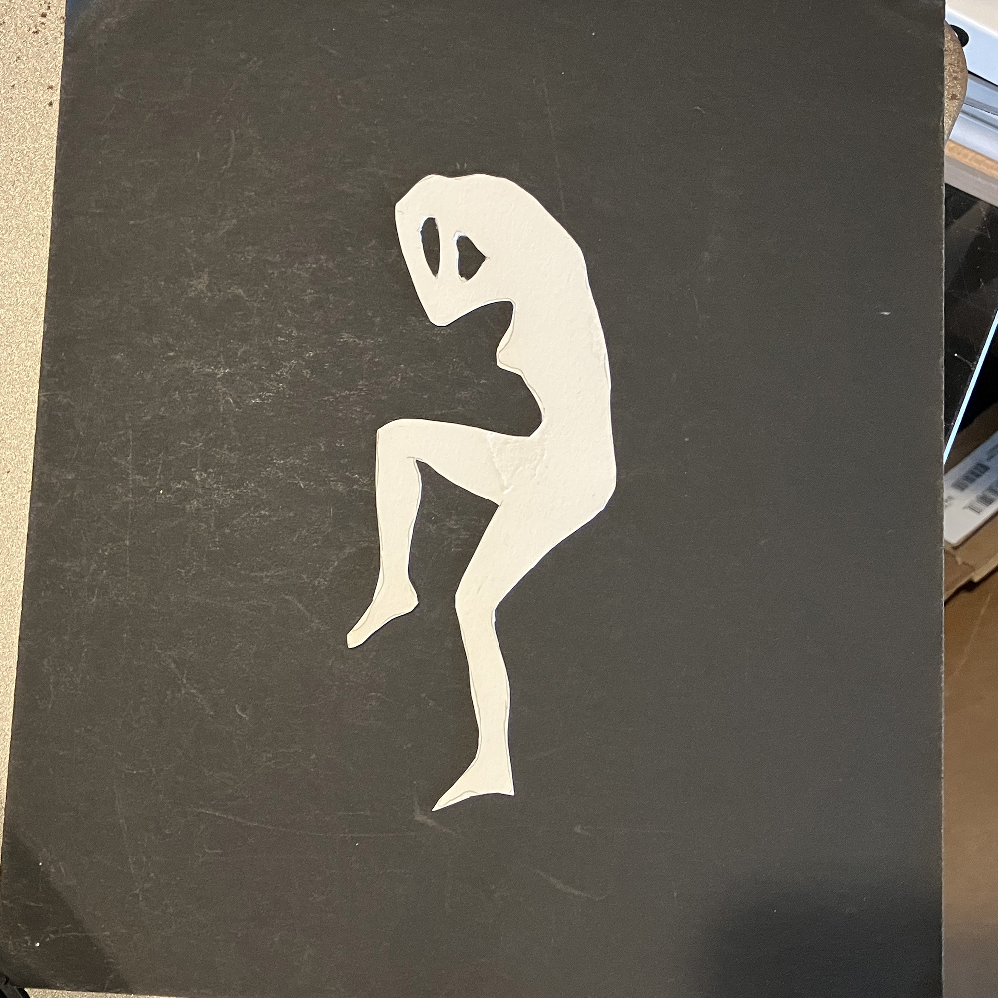

Sometimes for a figure like that, I put a sheet of Bristol board on the easel and trace inside the shape, smaller than the figure itself. I then cut inside the lines by a few mm. I will tape the resulting cardboard shape to a piece of thin wire and carefully position it just above the projected image to dodge, hovering and moving the tool so there will not be any hard lines and the transition between dodged and not dodged areas is minimal. Here is an example: in this case I exposed for the figure, then burned the rest.
