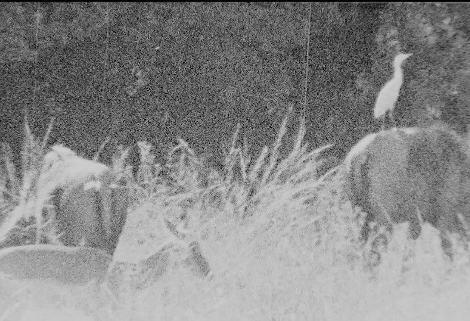

Oh, man, I am trying to get smallest possible grain from a super 8mm film. for the other formats I am not really bothered much from the grain.
Are you using Super8 film for enlarging or scanning? For projection it wouldn't matter much if the grain were present.
I am scanning , digitising it,to movie files, and yes it matters a lot, as you can see from the scanning on top, its a big grain.
Thomas might be right. It also looks like it might just be slightly over-developed by the looks of the highlights. If so, that can also add to the large grain you are seeing.
Oh, Super8. That's a really tiny frame. Back in the day I could approach 16mm quality in S8 with Kodachrome 40 and exacting exposure. A lot of people assumed it was 16mm. But K40 is no more. The last S8 I shot was about a year ago, 7266 Tri-X. It's pretty grainy stuff, not a lot you can do about it. I have seen programs that reduce the perception of grain significantly in digital post-processing of MP footage. That's probably the way to go. I'm talking about moving pictures, not stills.
