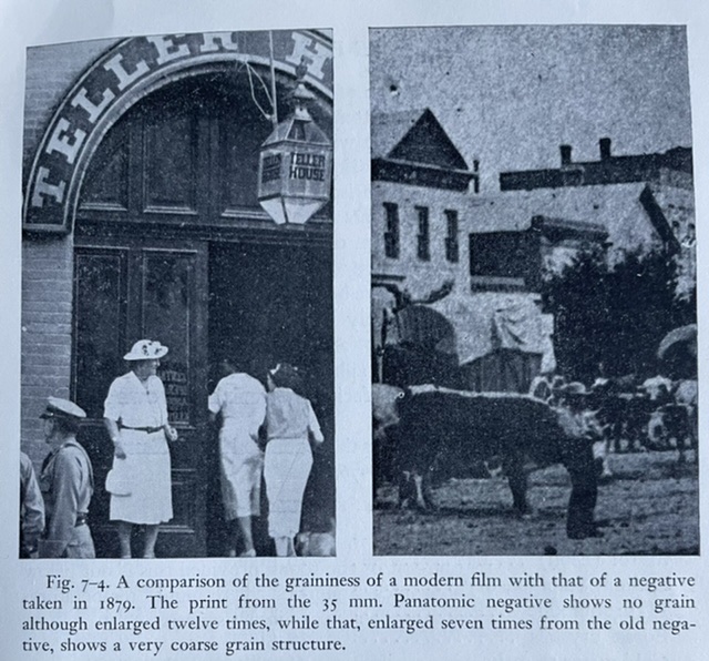

I think getting grain like the image on the right from 1879 would be a fun project. Trying to achieve this with a large format negative would make it more interesting.

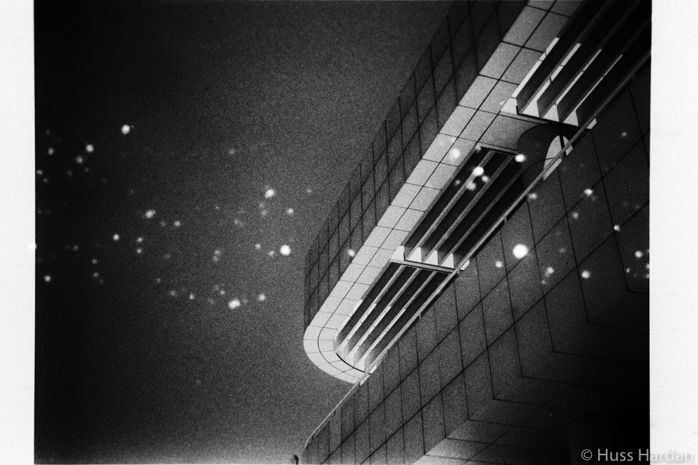

Jeez Huss, what is with that large format stuff? I mean you have to lug that huge 110 camera around all day? Who has the energy for that? Plus you get all that fine grain. I prefer a more hand holdable camera like the Minox.

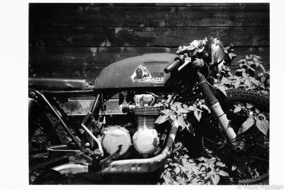

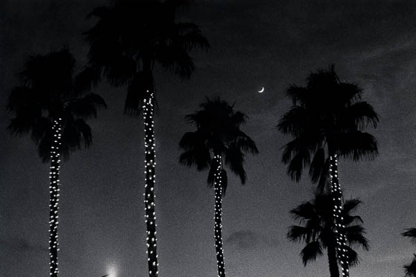

Fomapan 400/Rodinal in a Minox and printed with a Minox enlarger.

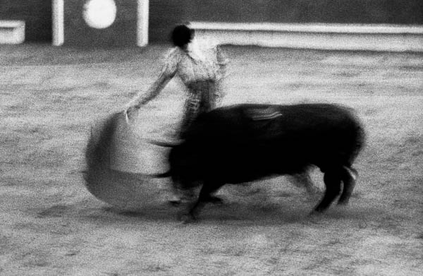

Seriously though, half frame is the easiest way to increase grain. I reckon a half frame neg is about the same-ish grainwise as the older films, but you take a bit of a hit on tonality. This is from a Oly Pen FT with Fomapan 400 in Rodinal and printed. It isn't really even that grainy in half frame.

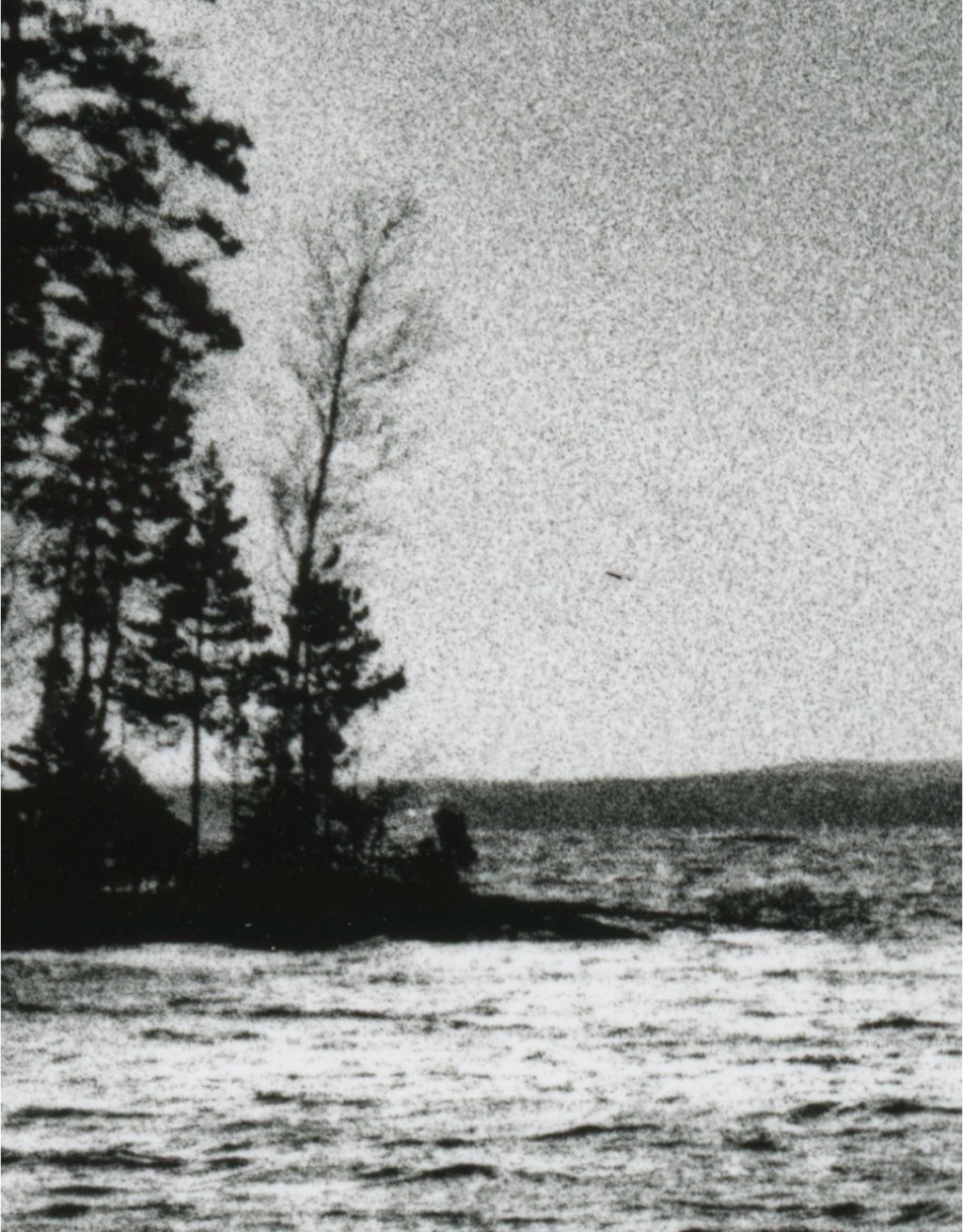

I took some bird photos on Arista 400 in 35mm with an 85mm lens. It wasn't nearly long enough so if I cropped my scans to just the bird it was very grainy. I used Rodinal. I don't have the scans with me right now.

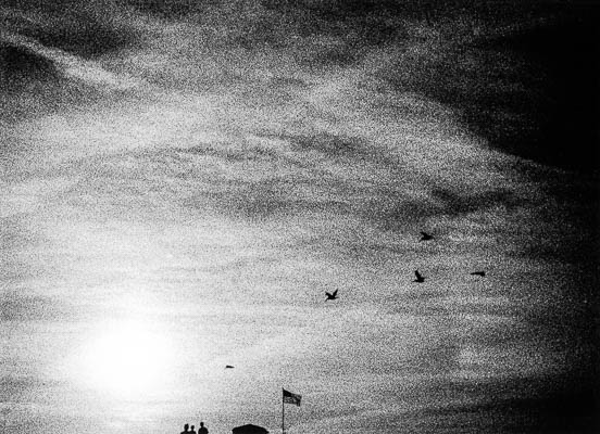

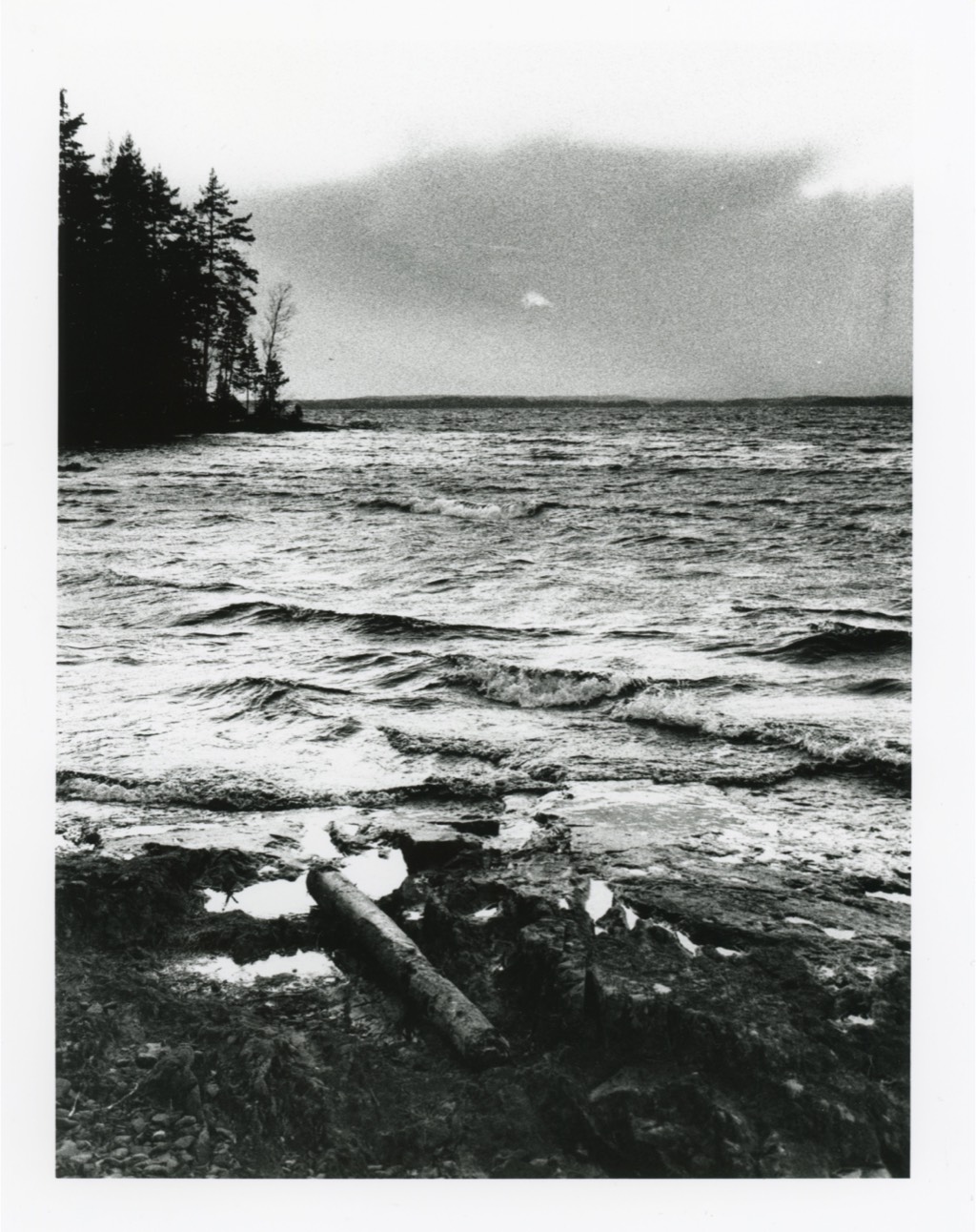

I have the opposite experiences.. This is HP5 developed in paper developer and printed in darkroom, the grain you see here is very real (18x24cm print scanned at 600dpi) :

radiant, that looks great ! what kind of print developer was it ? and what temperature did you use it ? I like grain.
Thanks! That is Ilford paper developer at 20degC.
The strange is that sometimes the frames get really really nasty (in a good way) with paper developer but then I have almost "perfect" print made from same batch (AND underexposed) without excessive grain. It feels like it has its own mind.
I think it might depend on the paper developer.
I used a bottle of champion (I think?) Universal print and paper developer and it gave me sharp clean negatives (which wasn't what I was wanting).
Radiant's example using a dedicated multigrade developer is very different from my experience with a universal developer.
