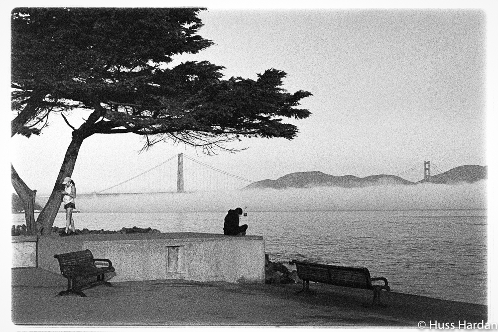

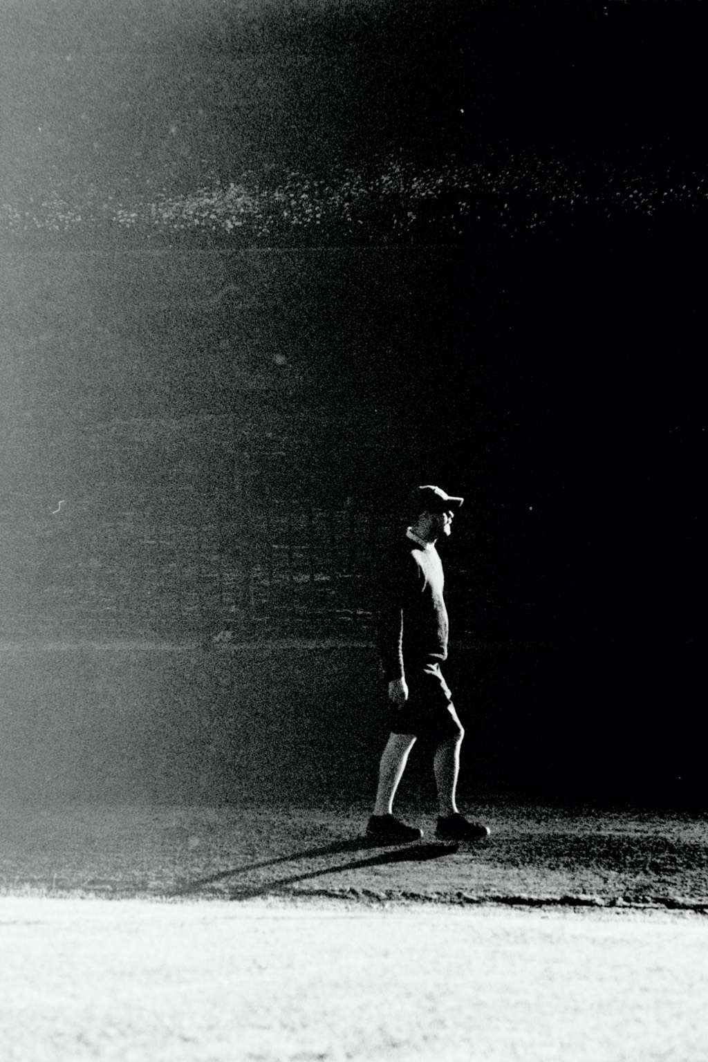

Not foma 400. There is grain but normal, even in rodinal 1:25.
Tmz is excellent. Even when rated at iso 100 and pulled development it will have big grain.
no, agitation has no effect on grain.

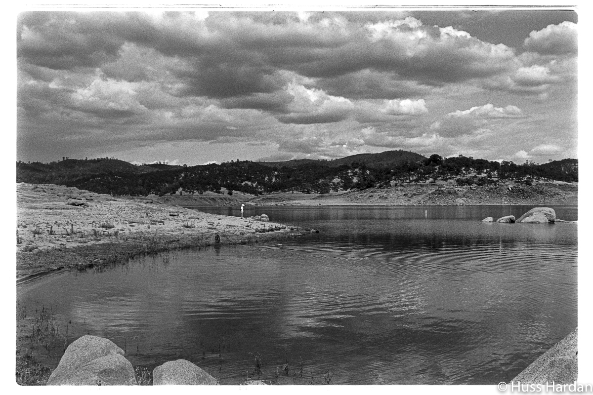

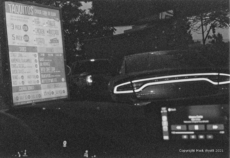

Kentmere 400 in Cinestill DF96 Monobath, 75 degrees for 4 minutes. No tricks needed.
wow. monobath = grain!

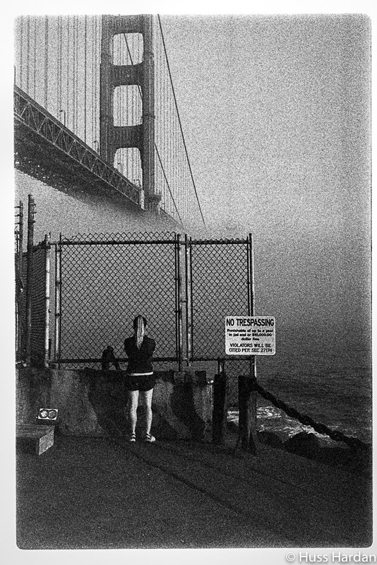

Has little to do with monobath, these examples are quite typical for Kodak TMZ 3200. In fact, shooting TMZ at 3200, is always underexposing, if you want it cleaner, ~1200 Asa is the max.
Are these prints or scans? Please remember that scanning typically translates grain to digital noise and bumping up the contrast post with computer also makes the noise very prominent.

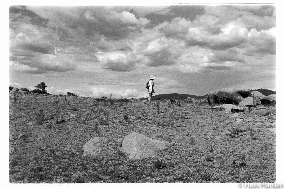

I scan with a digicam, and it does not add any grain. The results I attached above have grain because of the film and development process used. Below is an example I recently posted in the DF96 thread shot on Acros II at box speed, developed normally in DF96. No grain.
With normal developers you push process by adding time. With monobath developers you push process by increasing the temperature as monobaths develop and fix at the same time. That is what increases the grain size.

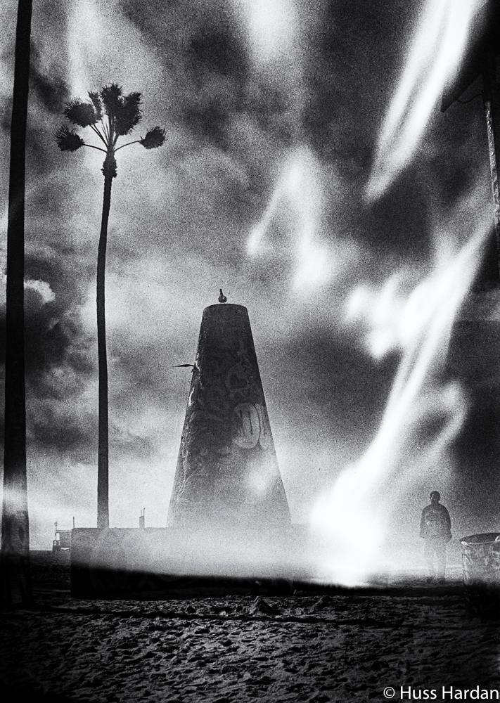

How do you know that it doesn’t add any grain? So far, all my darkroom prints consistently show less grain than any print from a DSLR scan.

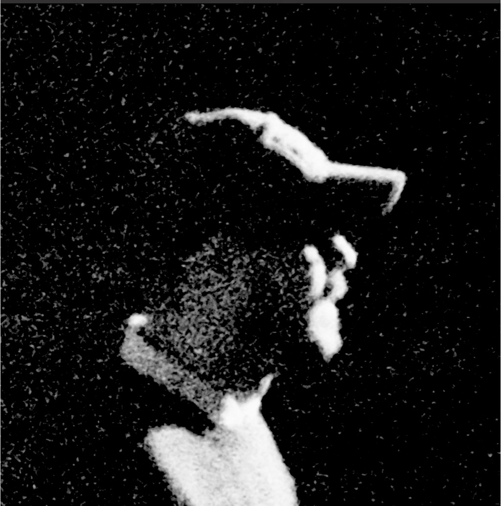

Here is digitized version (Fuji XT-3, 50mm enlarger lens). It is getting there but no grain separation.
@Huss can you describe your setup how you digitized those previous examples?
And it is also important to realize that if you see grain in 1200 pixel wide digital image, it cannot be grain. If it would be, I would be enormous on film + paper print. That isn't just possible. What we see is digital artefact. Yes the density of the digital artefact is determined by grain density.
I still argue that most of the time what we see descibred as "grain" in scanned / digitized negative is actually mostly noise. Grain is so small that you need over 5000 pixel wide image to even really see it. Here is the full frame 1024 pixels wide to give the scale how small things we are talking here:
