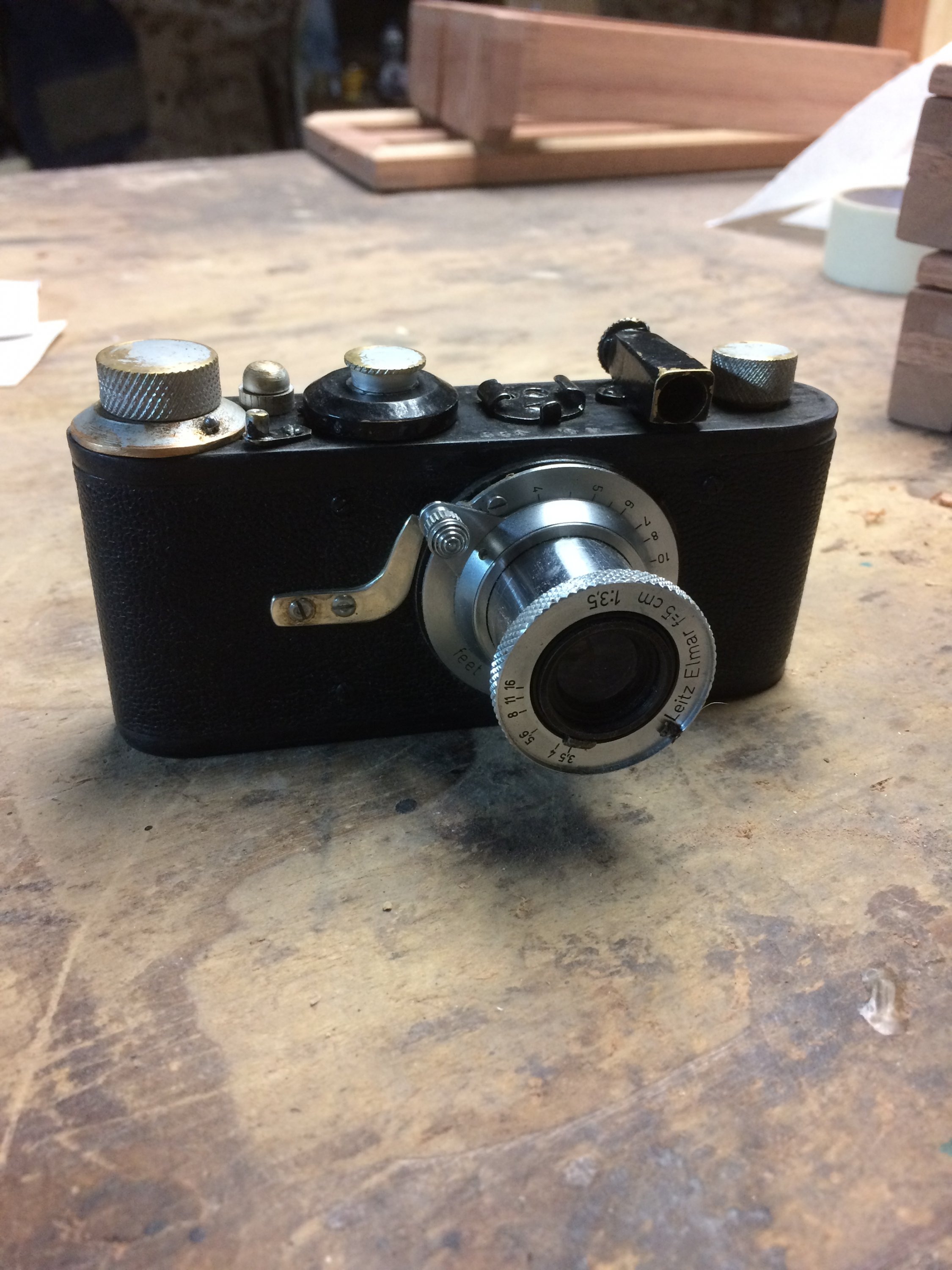

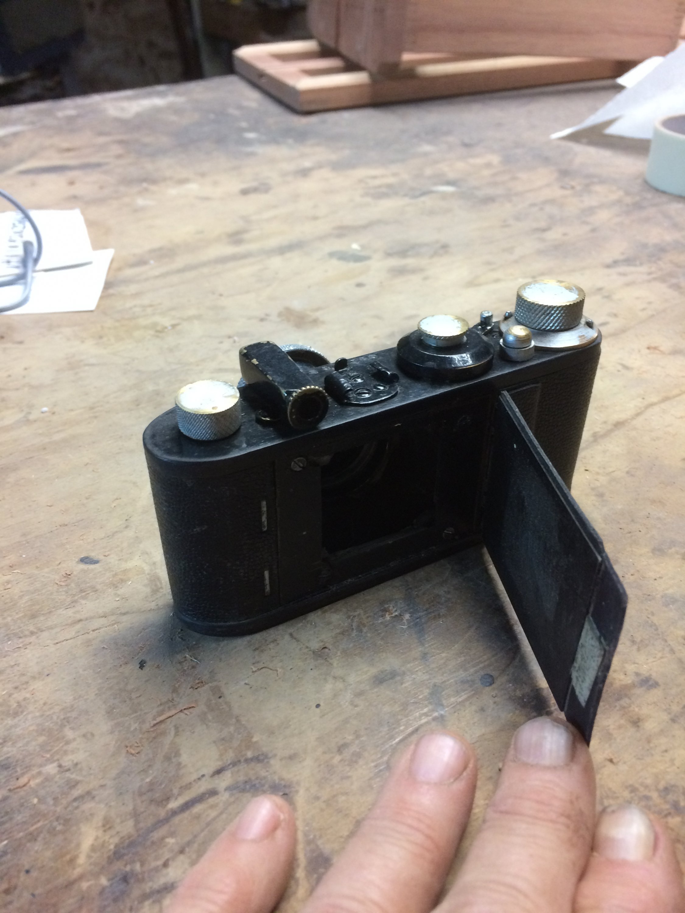

Use a 35mm camera specifically designed for Wet Plate!!
