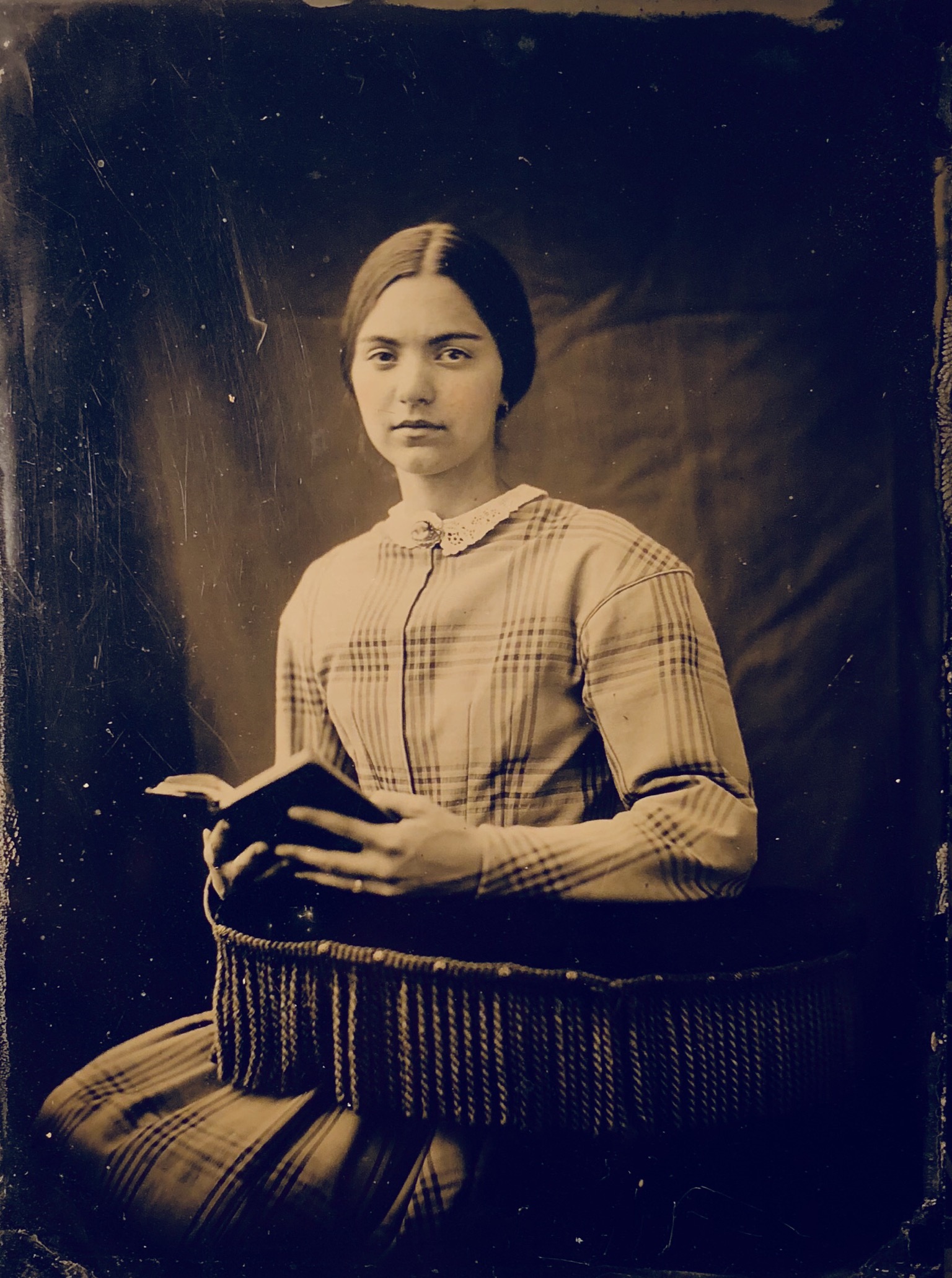

Well.....Here’s a black glass Ambrotype. Just How you going to do that with film, modern camera and modern lens? :smile:
Really long exposure time (to get some movements to the models face), large aperture as possible, overexposing film 4 stops (to get blown highlights), printing in high contrast through a glass plated (scratched, smudged whatever from the side where it touches the paper). Full blown sepia toning.
Wish I had time to try this. I already shot some Foma 100 thru blue filter to get some ortho style emulation but that wasn't enough :smile:
I do wet plate work, and I can't imagine any combination of film/equipment that will come close to how collodion photography looks. There is nothing like a well made Ambrotype.
........as John Coffer said, “Ya gotta git yerself a New York lens”. There is pure magic in a C C Harrison or Holmes Booth and Haydens Daguerreotype lens.
