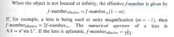

The diffraction limit is determined by the cone angle of the light - hence the f/number at the film side.
If you go as far as 1:1, the f/number at each side is now twice what it says on the lens scale.
Hence if you shoot at 1:1 at a marked f/number of f/16, it is like shooting at f/32 in terms of resolution and detail contrast ( MTF ) .
For a mag less than 1:1 then the bellows factor times the f/number gives you the effective f/number as mentioned by xkaes and ic-racer above.

Per the book written by members of the faculty of the Rochester Institute of Photography (1990): Basic Photographic Materials and Processes, p 35-36
"...it is necessary to make an exposure adjustement when the image distance is larger than one focal length -- that is, when the camera is focused on objects that are closer than infinity....There are various methods for making the adjustment when photographic objects withing the 10-focal-length range. One methid is to calculate the effective f-number, and then determine the exposure time for that number rather than for the f-number marked on the lens. The effective f-number is found by multiplying the marked f/number by the ratio of the image distance to the focal length, or​
Effective f-number = f-fumber x (Image distance/focal length)​

My point was that once you operate at finite distance, you now have two focal distances, 'u' and 'v' , each of which has its own f/number.
In the simple example of 1:1 , both 'u' and 'v' are now 100mm.
If your lens is still set at f/2, then the aperture is 25mm, and the f/number at each side if f/4.
This goes with the reduction in brightness, as you point out.
The lens conjugate equation ( above ) can help give you the f/number at each side, at any other magnification.

I hadn't really considered this question very deeply. To me it seems natural that because you can always calculate an NA for the image side and object side, then it follows you have an image f/number and an object f/number.
These are standard quantities provided in the first-order listing of a lens ( used at non-infinity case ) in optical design software.
My feeling ( and that of Goodman, below ) is that the normal f/number given on a lens is only the infinity case - which is not the unique definition.
This link here shows how messy the definition of f/number can get - and is not an ideal answer to your question . However you can see he talks on page 1 already about "For an object not at infinity, by analogy, the F-number is often taken to be the half of the inverse of the tangent of the marginal ray angle." so he has no problem with the concept.
I did check Welford's book for how he tackles the subject, but it was annoyingly lacking any discussion of f/number.
I'll see if i can dig out a better commentary on the subject in the next day or two while I'm 'on the job'.
The f-number is directly related to the taper ratio (opening angle) of a cone of light whose base is the circular-ish aperture and whose apex is a point on the film. There is another cone of light from a point on the subject to the aperture, and that beam also has an f-number, it's just less common to speak about it.
The effective f-number of the beam on the image side is a real thing, not simply a concept, it's the actual ratio of the beam. This is much easier to explain with a picture, so I drew one. I drew this for a 50mm f/2 lens at magnification 1:2, so the asymmetry between object and image planes would be clear. On the right hand side of this drawing, there is a beam, a cone of light onto the film that is 75mm high and has a base of 25mm (the lens aperture). So it is an f/3 beam.

It's surprising how little is written in the main textbooks about f-number. It supports what Goodman says above.
Today I checked Longhurst's book, then Warren Smith's 'Modern Optical Engineering' then Kingslake's 'Lens Design Fundamentals'.
Longhurst only gives the infinity definition of f-number in a section about the Lagrange invariant.
Warren Smith says that f-number is 'typically used for the infinity case whereas NA is more useful for finite conjugates'
Kingslake has the comment copied below, which is the way I have always considered it over the years :
thx to both for the contribution of information about f-number 'in front' vs 'behind'
I have to wonder, that when 1:1 is the object size in front of the lens and behind the lens, the distance to subject vs. distance to focal plane is IDENTICAL...2*FL, the total distance subject-to-focal plane = 4*FL
So in that case, it would seem that the computed f-number in front and behind the lens is the SAME, wouldn't ti?!
