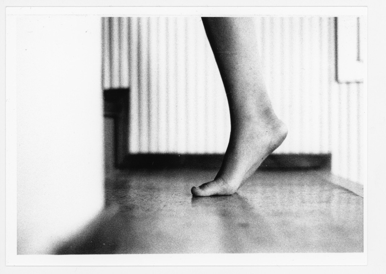

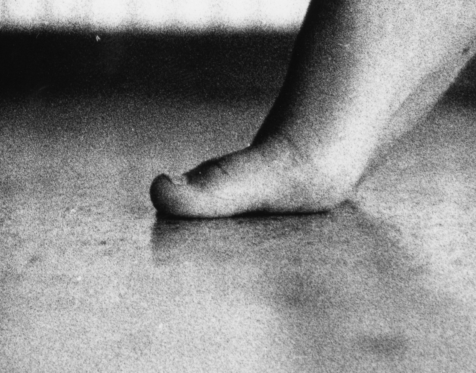

I shot two rolls of Fomapan 400 at ISO 160 and overdeveloped in Rodinal 1+25 for 7 minutes with 30 second agitation sequence.
No specific big grain, I have seen bigger in Delta 3200. But hey, the negatives are really dense compared to souping at Xtol. Similarly dense than Tmax 400 at Xtol. Just by looking on light table.
I have some digital versions of the negatives but I'm not going to post those here not to cause any allergic reactions :D
Here is one print from my tests.
Close up:
What do you think of the grain?
