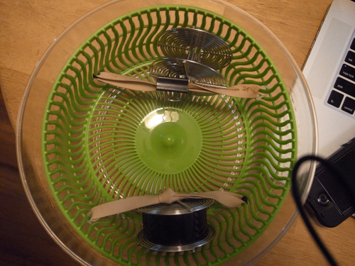

I found this method and never went back; after developing i take the reel and put it into a salad spinner and spin fast for 30 seconds...result: no water on any negative, so never a water spot!
Then i put the reel into a film dryer and its comes put 50 minutes later dry, clean, and dust free.

I like this creative solution, thanks for posting the picture, RP.
By film dryer, do you mean one of those large cabinets or?
