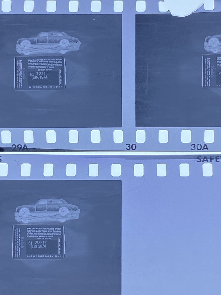

Top strip is the one that was in the van from yesterday morning until this morning, through a very hot day.
Bottom strip was in the darkroom.
Both exposures identical, made this morning. Strips developed together in stock D76.
I can't see any impact the heat had, except the strip that was in the car was more-tightly coiled when I put it on the reel.

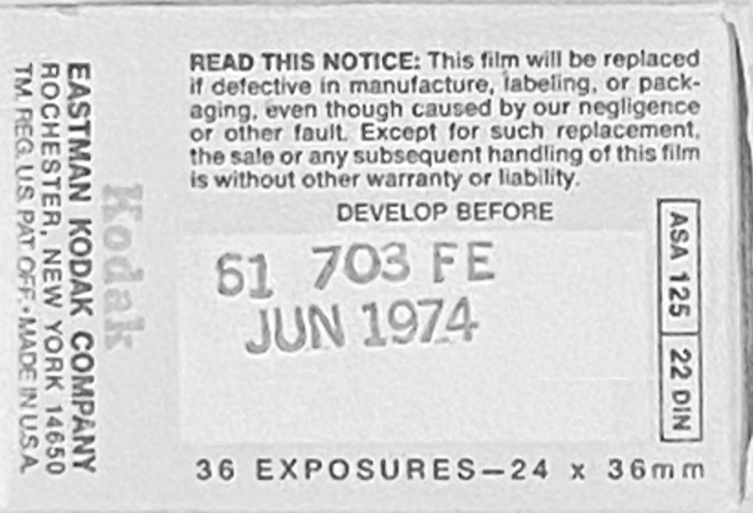

Second test complete. Two full days in the van. Partway through, I checked the temperature. It was 43 degrees at the cup holder and 49 degrees in the glove compartment - so I put the film in there.
Water spots on the film, since I didn't bother with photoflo. There's no real difference except the strip that was in the car might be slightly more dense. It
doesn't seem to be as visible on my phone photo as it is in reality. If so, though, it's not enough to make a significant difference.
The strip that was in the car is top.
The box from the strip in the car would undoubtedly look better as a scan, but you can see there's nothing really unusual-looking about it:
