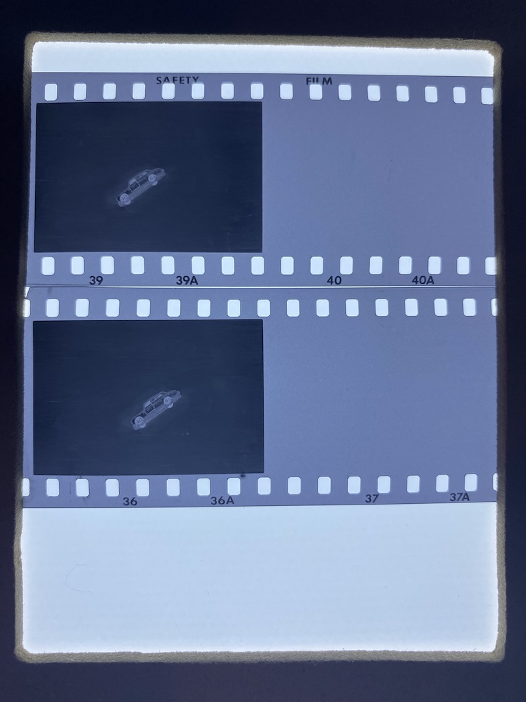

Top strip is the one that was in the van from yesterday morning until this morning, through a very hot day.
Bottom strip was in the darkroom.
Both exposures identical, made this morning. Strips developed together in stock D76.
I can't see any impact the heat had, except the strip that was in the car was more-tightly coiled when I put it on the reel.
I would not expect any change with only one day exposure to high heat.
Thanks for running the experiment. I'm not sure what happened to my film, whether it was heat or something else. As I mentioned above, I ran another roll of the same film through the same camera yesterday and developed it exactly the same way. As a sanity check, I first tested the developer to make sure it was still good and it was. The negatives look fine this time around. 🤷‍♂️
