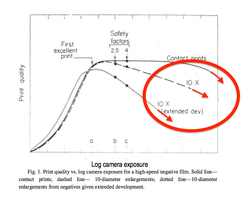

Just remember the more the negative is enlarged, the greater the image degredation from over-exposure.

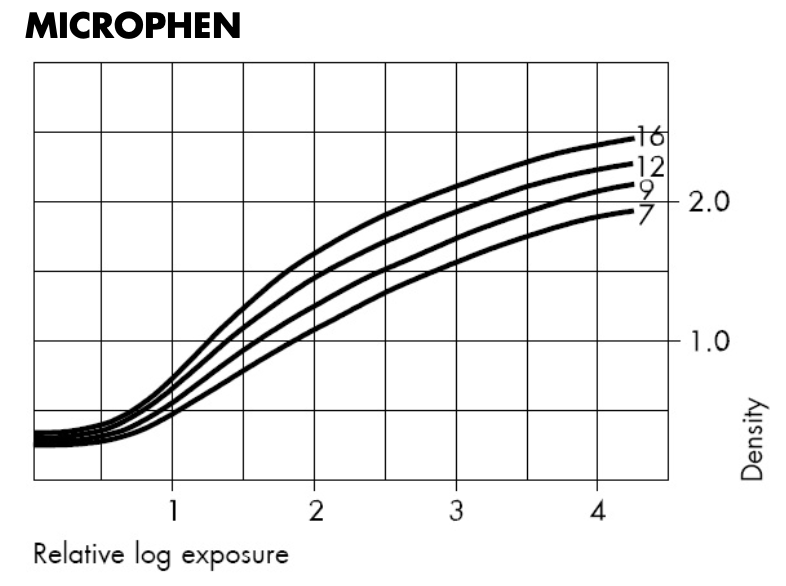

From a pictorial perspective, Delta 3200 was designed to be under exposed. Using it as an ISO 1000 film is an exercise of frustration: you get decent shadows and garbage mid-tones and highlights, or as Matt puts it: "low contrast". I am amazed by how frequently people gradually drop the advice like "aaaaactually if you bother to read the datasheet, you'll see it's an ISO 1000 film, so shoot it properly". Nope. Ilford designed it with a specific usage in mind: meter for ISO 3200, accept the crushed shadows (by design), but the midtones and highlights will be awesome for so little light. This is not a good film to over-expose, as its curve is designed for under-exposure.
Look at how nonlinear it is, and how suppressed the shadows (that's where the ISO rating comes from) are:
Moreover, Delta 3200 produces vastly different results with different developers. Xtol and ID-11 are very much a no-no for it, but Microphen and DD-X are great. I haven't tried others.
TLDR: Expose at EI 3200, develop in Microphen.
