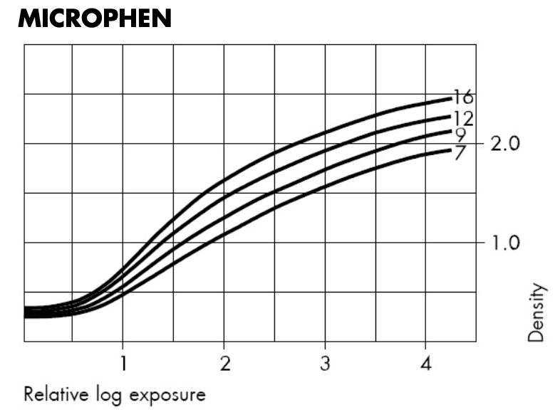

Look at how nonlinear it is, and how suppressed the shadows (that's where the ISO rating comes from) are:
Moreover, Delta 3200 produces vastly different results with different developers. Xtol and ID-11 are very much a no-no for it, but Microphen and DD-X are great. I haven't tried others.
TLDR: Expose at EI 3200, develop in Microphen.

The biggest difference between Xtol/ID-11 and Microphen/DD-X is the density range. The latter duo produces rich negatives with wider range of light values captured and higher overall contrast. That is what you get when using datasheet times. I tried cooking Delta 3200 in Xtol longer, sometimes a lot longer, and found it to be surprisingly resilient at building density.
If you are not getting incredibly similar negatives from Xtol/ DD-X/ ID-11/ Microphen at G-bar 0.62 (if they are exposed to normalise shadow speed differences), there is a very fundamental error somewhere in your process. They are incredibly close derivatives of each other - and I've used them all with Delta 3200, and you would probably have near impossible levels of difficulty picking them out from a double blind print comparison, no matter if they were scanned or darkroom printed. The sum total of the difference should be that for a given exposure, your shadow detail might improve a little with DD-X/ Xtol over ID-11, and maybe a little more again with Microphen - but this is where you need to be careful, because the differences in effect shrink towards unity at higher contrast indices/ G-bar - and as you pointed out upthread, Delta already has a steeper G-bar in the toe to begin with - i.e. you might find that reduced exposure given to satisfy your norms of Microphen/ DD-X's nominal shadow speed boost also need to be applied more universally (been there, got bitten by ID-11). The longer you process in these fairly solvent developers with films like Delta 3200, the more development inhibition agents you release from the emulsion, and the more inhibition effects you will get from certain developer characteristics - this enhances sharpness and holds down absolute highlight density (and Delta 3200 is really designed to do this strongly) - but if you overexpose a bit, you will make the inhibition components more easily released/ more effective - so you end up not just climbing on to the shoulder of the film, but further flattening the highlight gradient (and Xtol will do this more like Microphen and DD-X can than ID-11 is able to).
Never tried Rodinal with it
It has a different curve shape (essentially due to lack of solvency having a different effect on emulsion interaction) - don't expect speed, but the curve behaves some what more conventionally than the specific characteristics in more solvent developers. Most of the claims about exposure at nominal ISO rating are either because of people indexing their exposures in particular ways that effectively end up rating the film unintentionally correctly or because they are using very low/ no solvency developers (which might have inhibition effects under other circumstances (that are completely unrelated to any of the misleading stains/ dyes they might form), but Delta 3200 seems to demand quite specific characteristics of developers).

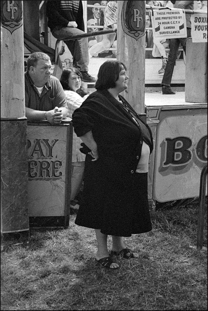

I really liked Delta 3200 rated at 3200 ISO and developed in the late-lamented Emofin. For disbelievers, here's a 35mm example, not very well scanned. It looks fine printed to 16x12 (ie 10x), a bit sharper and less grainy than it appears in this scan. The situation was a fairground after dark, and essentially zero light was reaching the lady's black dress from the camera side.
I've since had nothing good with other developers, but learned after a while that Delta 3200 doesn't keep well, so I had actually been using stale material. I must try again, but I think it would be a mistake to imagine that D3200 could be used as a general-purpose film, because it definitely needs careful handling to get pleasant results.
You sure got every bit of light out of that scene. That’s a great shot!
