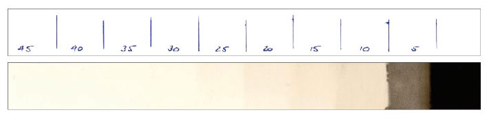

Here is the missing attachment:

Conduct a test to determine the optimum fixing time for any paper/fixer combination.
How do you test time for fixing paper????
Some fixers like Ilford Hypam, will recommend 1 time for 1+4 and another time for 1+9. If the time at 1+4 is too short, then use the 1+9 time. ...
Ilford says 1+4 is for film and 1+9 for paper. Ignore the paper recommendation and use it two-bath 1+4 for FB paper as well. This will give you fast and strong fixing, which removed all residual silver halide without giving the fixer a change to creep into the fibers. Washing will be a lot easier too this way, and fixer consumption is the same, because weak fixer dissolves less halide than strong fixer.
... How do you test time for fixing paper????
I posted the test result in post #32 already, but without some text, it wasn't worth much. In brief, fix a strip of undeveloped paper for 5, 10, 15, 20, 25, 30 and so on seconds. Rinse it off and try to develop it in normal paper developer. Any residual halide will be exposed (because you don't do the test in the dark) and developed. The first clean strip indicated proper fixing. Double or triple that time for safety (you are not always using fresh fixer) and you'll get to a minimum fixing time.
Alternatively, you can conduct the test with selenium or sulfide toners instead of developer, but I find the developer to be more telling than toners. In any case, make sure not to fix for less than 1 minute regardless of what the test result is, due to agitation and handling reasons.
