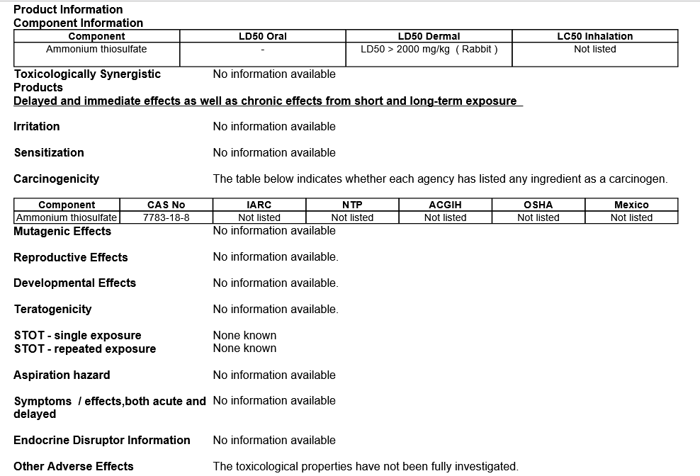

Yes, yes, cite the msds.
From the msds for water:
More relevant, the from the msds of ammonium thiosulfate:
Strange that there's no real toxicological data on the primary component of rapid fixer.

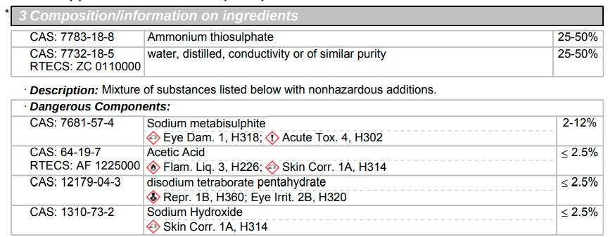

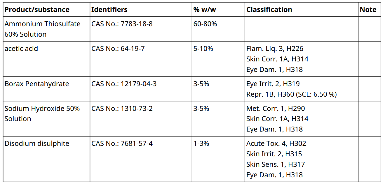

So, how about this for information. The msds you cite is for Kodak rapid fixer. I use a different rapid fixer - one that uses different ingredients (same main ingredient).
Here's the table from the Kodak msds:
The hazardous materials are vinegar, lye, borax, and disodium disulphite - all in much lower quantities than the ammonium thiosulfate (which we know they haven't bothered to test). What happens when you mix vinegar with borax and lye?
Anyway, I don't use vinegar or lye in my fixer. It isn't described by this msds.
Furthermore, you can make a fixer from just sodium thiosulfate in water. Not toxic. Not hazardous.
It isn't, actually. But it has the same ingredients.
