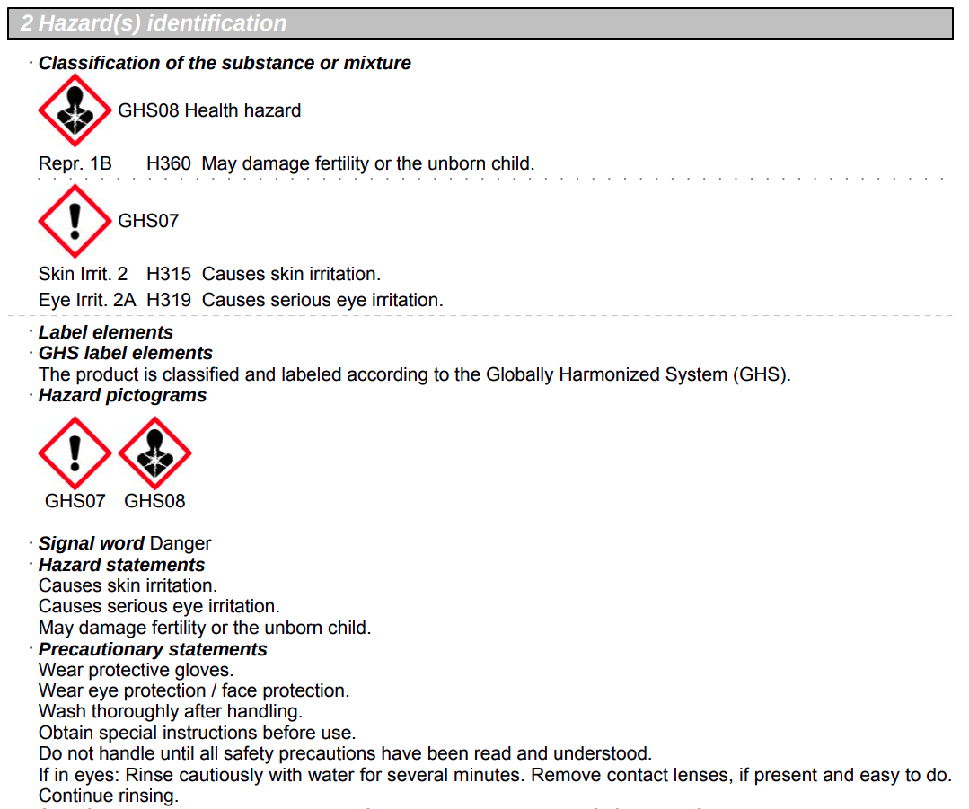

Fixer is not hazardous. ... Caution does not take the place of being properly informed.
I doubt that you'd be willing to drink it or wash your face with it. More importantly, I do not think that blanket statements like "fixer is not hazardous" are helpful --- at least Matt's version ("I wouldn't even call it hazardous") conveys that this is his personal judgement call, as is his comparison to household products.
Can we agree that being "properly informed" would include reading the MSDS? Below I have copied a portion of the MSDS of one commercial fixer. You are of course free to ignore what it says, but please don't ding me for using the terminology or precautions that are more or less in line with the MSDS.
GregY
Apr 12, 2005
3,981
Alberta
Well, to state the obvious, "similar" is not "the same". 🙂
Don't forget that, apart tone, the developer is another level of contrast control of your black and white print (i.e., it doesn't end with the contrast filters). D-72 at a 1:1 dilution gives me a bit more contrast than Ansco 130 at the same dilution, and I prefer the depth of the blacks with Ansco 130. I think the glycin in Ansco 130 has something to do with that, but I'm not sure.
I haven't tried D-72 at a 1:3 or 1:4 dilution, so I can't say if it would get me closer to Ansco 130.
Of course, this all also depends on the paper. Fomabrom Variant 112 looks absolutely glorious in Ansco 130, to a point where it doesn't look like a matt surface. I have to work a bit harder under the enlarger to find the right levels of contrast to get Ilford's MGFB paper, glossy and matt, to sing as well in Ansco 130.
The difference is even more striking when using warmtone papers.
IME Ilford warmtone FB is the exception (among the Ilford papers). I consider it in a class by itself (from Ilford). Having lost Forte, I settled on Foma's superb papers.....but even they are harder to get these days.
MattKing
Apr 24, 2005
55,062
Delta, BC Canada
Always consider MDS's (as apparently they are now known) in context.
They apply in particular to the contents of the original bottle - at the concentration in that bottle - and the concerns they address are often affected by the dilution we do in order to use working strength solutions.
And they are designed to warn about the sort of intensive, repeated, extended use that someone using the contents in a commercial environment needs to be concerned with.
I always recommend exercising reasonable care, and the nature of that care requires more diligence when, for example, one is mixing up concentrate and water to make working strength solution than when one is fixing a dozen prints in a tray full of 1+9 diluted fixer.
The MDS is designed to cover the risks encountered in all sorts of environments - including intensive commercial environments. If I was running a commercial lab that had my employees adjacent for eight hours a day to a high volume print developing line, they would need to be wearing a lot more protective gear than someone needs if they are standing next to a tray of diluted fixer for a couple of hours at a time.
I've worked in commercial environments too, and I have a reasonable understanding of the differences.
