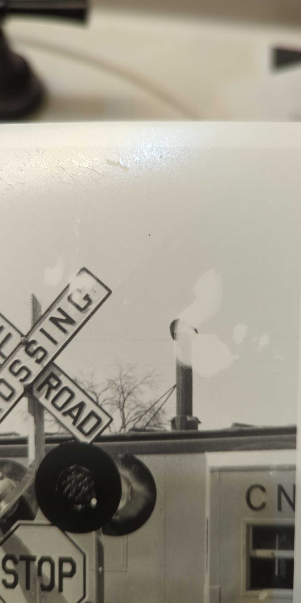

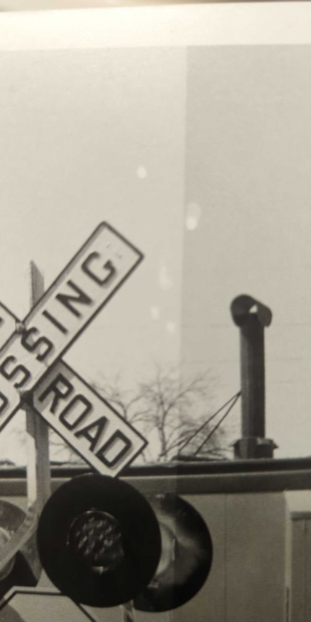

Developer doesn’t become exhausted through oxidation in 5 hours.
Do you have any guesses as to what I might have done wrong? I don't understand how I started out getting fairly nice blacks at the start of the session and ended up only getting wimpy blacks at the end.
Those larger blemishes: looks to me like you’ve splashed stop bath or something onto the print before development. Go gently with the rocking!
Perhaps my gloves were wet from a previous print? If I touched the emulsion with a glove that had residual stop bath, or even worse, fixer, that could look like what I saw.
This is very personal, but I don't use gloves in the darkroom with trays, it is very difficult to keep them dry and you will contaminate the developer.

I intentionally avoided referring to the phrase "factorial" development when I made my earlier post, because while I recommend it to the experienced, I thought it a bit early in @dcy 's learning curve to bring it up.

Yeah. I rock the developer tray constantly and I can see the liquid whooshing back and forth across the print. ---- Looking again at the prints (below), they don't really look like bubbles, but more like liquid drops of non-development.
My thinking was that the developer became oxidized mostly from sitting in the tray for a few hours, not from the number of prints. I only did like eight 5x7 prints. The time between the first print and the last print was just over 5 hours, largely doe to a long break I had to take in between.
Can you rule out the cross-contamination of fixer drops on paper?
For example, after seeing a test strip in the fix, you’ll turn the white light off and reach for a new sheet to place on the easel.
What strategy do you follow to ensure your hands are clean and dry?
I have running water and wear gloves. I rinse the gloves and dry on handkerchief like cloths. I check between fingers and they’re not always totally dry.
Yes. Wet gloves can do this. Dry off between fingers.
I use gloves but replace them often and try to keep one dry.
I cannot. In fact, thinking back to the session, I think this is the leading hypothesis.
I didn't think to specifically rinse my hands. I used different tongs to transfer the paper from tray to tray until it got to the final rinse. For the final rinse, I didn't have a full size tray, just a small shallow one that I kept over the sink, so I dipped my hands in the tray to move the paper back and forth with my fingers. I figured it's just water so it doesn't matter, so I just lightly patted my hands dry with a towel and then went to grab the next sheet.

And with respect to gloves, I recommend nitrile gloves and tongs. The gloves are easier than skin to rinse off.
Yeah. I use nitrile. When I started with film I got some "lint free" gloves, and that was a lie, so I switched to nitrile.
Do you not use tongs? Your hands (gloves if you like to wear them) don’t need to touch any of the chemicals. I know you see video of both ‘influencers’ and master printers dabbling in the trays with bare hands, but it isn’t necessary, and exposes you to potential dermatitis (that’s why you are wearing gloves, I imagine). Fixer, especially, is difficult to wash off to the extent that it will not affect your next print.
There will be lots of replies here from folk who like dabbling, so you must make your own decision. FWIW, I don’t wear gloves except when washing trays, mixing powder chemicals or handling nasty concentrates like sulfuric acid or selenium toner. During printing, my hands are never wet with anything other than water, and they are always dry (towel) before I touch a negative or a new sheet of printing paper.
The Paterson tongs are excellent, btw, and because they are coloured you can dedicate them to specific baths. Likewise the trays - label them dev, stop and fix, and keep them that way.
I do.
Furthermore, I follow exactly the process as @Craig described it, modulo unintentional errors (of which, there might have been a few), and I did put my fingers in the final wash because I reasoned that at that point it's just water ---- I've since switched to using tongs for the final wash too.
I am going to assume that "you" in that sentence is the "generic you" and doesn't refer to me specifically. I do not know what influencers you're talking about. I have never seen a YT video where people intentionally dipped their bare hands into caustic chemicals. I do not follow any YT channel that I think a typical viewer would consider an "influencer", unless you adopt a definition where any and all YT channels are influencers.
I know many photographers don't do it, but wearing nitrile gloves or similar PPE is always good practice when handling caustic chemicals.
