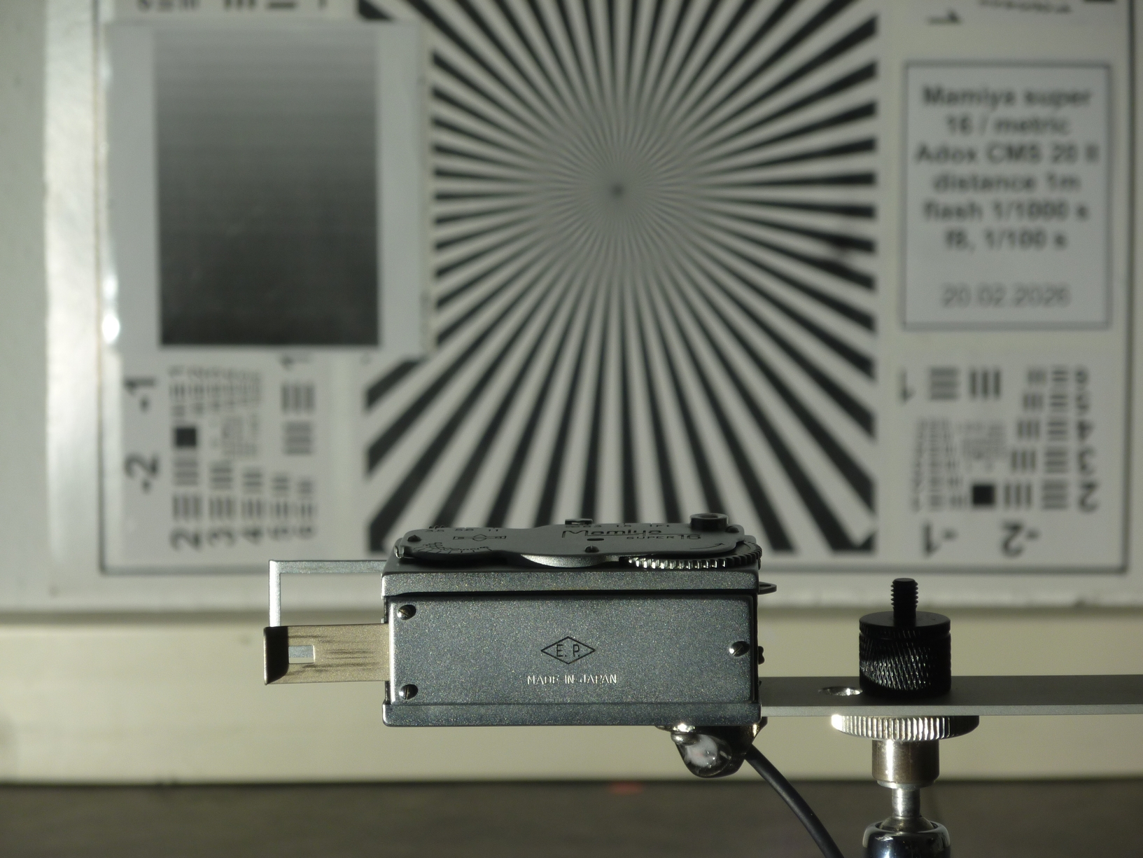

It wouldn't leave me alone. My comparison of the Minox A, Mamiya Super 16, and Edixa 16 also focused on the lenses. Unfortunately, I had to use estimated resolution values because no published values were available (except my own for the Minox A).
Now I've taken the restoration of a Mamiya as an opportunity to measure its lens resolution and, of course, that of the Edixa as well. Since I used the same test procedure for all three cameras, the results can be easily compared.
The surprise: Minox does not fare best in practice. Here is my report:

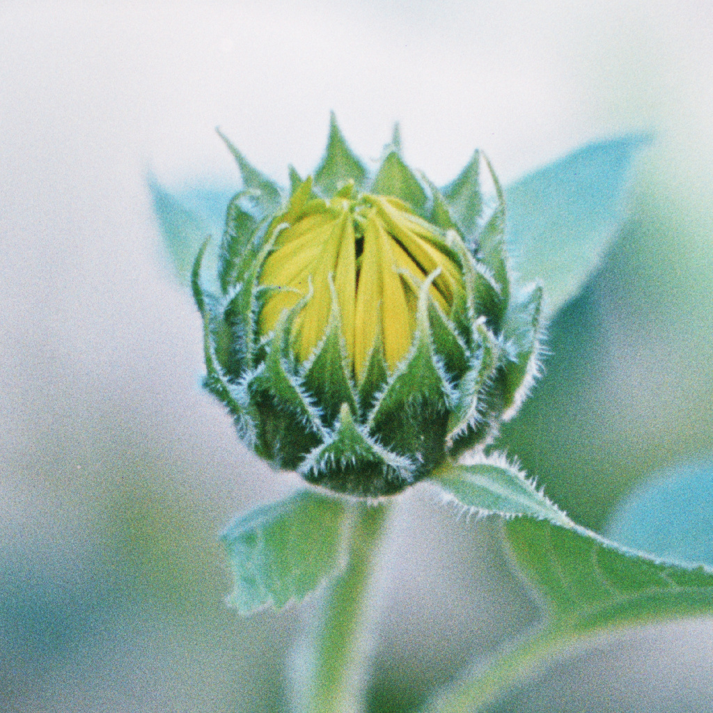

I've taken the middle-ground of using half-frame and cropping when necessary. This is a 6x6 millimeter crop from the Olympus Pen on Aerocolor that I felt held good detail. Probably could pull more out of it if I used more extension tubing to digitize.

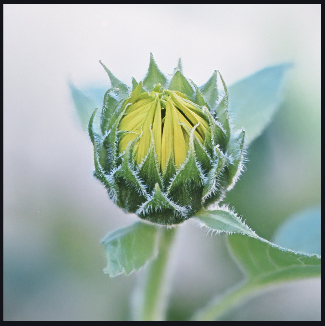

One should also consider what can be achieved today with digital post-processing of small formats. I took the liberty of editing your photo. Keep in mind that it is a smaller negative than Minox (6x6mm):
In all honesty, I would not consider that an improvement. Yes, the grain is gone. So is the acutance. The fine details are all smeared out. This is what used to be possible also in e.g. the Epson scanning software and other software offering noise reduction around 25 years ago, so it's not so much a demo of what is possible 'today'.
Of course today we have AI-assisted uprezzing tools that are supposed to help with scaling up images while retaining detail rendering. I have yet to see a single compelling example where this really works. At best, they keep upscaling artifacts limited, but there's never a gain in actual detail. Of course, a gain in actual detail is not to be expected, at lost not with fidelity to the original scene. However, I think it's something we can expect very soon, if not present already, with basically interpolated 'detail' that makes the 'made up' detail look crisp even if it's not actually real. But as said, the examples I see so far 'in the wild' don't look much better than just upscaling in e.g. GIMP. The example shown above of the bud also shows significant problems in how e.g. the edges of the folded petals render; personally I find this severely objectionable and therefore not an improvement (quite the contrary) to the original file.
Btw, I'd embrace these smaller format film/analog cameras and images for what they are instead of trying to make them into something they aren't. If you want reasonable digital image quality from a small package, just use a smartphone.
Yes, I appreciate the idea, but I do like seeing grain and dislike the "non-organic" for lack of a better term look of digital sharpening and upscaling. Most people sharpen their photos at least a tiny bit, I don't sharpen mine at all.

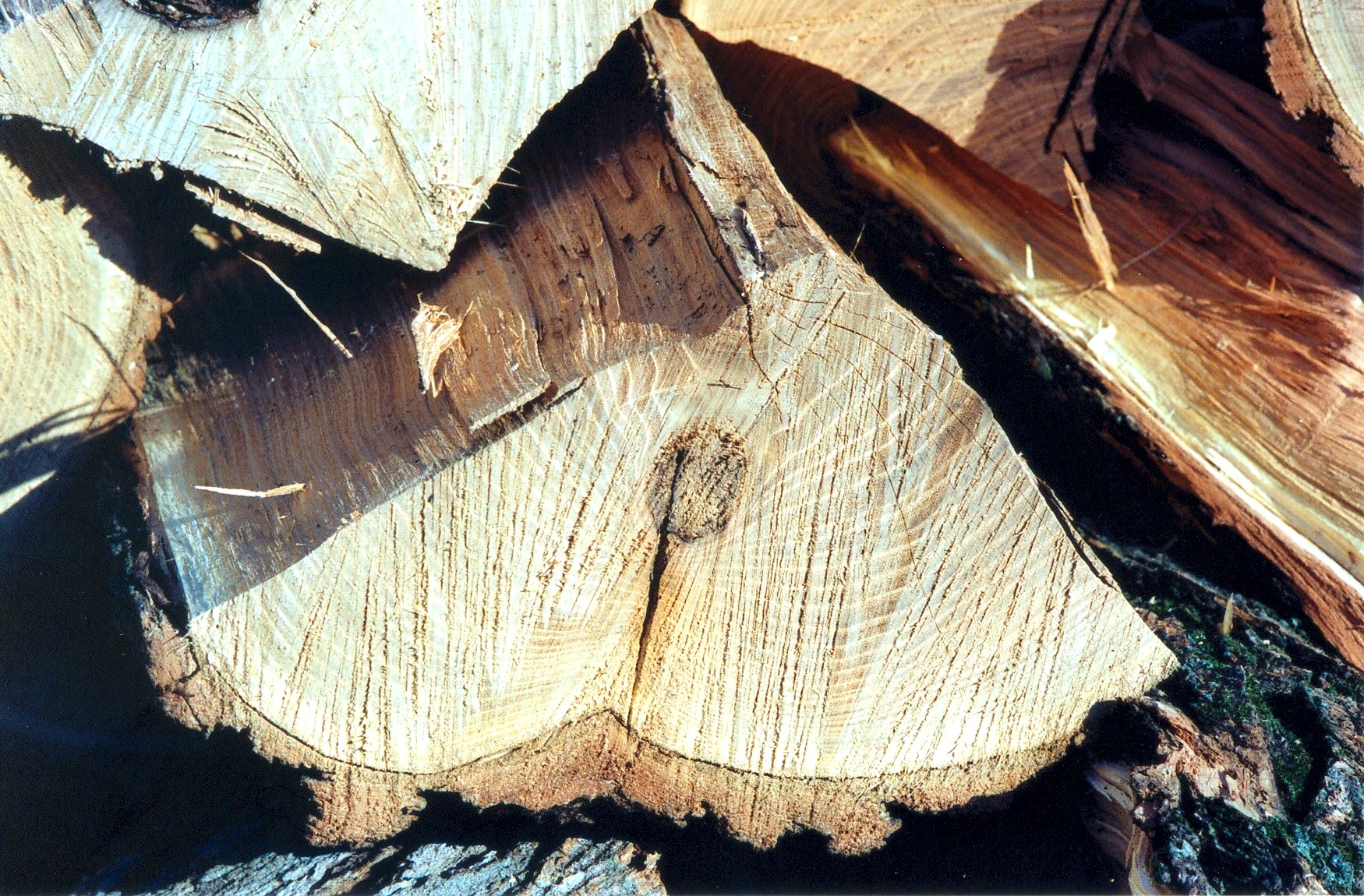

So excuse me if the only thing I can bring to this discussion is this... Here's the sharpest, finest-grain image that ever came out of my Minox cameras in decades of shooting:
This was back in 2008, a home-load of either Kodak Supra 100 or Fuji Reala 100 (probably the Reala, given the blue cast in places) in a Minox B, processed/printed by Minox Processing Labs as a roughly 3-1/2 x 5 bordered print. This is only a 300dpi scan... but it's enough to show that this is crazy sharp and detailed for a Minox pic!
And there are lots of Minox galleries on line that are equally impressive.

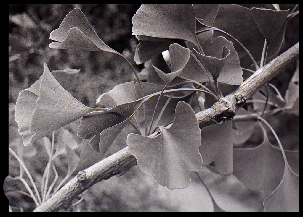

& the example
Minox IIIs, Spur 50 ISO, digitised with Sony A900
