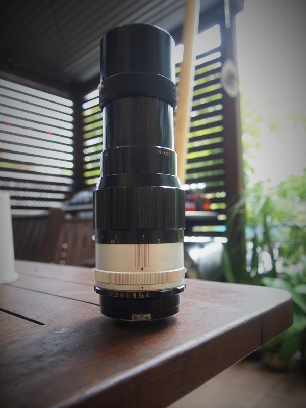

Just took a few photos from the front porch using digital camera, overcast.
