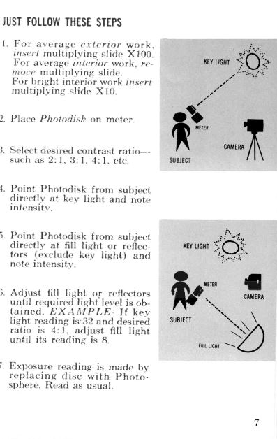

Some early meters referred to measuring light ratios with the flat disk.
The flat disk was also provided for photography of flat art (drawings, charcoal etchings).

The flat disk was provided for photograpy of flat art (drawings, charcoal etchings)
Copy work is certainly one reason for the photodisk cover, but I don't think that's accurate. My ancient Norwood and modern Sekonic both describe its use for measuring contrast on a three dimensional subject by pointing at each of several light sources. A page from an original Norwood manual is shown just above your post.
