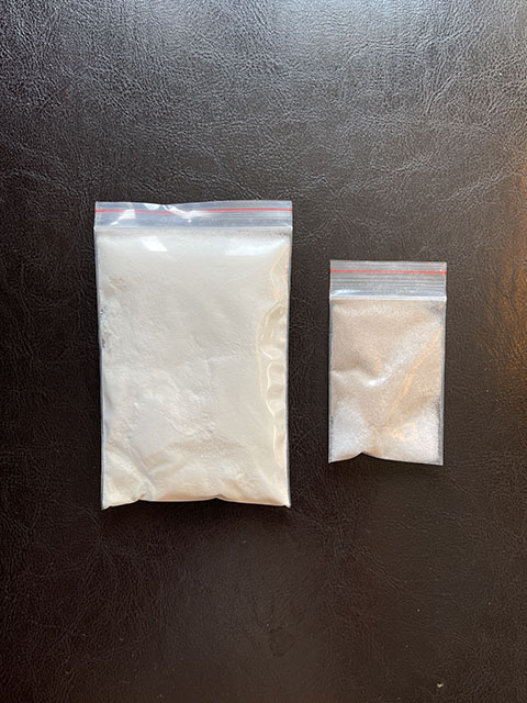

@dcy : you missed my post earlier actually,
I did this solution based on an advice above.
edit: i could answer all of your questions but no need any more as @koraks has stated all. Thank you.
as promised, here's the feedback:
now; after 10 days, the packages still keep well in original condition,
i would say that this 2 packages solution works.
- A: sodium sulfite and borax
- B: developing agents which are metol and hidroquinone
There's no reason it wouldn't - it's exactly what Ilford has been doing for decades with ID11. However, when you mix D76 from bulk chemicals, you're supposed to add a pinch of sodium sulfite to the water before dissolving the metol. That is to remove oxygen from your water to prevent that oxygen from oxidizing your metol. So, if when you dissolve your small packet the water turns a bit brown, that's the metol oxidizing. I don't know what Ilford does to prevent that - there could be some small amount of something else in their A packet to scavenge oxygen (small enough to not need to be listed on the msds, which only lists metol and hydroquinone).
kiemchacsu
Sep 9, 2009
23
Thanks for confirmation, even though this seems quite obvious, it’s still took me few testings to find out that.
