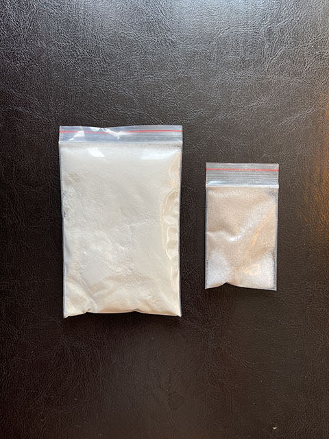

following your link to the post here, i decided to give the two-packages a try, as someone said:
- A: sodium sulfite and borax
- B: developing agents which are metol and hidroquinone
I will give feedback few days later, when observing the mixed ingredients.
@dcy : you missed my post earlier actually,
I did this solution based on an advice above.
edit: i could answer all of your questions but no need any more as @koraks has stated all. Thank you.
