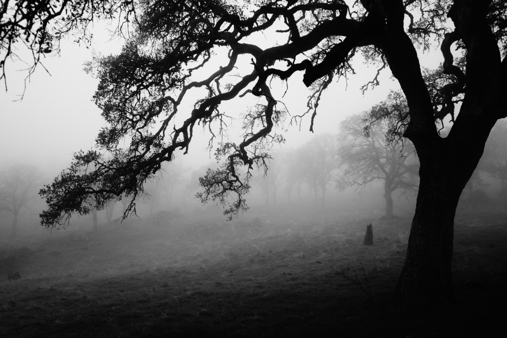

For these overcast days, what do you recommend for a high contrast 35mm film but not super grainy? Some grain sure.
Attached image is one of mine from my sony in "high contrast BW" mode. This is what I would like on film.

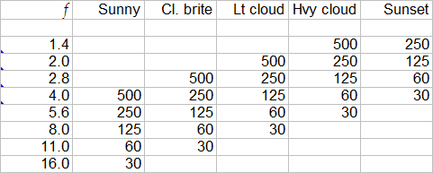

"Sunny-16" for an ASA 25 film shows it to be eminently hand-holdable:
Even an f4.0 lens is usable for hand-held outdoor shooting.

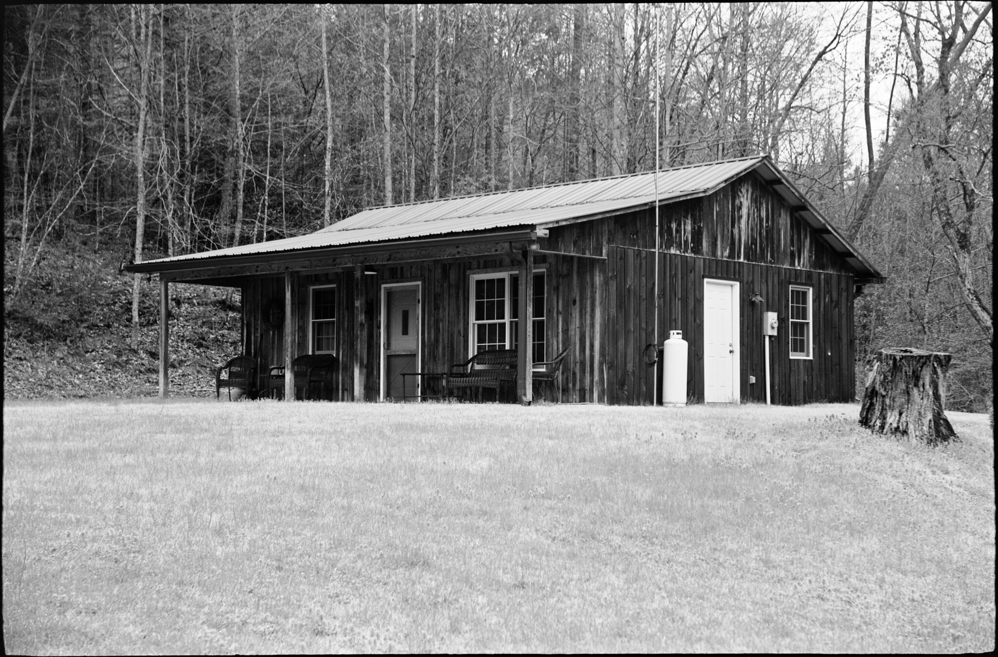

Here's an example of Scala 50 as negative in Rodinal in overcast conditions. Contrast could be further increased if needed. On my setup it takes up about double the histogram space as a similar shot on Tri-X 400.

That may be, but I've used the Kentmere Pan 100 enough to know that it's not sharper than TMX, nor does it have better acutance. In fact, it's got less acutance. Does this photo lack acutance??
Yes, that photo lacks acutance since it was developed in the solvent developer xtol. I see very weak to nonexistant mackie lines. Looks grainy for tmx 2 1/4.
