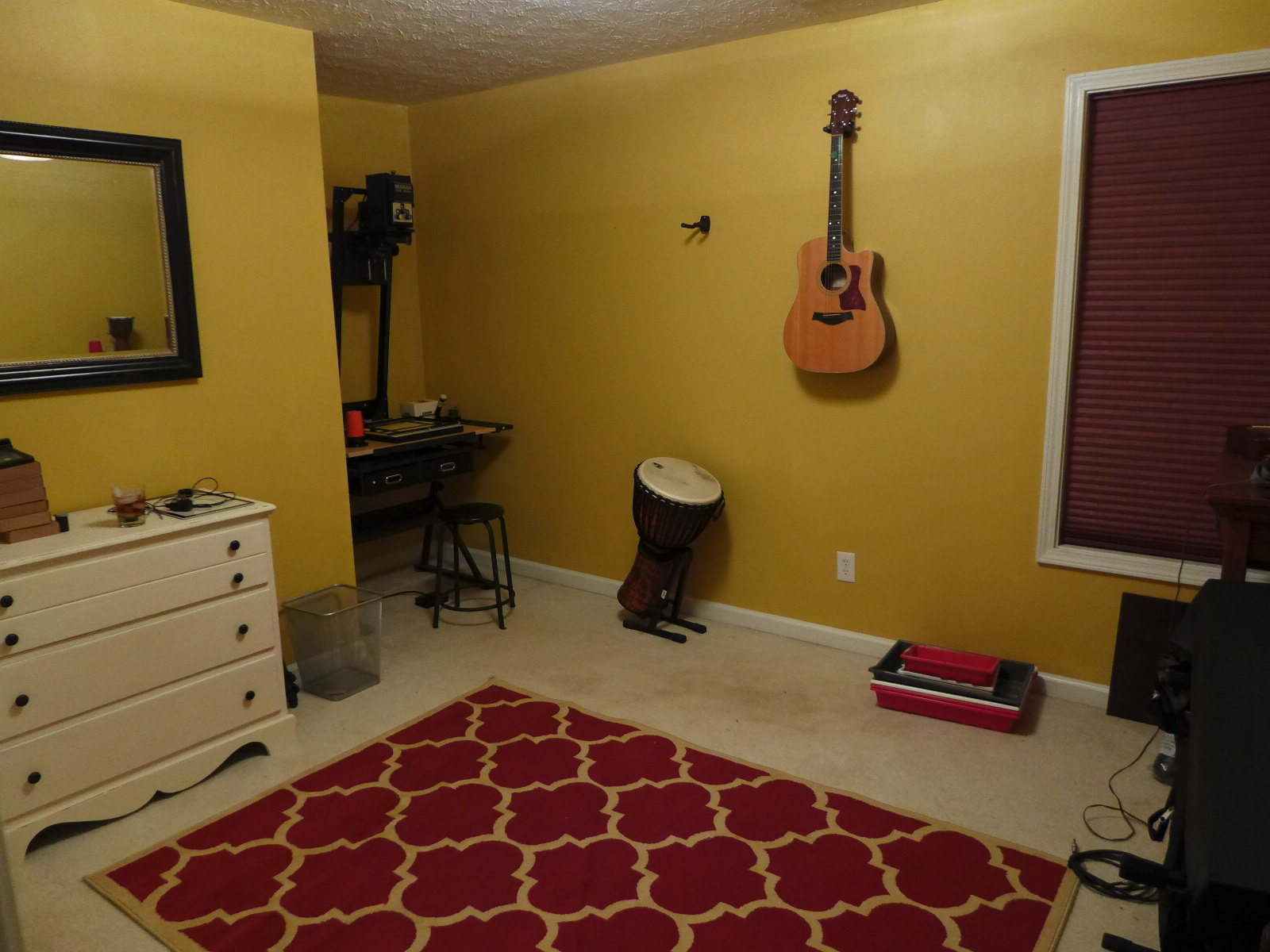

Thank you guys for these links. This thread is going to serve as a continual reference for me as I get set up. Below is a photo of the room, still disheveled and not nearly finished. The window will be blacked out and a sink and table will be on the wall to the right that is out of view. Any suggestions regarding layout are welcomed:
Deleted member 88956
If this is to be permanent darkroom... REMOVE CARPET. Anything else will make you disappointed in no time. For window make light trapped cover that you can still open/remove easily.

I agree that carpet is going to be tough. But if you can't remove, vacuum a lot. Maybe the day before a printing session. Get an air filter for the room. Hepa is good. Electrostatic is also.
I have had a wall to wall carpeted dry darkroom and the rug has never been a problem and gives some cushioning for the feet.
Buy a good grain focuser. Peak Grain Focusers are well worth the cost.
I have carpet in the spare-room-cum-darkroom, and it's fine. But I have a secret:
Don't use trays!
That's right, don't use trays. Their short walls make them too easy to spill.
Instead, use Sterlite (or equivalent) bins of suitable size. These are cheap and available everywhere in the US. The only way you can spill such a bin is if you're hopelessly uncoordinated or trip while carrying it.
