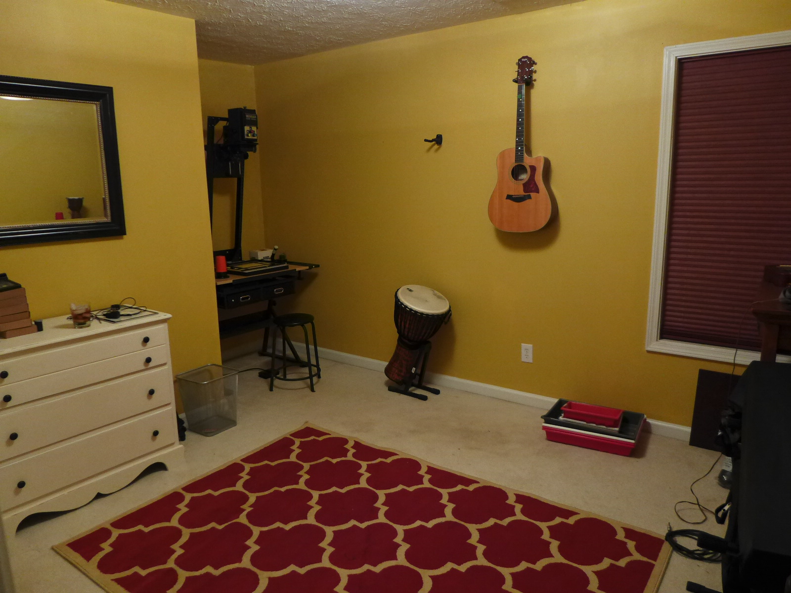

I use 11x14 trays nested in larger 12x16 trays. It really helps limit spillage, and it is actually easier to empty the trays at the end of the session.
It works with 8x10 trays nested in 11x14 trays as well.

Depending on how much work with fluids you do carpet might be an issue.
It would be the best to mix chemicals in bathroom or some other place with tiles or similar resistant floor.

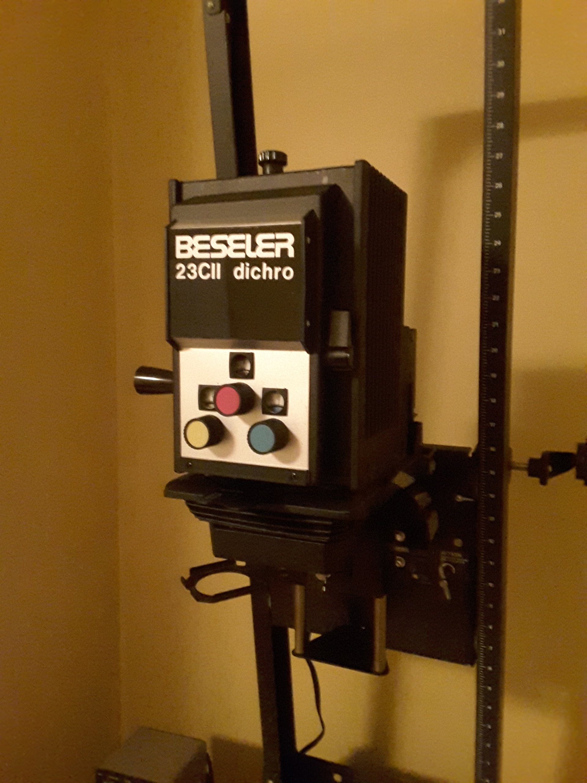

This one plugs straight in, and I don't see a fan switch. I also don't see any way to adjust the head for different sizes of film. How would that be done? There is a photo of the enlarger in this thread, if you can help.

I have carpet in the spare-room-cum-darkroom, and it's fine. But I have a secret:

In regards to your carpeted room, my last darkroom in Japan was a bedroom with tatami mats. I layed down a sheet of heavy plastic over top, followed by a large rug. I was in there every night for 10 years. It help up well. I did have a few spills in there, but when I stripped out my darkroom, the tatami was just like new...although the green had faded lol!
Just to let you guys know, I am worried about dust from the carpet, not spillage. The carpet is cheap and not in grest shape, anyway.
By an inexpensive carpet cleaner, and use it regularly with just water.
That photo in your early post doesn't help.
There were, to my knowledge, 3 versions of the 23c colorhead: "Dual Dichro", "Dual Dichro S", and the latest "23cIII". I'm guessing you have the Dual Dichro S. On the right side (as you face it), behind the colorhead, you'll see a shaft next to markings that indicate the film format. If you use a film format larger than your setting, you'll have excessive light falloff.
The fan switch should be underneath the colorhead on the right side.

Any suggestions regarding layout are welcomed:
I don't think that is a 23CII. I think it may be a version of the 67 Dichro enlarger that Beseler produced for a while with that sort of dual column. Can we see a better image of it?
It says 23CII Dichro. When I get back I’ll take a better photo of it. Thanks for the help.
The manual I was given actually says it is the XL version, but it doesn’t say that anywhere on the housing.
XL refers to the frame, and denotes a tall frame. It looks like a tall frame!

Here is a truly terrible photo taken with my terrible tablet:
Yes, that is a 23 C series enlarger, with a 23C II colour light source. Quite likely it is a 23 CII enlarger chassis as well, but the heads are interchangeable, so it is difficult to tell.
That's looks to me to be the latest version of the Beseler colorhead. You can find some marked 23CIII (as opposed to II) but looks like the same design. I'm not positive, but I think it was designed as diffusion only, where the previous versions (Dichro, Dichro S) could be set up in diffusion or condenser mode. IIRC, you still have the adjustment on the right side for film format.

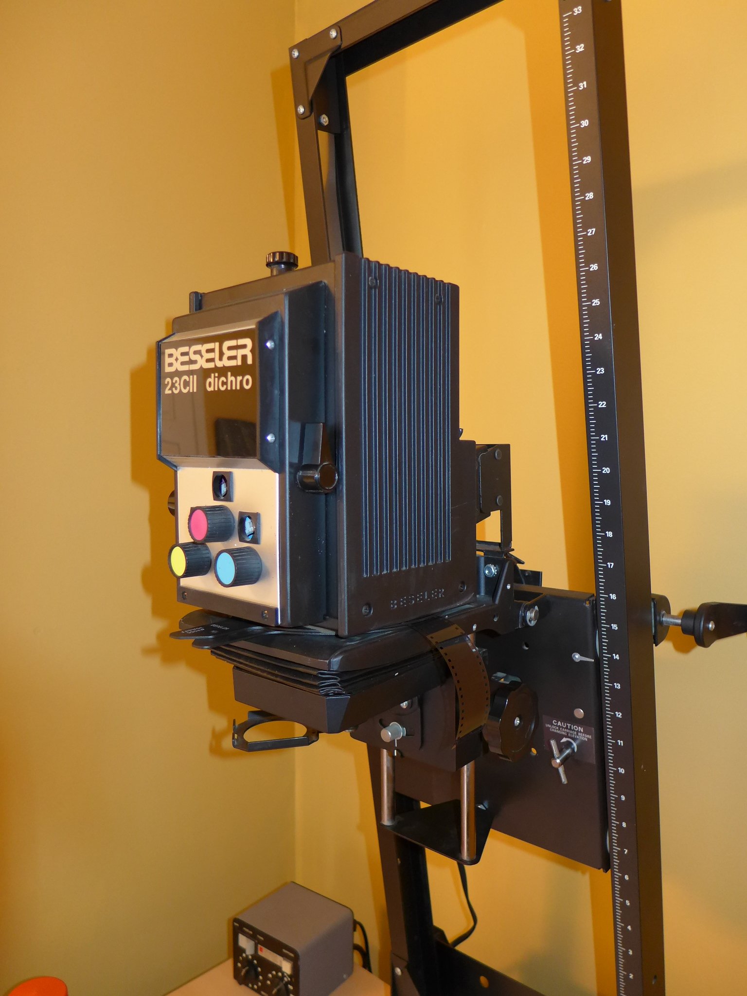

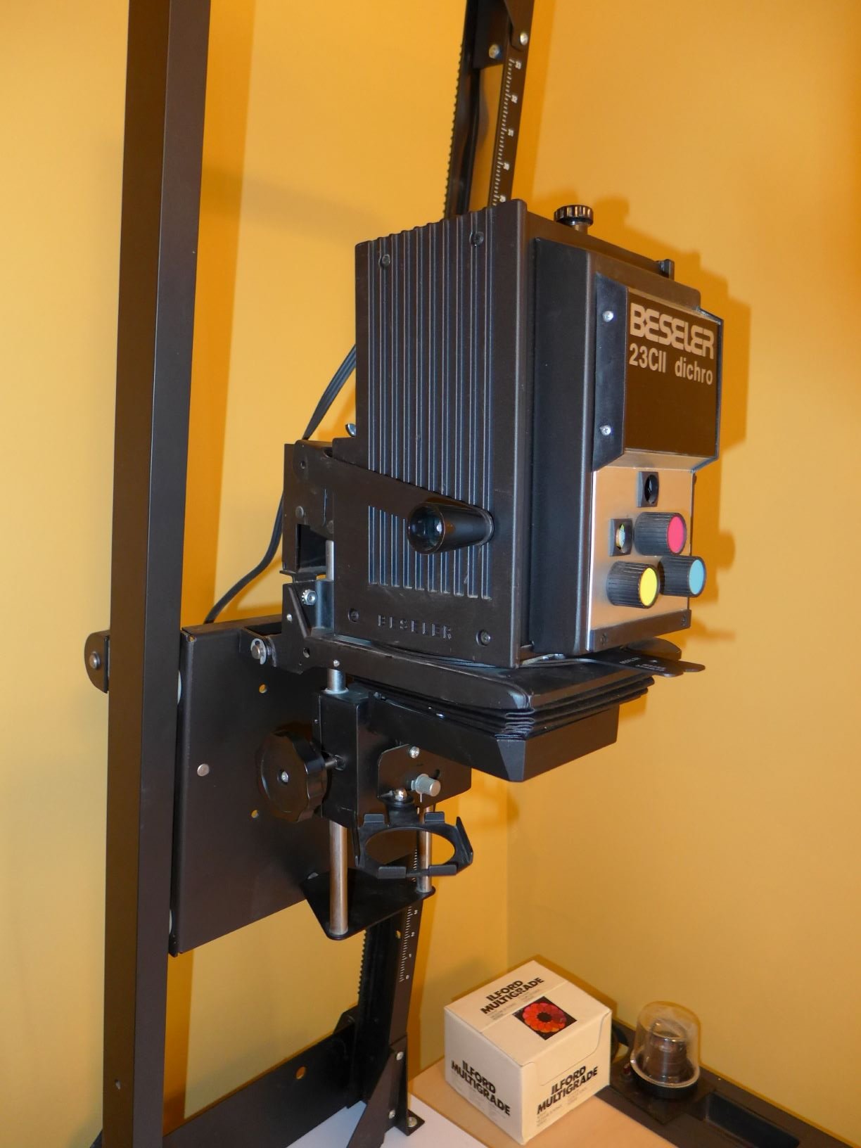

Here are some better lit photos of the enlarger. I see no means of adjusting the negative size. The manual says that it accommodates up to 6X9, but does not say anything about adjusting for different film sizes. Since the light is diffuse, does the distance from the lamp really matter? Once I get a MF carrier I can check it out.
By the way (if it helps identify it), this head swings up to project onto a wall for large prints.
