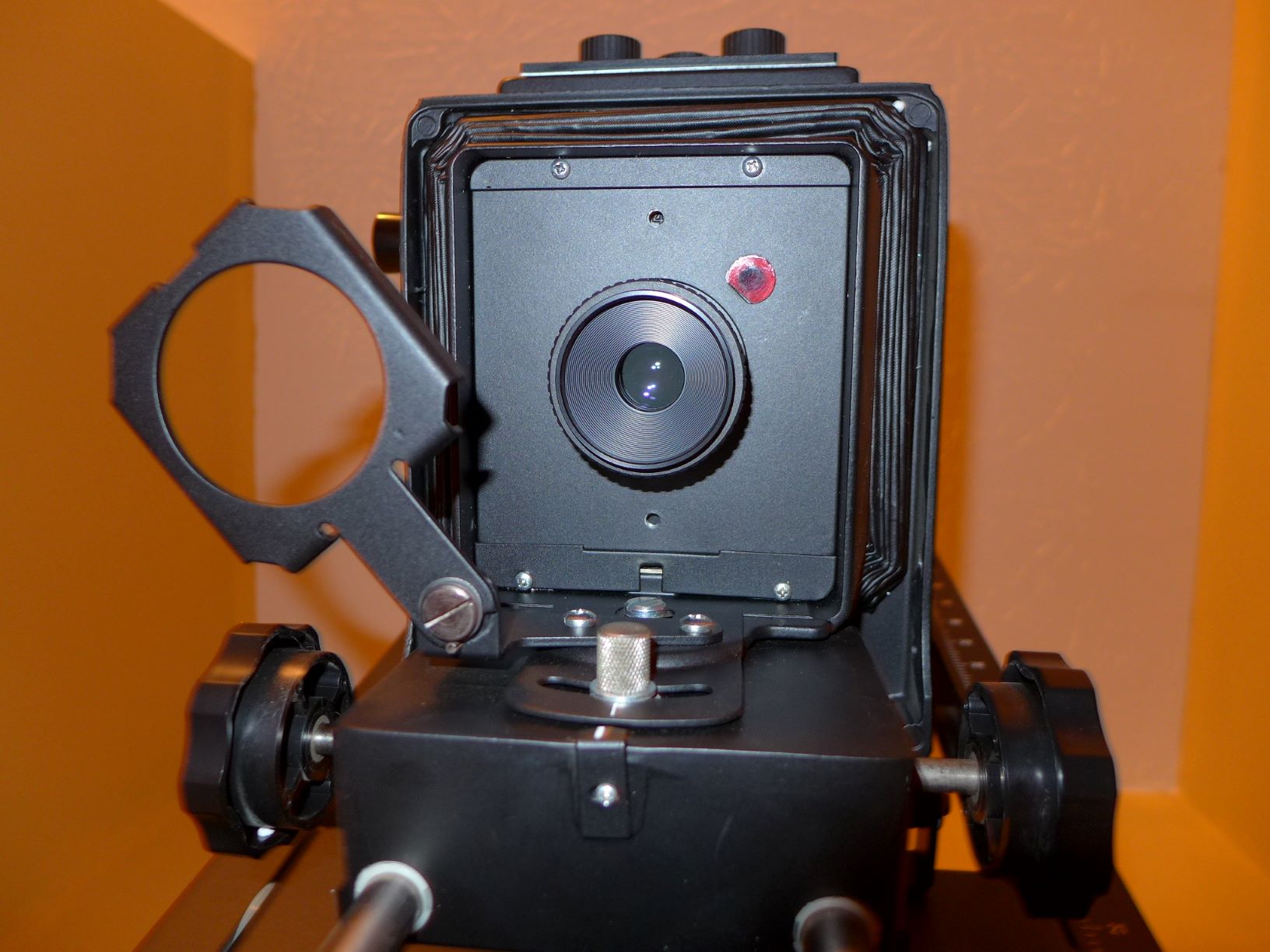

Thanks, Matt. It definitely looks large enough to cover 6X9.
More questions:
1) Everyone talks about how critical darkness is, but this enlarger uses the lamp to light up the three color dials so you can see, and it is definitely white light coming out.
2) On the photo below, there are two holes threaded for screws that light is coming out of. It doesn't appear to affect the projection, but I've not exposed any paper. Should I cover these?
3) While trying to learn to operate the enlarger, I tried to remove lens board but could not. There are two screws each on the flange below the lens board toward the front and back (see below, the top is toward the front) that appear to be attaching the flange to the lens board. The manual says that the lens board is supposed to kind of slide up and in. Is this maybe the previous owner's attempt at making a way to tilt the lens standard front to back? I can't get the lens out, and I don't want to apply more pressure. I guess I'll remove those screws and see...
Thanks again to everyone for the help.

The lens board mount is spring loaded. If you grab the lens and push it towards the back of the enlarger, the lens board should slide backwards against the spring. The front of the board will then be free of the mount and the board can be removed.
Thank you! The manual described it so much more convolutedly (is that a word?). I was pressing up on the back side...

Yes, those two holes need to be covered, they really dont belong on the lensboard. They will cause overall fog and lack of contrast on a print otherwise.

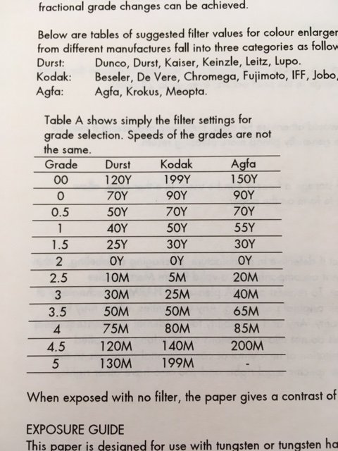

Gentlemen, I have another question, please... The chart that came with my Kentmere paper (see below) shows the filter settings for Durst, Kodak and Agfa. Do any of these approximate Beseler's settings? I have Ilford filters, but it is probably easier to use the color filters in the head.

It says right on the chart to use the Kodak settings for the Beseler. Want to borrow my snakebite kit? :smile:
Ha! I've been reading too much stuff. It was too clear and easy for me to find.
