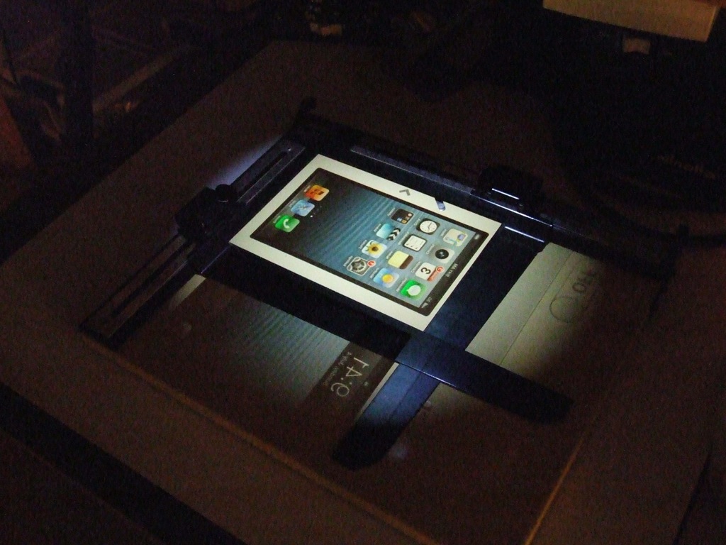

I went through a period where I was actually using my iPhone instead of my Minox. I have a high-end 27" Mac screen and Makro-Planar lens on my Rollie 6x6. I even laser aligned the screen to my lens and used this as a film recorder for the iPhone images. Thing is they were all pretty poor. The images look ok on the tiny iPhone screen, but they make poor 8x10 enlargements compared to a 35mm film camera of even 16mm camera. Thus my current interest in this thread. I got a new battery for my Minox LX and about 30 empty cassettes, but no film splitter at this time.
I also tried printing straight from the iPad or iPhone screen by sliding the device into the negative stage, but those prints were very bad also.

Yep, I've seen this demonstrated on YouTube. The screen resolution (not to mention operating system related limits, like auto-sleep) place a limitation on what you can produce this way. With fine-grain film you can get better prints from a Minox negative, easily. Even with grainy fast film, for that matter.
