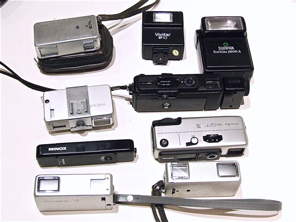

The Minoltas are nice. Do you want fully manual or semi-automatic? Do you want plastic or metal? They are not very expensive you can start a small collection and see which ones work best for you. My all time favorite is the 16QT. It only has 2 shutter speeds, but it has focusing (with viewfinder markers) and a built in two-light meter and adjustable f-stops. It also has the largest image size available when using single-perf film.
16-mm-and-minox-jpg.218743
Manual all metal would be my first choice. Manual plastic would be second. The QT sure looks sweet though.
