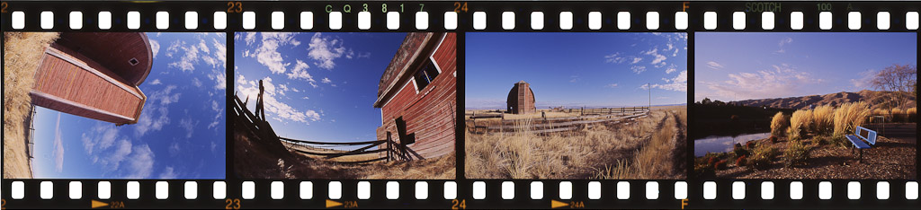

"classic" look sounds good to me, scotchchrome seems to look rather like that if you ask me. We need such a film that gives warmer colours like what Kodak E100SW offered, since there is nothing on the market.
I like these scotchchrome results if we see something similar with the new ferraniachrome!
