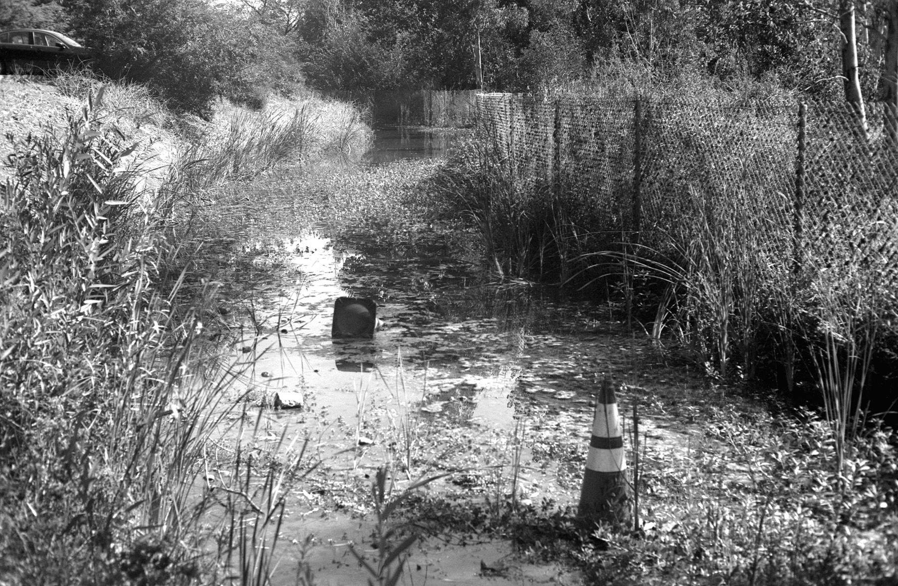

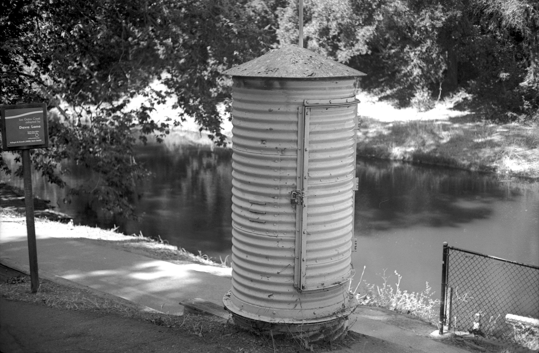

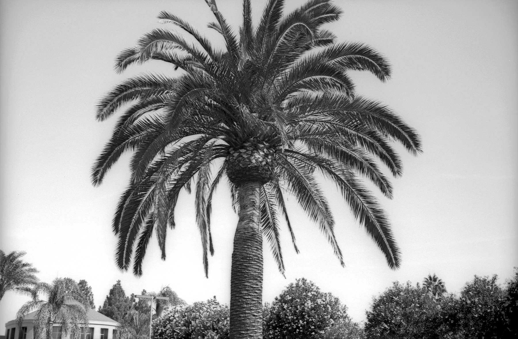

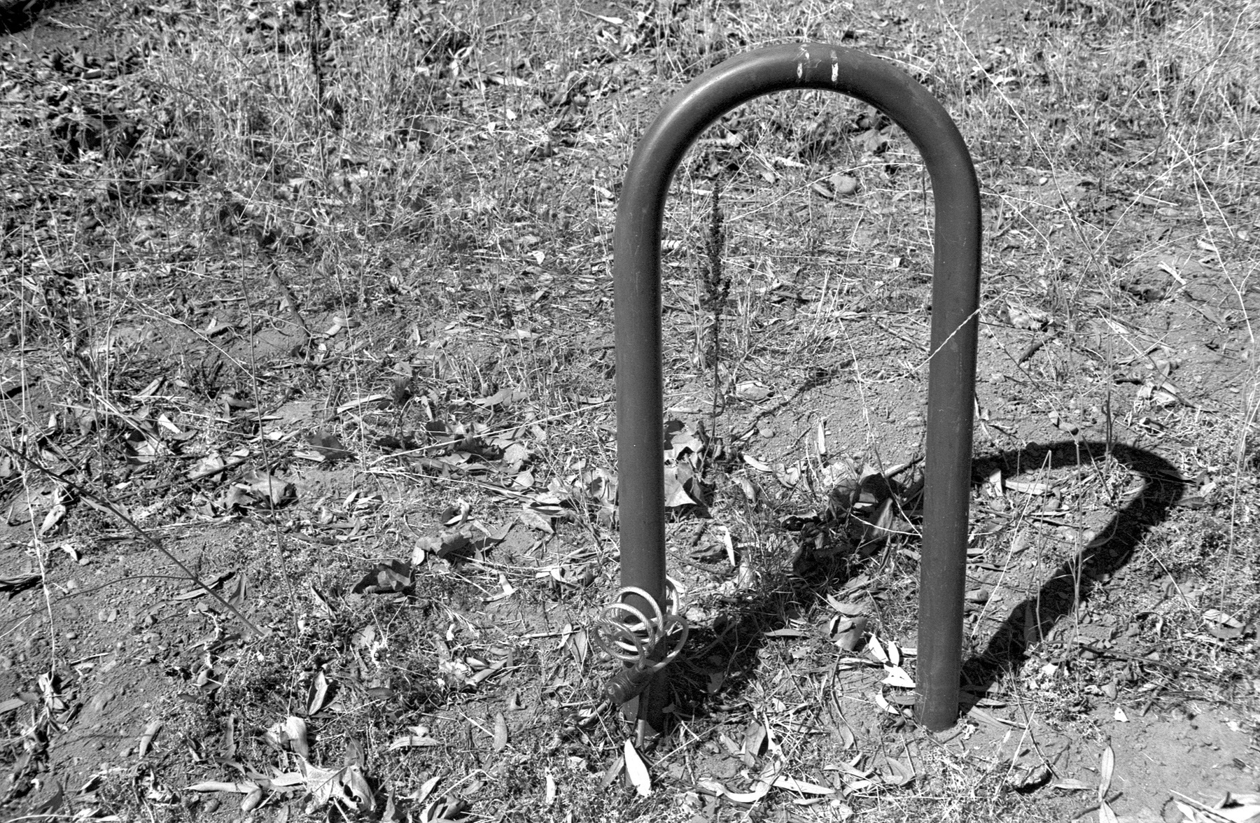

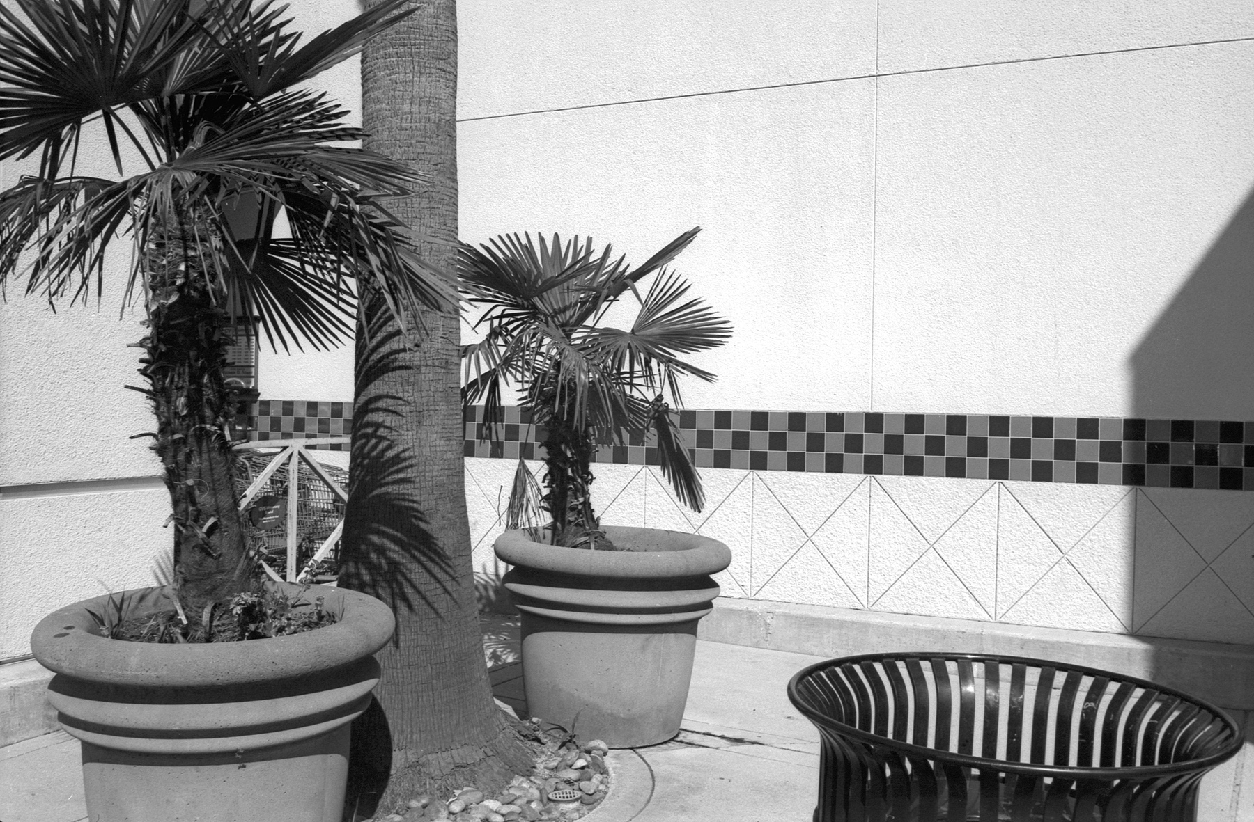

I shot another roll in my Canon P, I shot a 40iso, my developing was a 3 min prewash in distilled water and 15 mins in Pyrocat HD 1-1-100 continuos agitation first min and then 10 sec every min thereafter, 1 min stop in plain water and 7 min fix with TF4 and then 10 min flush and 1 min photoflo
Here are a couple of shots, I have yet to finish scanning but will post to Flickr when done and provide link.
So far looks good for the first effort, I will give it another try in a few weeks
Thanks
Don
These look good, Don! A similar range of tones we see in our internal D-76/D-96 testing.
