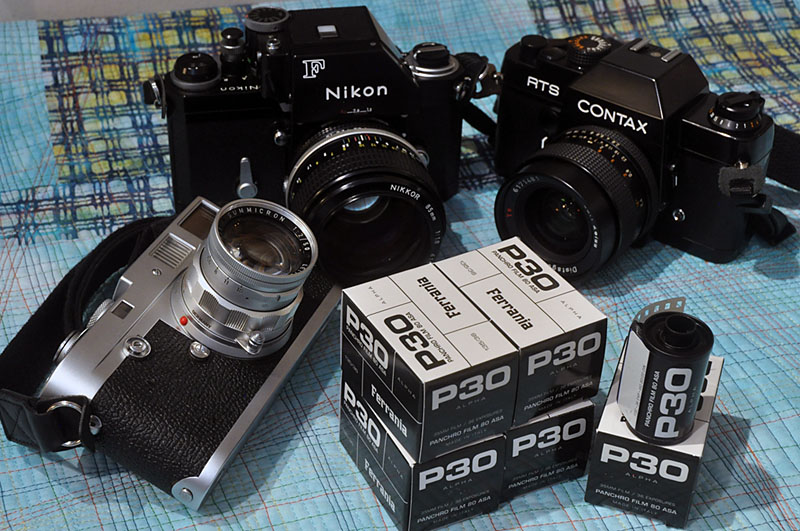

Well, look what arrived in the post today.... only 2 days after I received the shipping notification. :smile:
Now the tough part is deciding which camera gets to play first...
Not in a big hurry for the color film as I'm mostly a B/W shooter, but it's pretty cool to see some real product from Ferrania after all the wait.
Nice tablecloth.
The weights are pretty nice too.
My Suggestion: Left Right Center
