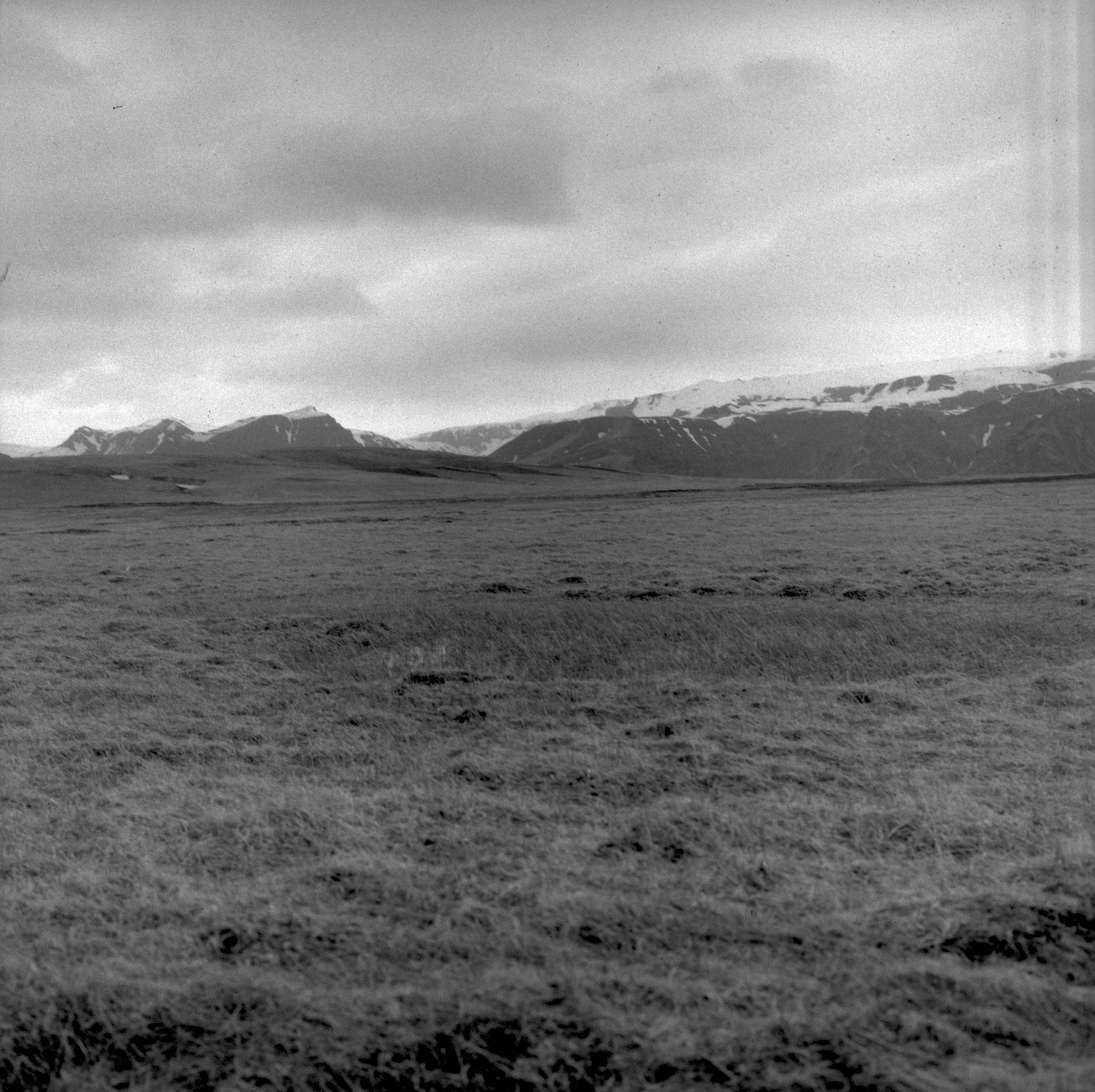

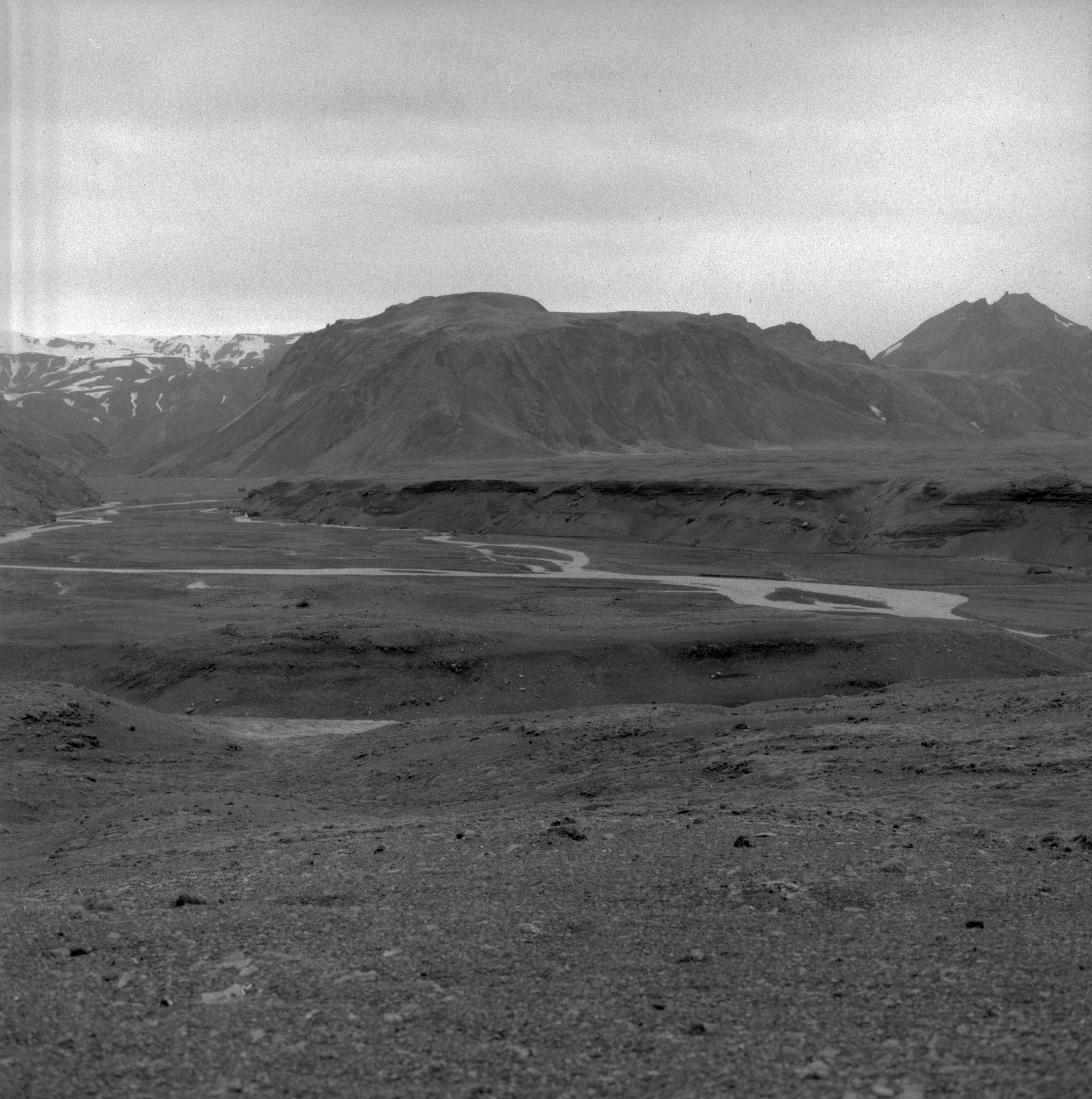

I have just bought a Hasselblad 501 CM that looks to be in a very good shape, the buyer has used it occasionally once per year, the last years. It was bought by the owner 2001.
There are some marks on a lot of the photos. The strange things it´s not on every roll.
I only have taken one color roll and it seems not to be there, but it could be.
It´s mainly on the b/w photos that I develop myself, but not on every single roll.
I have used both a newish Rodinal, oldish HC-110 and a just mixed D-76 as well as just mixed Foma Excel.
I have used three different stainless steel reels and different films, purchased at different places.
I also took some photos with a different camera, developed with two of the reels (took two rolls) and there are no streaks.
So, it seems to be the camera.
Do you know what it could possibly be?
Is it the back, the body, the lens?
Where is a good place to repair in Europe.
Is it repairable you think?

I'm guessing these are neg scans you've done using an Epson scanner, yes? If so, it's not your camera, it's the scanner that is introducing the streaks. Epson doesn't want to talk about this problem, since it's a hardware issue and there is no fix for it.
If you are in fact using an Epson V series scanner, let me know and I'll tell you how to limit/avoid the problem as best you can.

paulbarden is 100% correct. I use a V700 and I have had this issue since the first time I used the scanner. It's part of why I dislike Epson very much. It is my theory that what you see is a reflection that occurs between the glass surfaces and the negative holder inside the scanner.
You can use tape and tape your negatives to the glass platen, and use the bottom part of the scanner instead. You lose a little bit of resolution, because the top portion is better. But you get rid of the banding issue. Now pray you don't get Newton Rings instead (mainly Kodak TMax problem).

It´s an Epson v700, so yes.
A friend just came to take a digital shot of the neg and it is not on the negative.
So you need to tape it down and not use the Epson holder?
Annoying, it´s an expensive scanner and this is not really alright. It´s just recent I started having this issue.
Can you give me dumbo guidance how to mainly avoid this issue?
Also it seems to happen especially at frame 1, 3, 6 and 12 - but not always and it´s not on every roll.
I also scanned some neg twice.
And it seems to be mainly Hasselblad. Not my other medium format camera and it´s not on any 35mm.

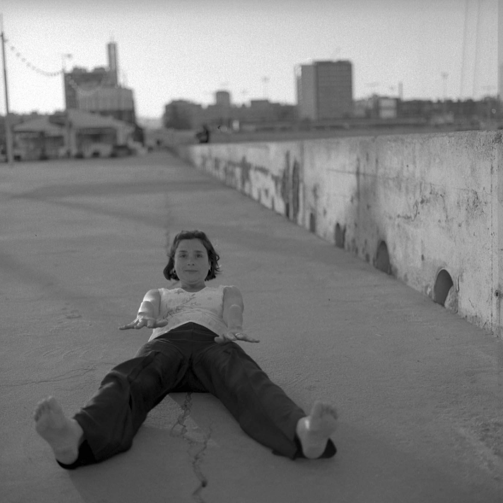

It appears more frequently on Hasselblad negs than any other, because the Hasselblad image area is smaller than most other 6X6 negs, and so more of the unexposed border area is "seen" by the scanner, and that makes the problem worse.
1) always position your negatives in the neg holder so that the neg is as far to the outer edge of the holder as you can position it.
2) whenever possible, position your negative so that areas of least density are the first thing the scanner encounters as it makes its pass. Areas of high density will make this problem far worse if those are the first areas the scanner "sees".
3) if you continue having a big problem with this effect, you can take a strip of unexposed* film (I use a 1/8" strip of 4x5 sheet film) and slip it into the neg carrier at the top (where the scanning bar starts) outer edge of your negative to block out the unexposed region of the film. The problem is caused when the first part of the scan happens where there is a region of high density visible adjacent to unexposed border region. Anything you can do to avoid the scan starting where zero density meets high density on the neg will limit (or completely prevent) this streaking from occurring.
Here is the sample image I showed to technician friends earlier this year when seeking a diagnosis for this exact problem. I too thought the issue was the Hasselblad itself, when in fact the problem was the Epson V750 introducing artifacts that were more frequent on Hasselblad shots because the Hasselblad negs are smaller and show a wider unexposed border.
If anyone else has found a better solution to this problem, I'd sure like to hear it. (Aside from buying a different scanner. FYI Epson tech support totally failed to address my problem, even though I know they know about it. They just told me to take it to the nearest service center "for repair". I won't buy another Epson scanner, thats for sure)
*or exposed and developed (IE: dark) film.

In this case, it has helped, as it is scanner related apparently and not analog. After posting a friend took a photo, of the negative and yes it is scanner related.

I went to the shop where I purchased the scanner. The guy immediately said it´s due to the scanner. Thought it is a shadow that casts itself on the dense part of the negative.
He lent me some holders for v800 - which has a glass - but you can only scan one row.
And the same negatives now scan hassle free.
No streaks.
THink I am going to purchase a couple of v800 holders.
Not as flimsy as the v700 and cost about 10 euros each.
