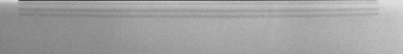

I'm glad I browse APUG and learned about this problem. I've had a similar thing happen when scanning 4x5 film on a V750, where there were dark bars at the flap end of the negative. I always happened with the same holder - both sides - one was worse than the other. I happened several times, and was especially bad when there was sky or gray background at the top (flap end) of the image. I thought the film holder was bad but couldn't understand how a holder could case dark bars - suggesting somehow the film was under exposed. I put the holder aside - it is basically a new Fidelity Elite holder that I bought in a lot before Calumet went under. The real answer is that this holder masks the top of the film enough that the clear area intrudes into the scan frame on the V750. By habit I always put the film in the negative holder with the top (notch) at the right. I rescanned the film with the top to the left - in this orientation the scanner negative holder completely masks the clear area - and the bars disappeared on the scan. Thanks paulbarden.
Crop from top of image - exposure turned way down and contrast up to emphasize the bars - at the top is where the clear area intrudes into the frame -
