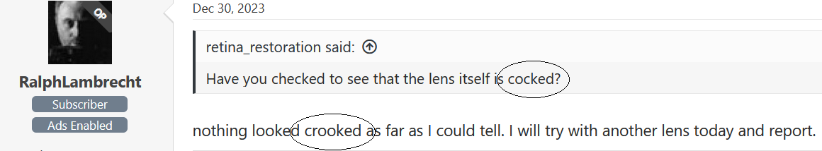

I'm perplexed. I'm not new to this camera; this issue got me. The camera and its normal 80mmf/2.8 CF lens have been stored safely in a foam-packed aluminum case. I took it out yesterday and tried to mount the lens after cocking the camera first but the lens couldn't be mounted. It just fell out of the mount and luckily onto my bed. No way to establish a solid connection. Ever heard of that?
It seems like you've already seen this, but our comment is "The lens needs to be cocked so the timing is accurate. If he cocked the camera and not the lens, they won't sync up."
Not much more we can add without seeing it.

to finish up this thread,the issue is fixed. I'm afraid it was a typical Hasselblad issue that the lens was not cocked and the body was;both need to be cocked to attach the lens. I knew that but was unable to cock the lens off body. a superfriendly customerassistant at a camera dealer in Cologne (Lambertin)did it for me and showed me how to do it myself in the future.Pretty nice considering that I ddn't even buy the camera there, but they certainly won a new customer for the future, Thanks for all the valuable hints on Photrio too!
to finish up this thread,the issue is fixed. I'm afraid it was a typical Hasselblad issue that the lens was not cocked and the body was;both need to be cocked to attach the lens. I knew that but was unable to cock the lens off body. a super friendly customer assistant at a camera dealer in Cologne (Lambertin) did it for me and showed me how to do it myself in the future.Pretty nice considering that I didn't even buy the camera there, but they certainly won a new customer for the future, Thanks for all the valuable hints on Photrio too!

@RalphLambrecht The very first reply you got in this thread suggested to check whether the lens was cocked. Something was lost in translation here.
Maybe:
Just do not go off half cocked, as that will get one in trouble with a Hasselblad.
the lens was cocked but the slot was not in line with the red dot! mia culpa;mia culpa; mia maxima culpa:smile:
