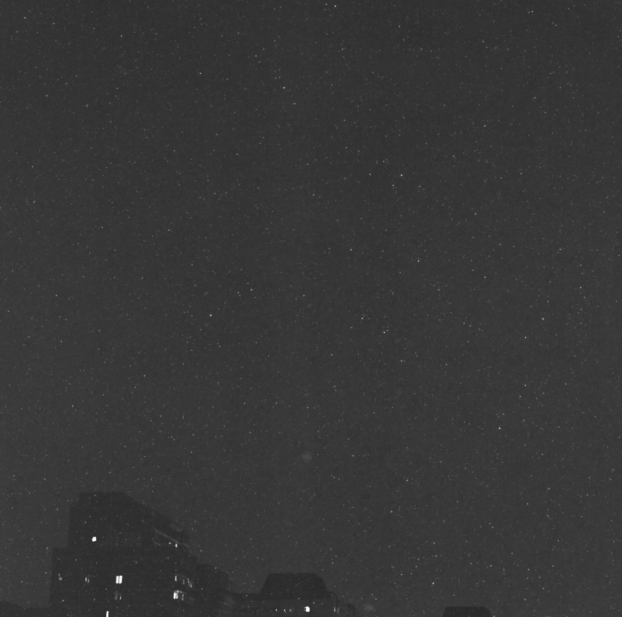

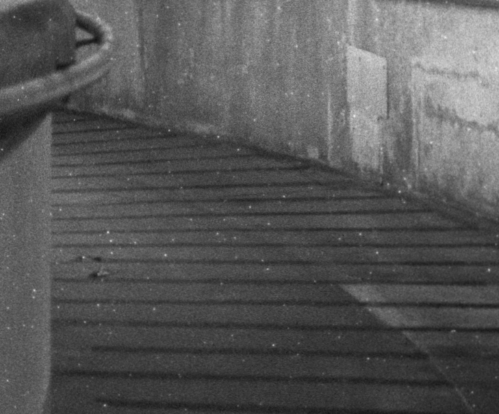

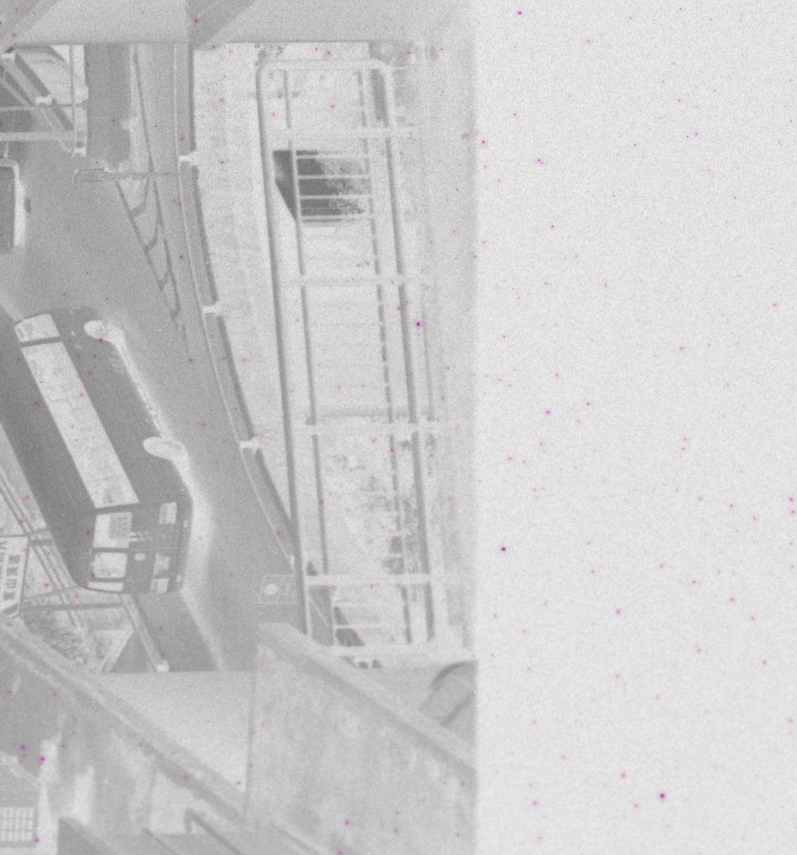

My recent 2 rolls of Fomapan 100 have the lot number of 023856 4 and exp. date of 08 2027, very close to yours, and they also have very similar spots! They're in fact the first two rolls of film I developed myself. I didn't notice anything wrong with them at first, and sent them for scanning in the lab I've went to for development and scanning. The images came back with these jarring white dots that I've never seen on previous rolls of Fomapan that I shot and sent to them for dev. Only some of those past rolls showed minor white spots, in which the size and number of the spots are just a fraction of what's in the negs I developed myself. As a side note, the lab uses Ilford chemicals, especially DDX developer.
the above is a quarter of a 6x6 neg
A lab technician told me that he thought it's most likely just poor quality control from Foma, as dusts don't show up like this. When I came back to look at my negs more closely, I noticed lots of tiny red or purple dots on the negs.
This image doesn't show the color of those dots very well, they're definitely red or purple.

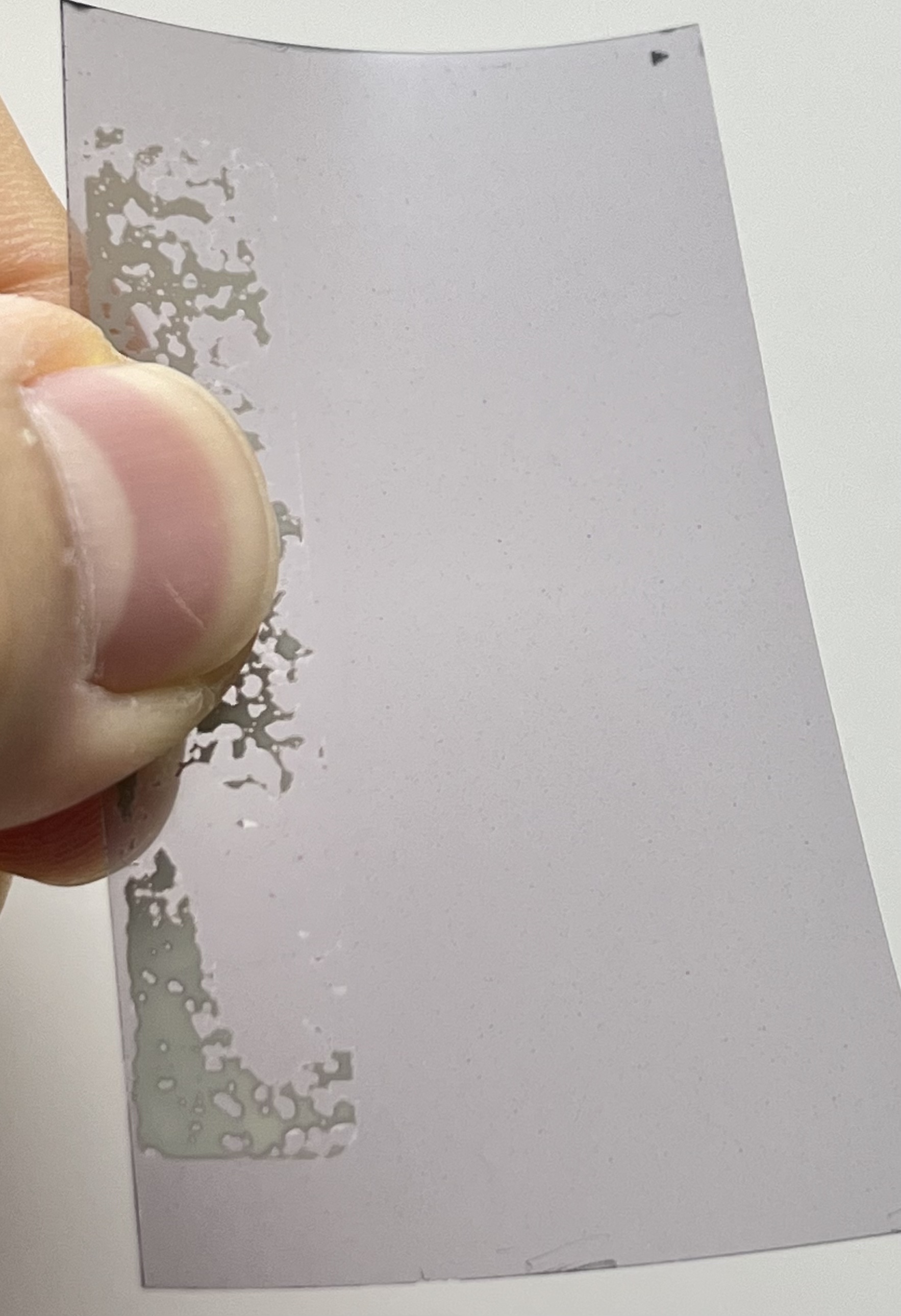

Luckily I was able to find out about this being potentially caused by anti halation layer not coming off of the film, even to find someone with problematic films from the same batch as mine!
To make sure I'm having the same issue of this anti halation layer not coming off, I'll first try the ethanol solution on these blank strips I cut off from the two ends of the roll. I'll report on my results.

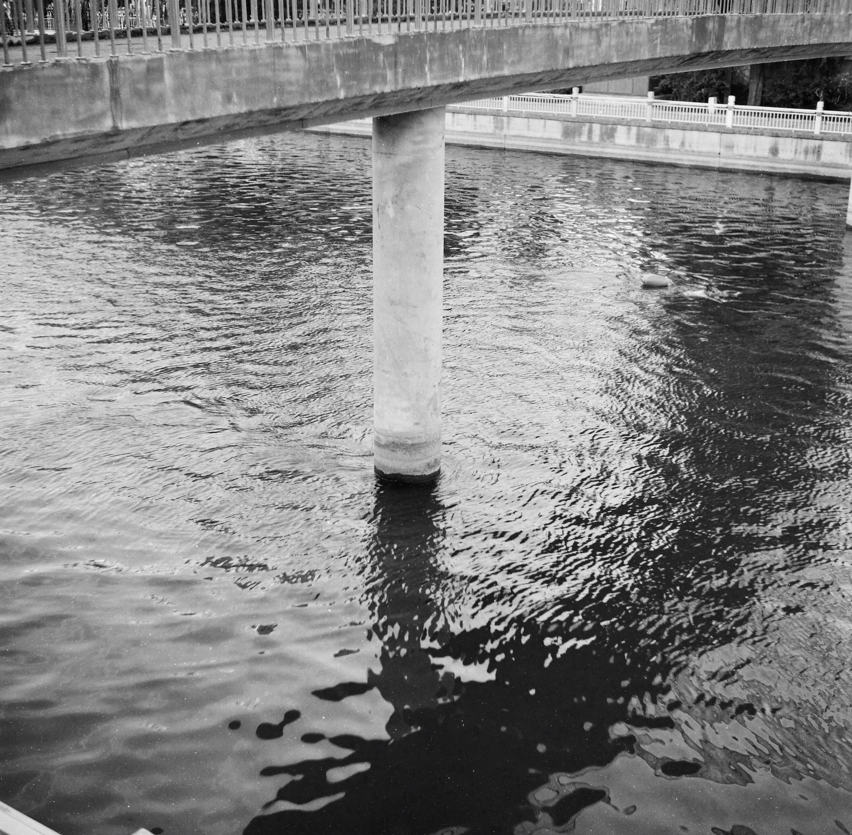

I think apart from those dots from anti halation layer, the negs came out okay. Here's another shot for reference.
