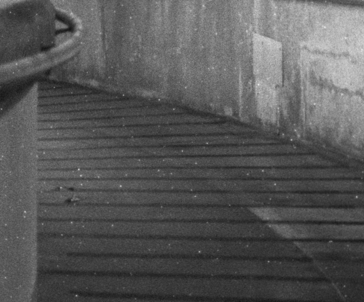

Ok guys, I just bought some Foma 100/200 120 roll films after years of not using them and...the purple spots return. Fomapan 200 batch is "014256 6" with exp date "05 2027". Fomapan 100's batch no. is "023856 3" with exp date "06 2027". I have emailed Foma to ask for ways to get rid of them...as I have tried all sort of ways to no avail. Water re-washing, photo flo, HCA wash, etc...
Developed by Rodinal 1:50 btw. Not sure if Rodinal made it worse?
Image mode scan:
B/W mode scan:

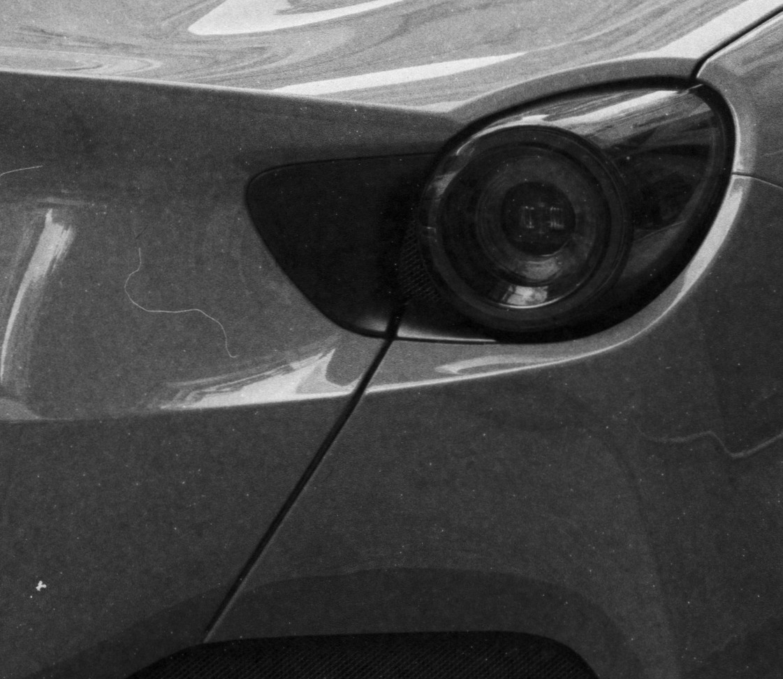

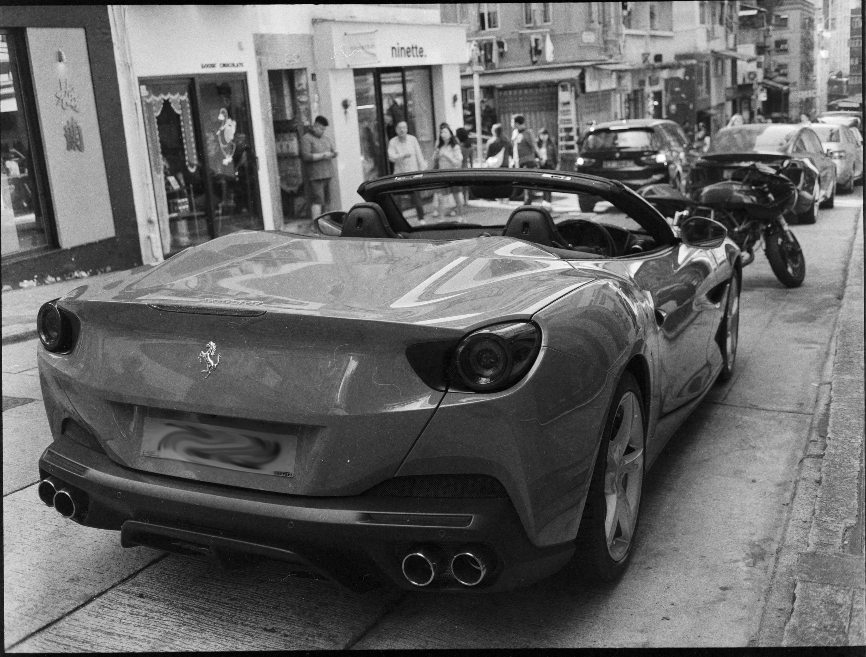

I did a pre-soak for a 120-format roll of Foma 400 today for 1+2+4mins, pouring out the dark green soup a few times, and then do the dev, fix, & wash steps. I can confirm the spots are still there! So it seems what really matters for the spots is the 70% ethanol/IPA wash, not the pre-soaking process.
What's even worse is that I got uneven developing (mottling) this time, something that never occurred to me in this batch of foma 400 and foma 100. The only thing I could think of, is the pre-soaking. So presumably, at the end of the day, pre-soaking didn't resolve the spot issue while introducing another one. So much for me - back to the never-presoaking camp. apparently YMMV...
Anyone also using foma 400's 120 format & have different experience?
FYI, I use Xtol 1+2 one-shot solution, 11min @23C, 60rpm rotary processing. Density seems fine.
