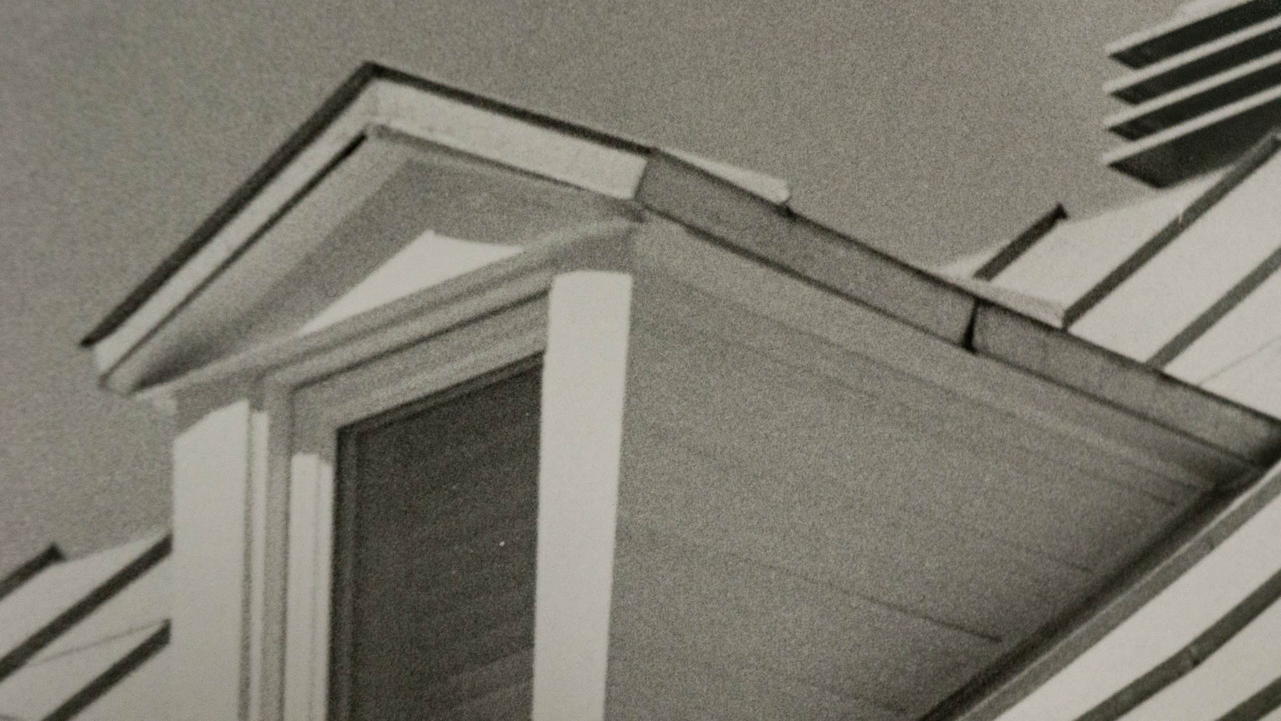

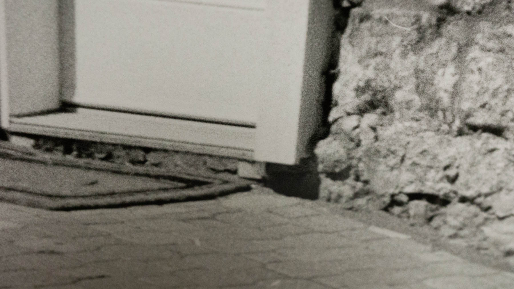

I suppose it's always relative to the kind of results expected. I went with three agitations every 30 secs, at 20C.
And some close-up of specific areas.

Ultimately, the point is that once your exposure is correct, this has character.

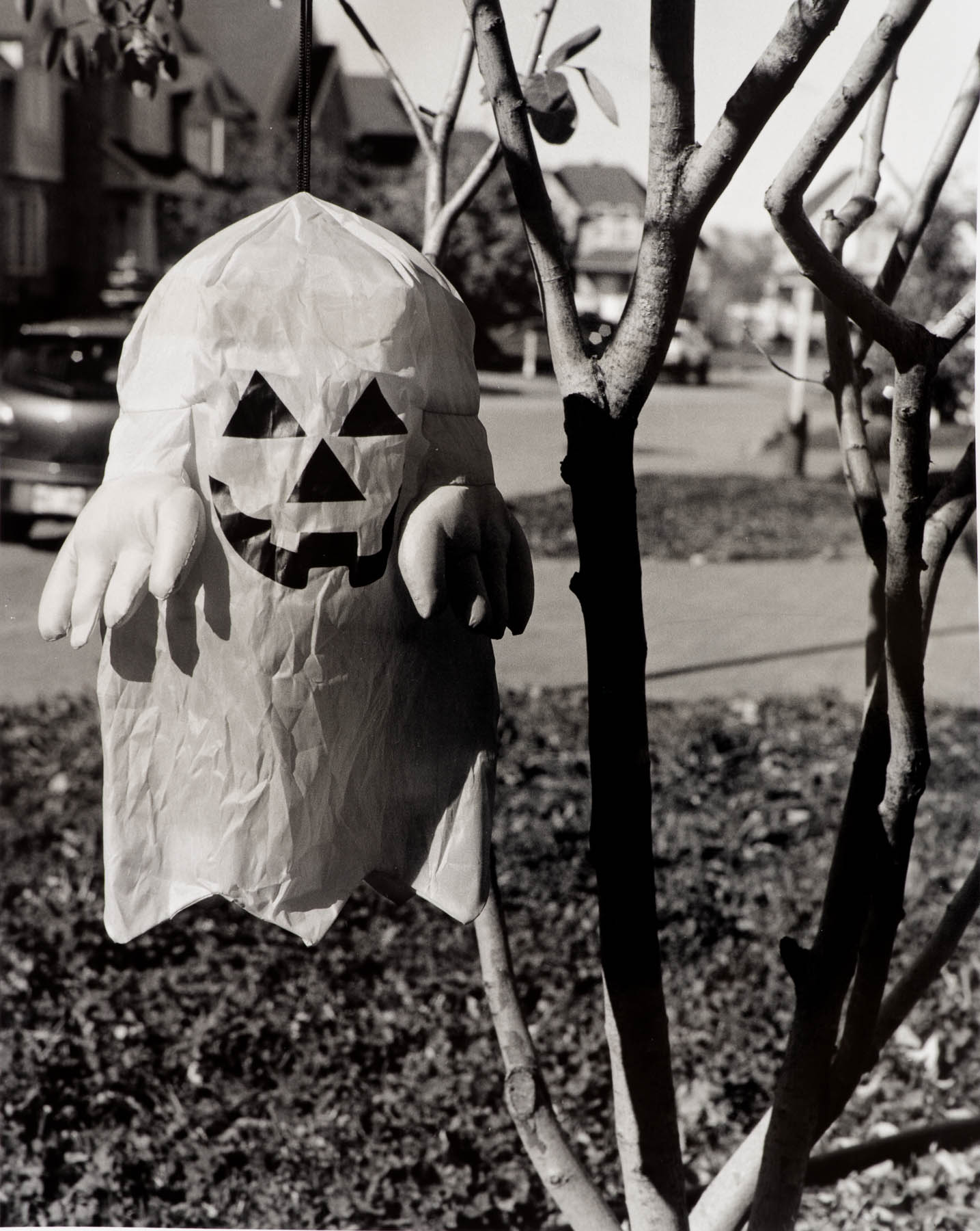

Alright, so I posted this image in the gallery. I think it shows well the characteristics of the HP5+ and DK-50 1+1 combo. It's very nicely sharp, and grain is there just enough to help with sharpness/texture (I printed on 8x10). I really like this look.
You can also see the characteristic contrast of DK-50. Unlike D-76, which gives good shadow detail and evens out contrast, DK-50 has a more "icy" look: there are brilliant highlights, and the contrast is more apparent. Shadows quickly fall off, but you can still have delicate gradations. I find that on Tri-X the loss of shadow detail is maybe exaggerated, but on HP5+ it's more balanced.
