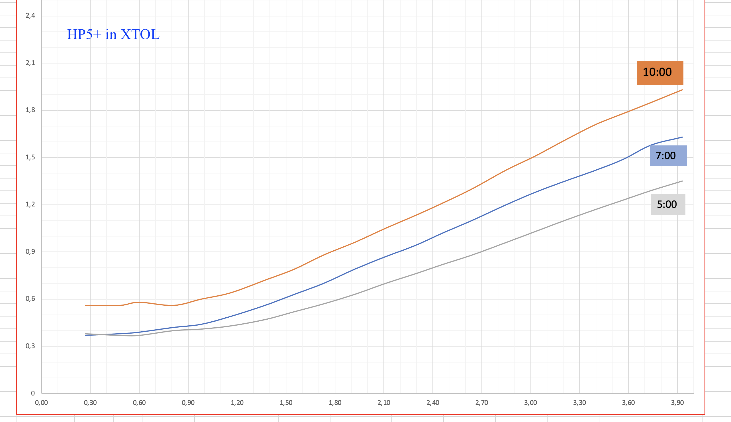

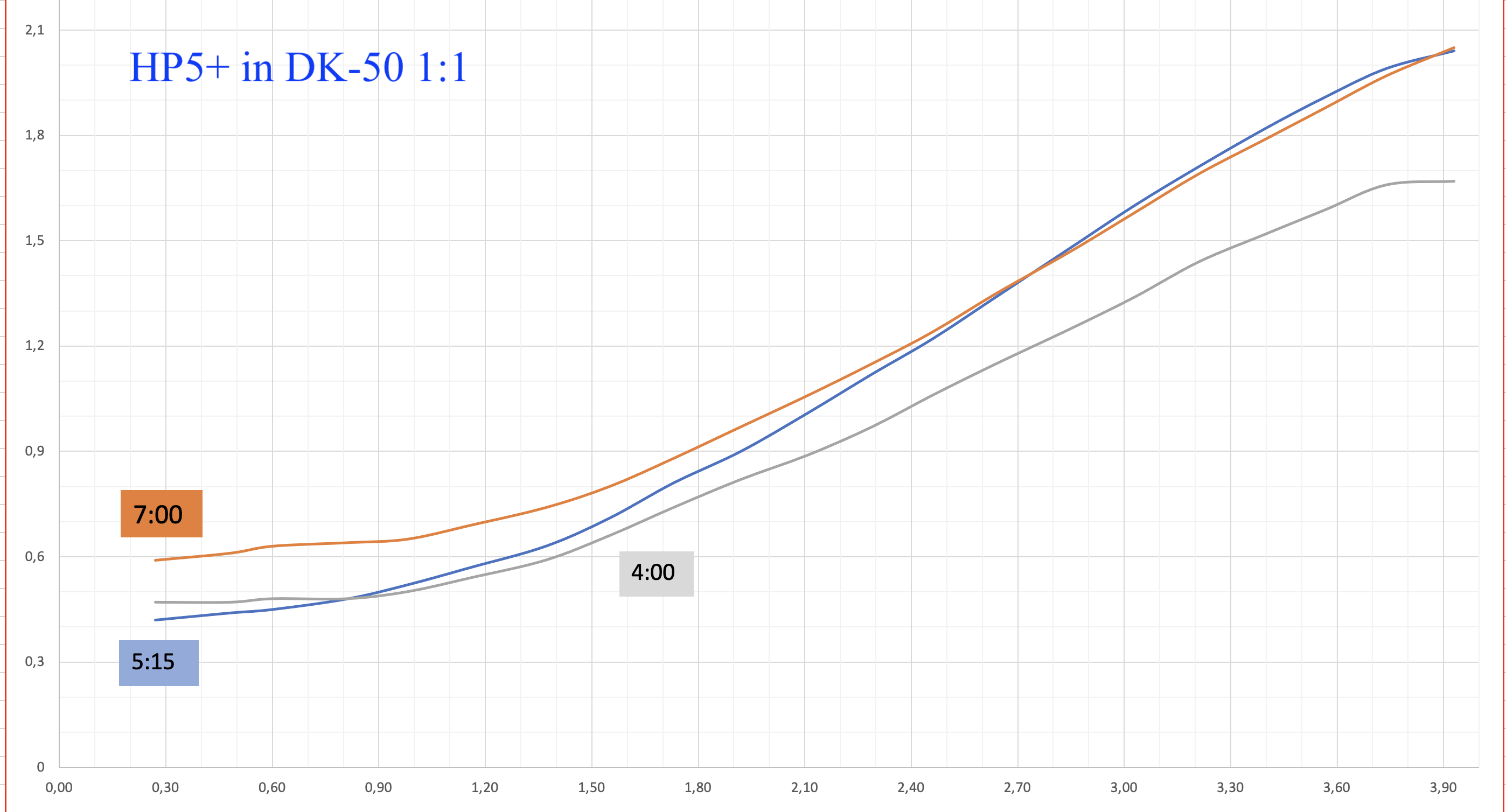

Okay, so now that I have a densitometer, I've been measuring everything transparent and reflective around the house. Eventually I settled for something useful like films and papers.
Here's a graph, done to the best of my capabilities, with due care to scale and proportion of axes (both are in logE units), for HP5+ in DK-50 1:1 (replenished), for 4, 5:15 and 7 min. It's followed by one for HP5+ in XTOL, for comparison. Everything done with a Stouffer T2120 step wedge and a Dektronics densitometer.
Main observations:
- DK-50 turns HP5+ into a long-toe film. Comparing its effect to XTOL, the difference is dramatic. Whereas XTOL gives about a stop or so of toe before the straight line, with DK-50 you have at least half of the curve as toe and the other as straight line. Good news for those who miss 320 TXP in 120!
- This upswept curve is why people keep recommending DK-50 for portraits, because you have good highlight separations, but the shadows fall quickly. That's a classic portrait look.
- This may be a consequence of how films react today, but I noticed that extended development on both DK-50 and XTOL had comparable effects. Both of course increased base fog. With DK-50, going from 4 min to 5 min, you can see the typical progression of the curves, but at 7 min, this stops. DK-50 raises the toe, but does not increase the contrast of the straight line portion. So it means that with increased development you get muddier shadows and midtones. With XTOL, I could see an increase in contrast going from 5 min to 7 min, but after that, you only get more overall density; you don't get much increase in contrast even at 10 min.

1) I won't be chasing after extended development with HP5+. Should I really need it, I will either try something very responsive like T-Max or very old fashioned like FOMA.
Anyone got an explanation for what's happening here? I though people successfully push/expansion develop HP5+, what does this not seem to work in your tests?
Not fully sure, but already in 1981 Ansel Adams was remarking "contemporary thin-emulsion films have less capacity for increasing their maximum density than earlier materials." (The Negative, p. 83). Adams does not cite sources.
The other option I could see is gamma infinity, defined by Haist as "Gamma will be found to increase rapidly at the shorter times of development, but the increase in gamma is much less per increment of time at the longer times of development. Eventually, a maximum value of gamma, called gamma infinity (y∞), is reached.
Have I reached Gamma Infinity? And beyond? Or maybe, I needed to jack development time higher to 10-15 minutes to see anything significant.

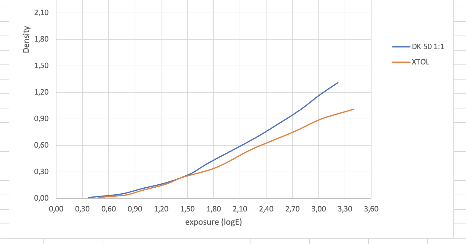

A few more tests today. I did a series of exposure in-camera at EI 400 with DK-50 1:1 and XTOL stock, and I now understand why I use a lower EI for DK-50, even though both developers give the same effective speed. The upswept shape of the DK-50 curve gives a different tonal rendition in the midtones than that of XTOL.
However, the same exposure gives me 0,1 above B+F, namely two stops below nominal exposure (so a Zone III gives me 0,1 for either).
That means I have to take into consideration the shape of the curve when I meter for DK-50. With XTOL, it's pretty linear, so even if I under- or overexpose a little, tonal separation remains consistent. With DK-50 I have to decide what goes where. That's why the photos I made so far that worked best where those I analyzed carefully with a spot meter. Exposing for the highlight can be an expedient way to ensure they don't blow out.

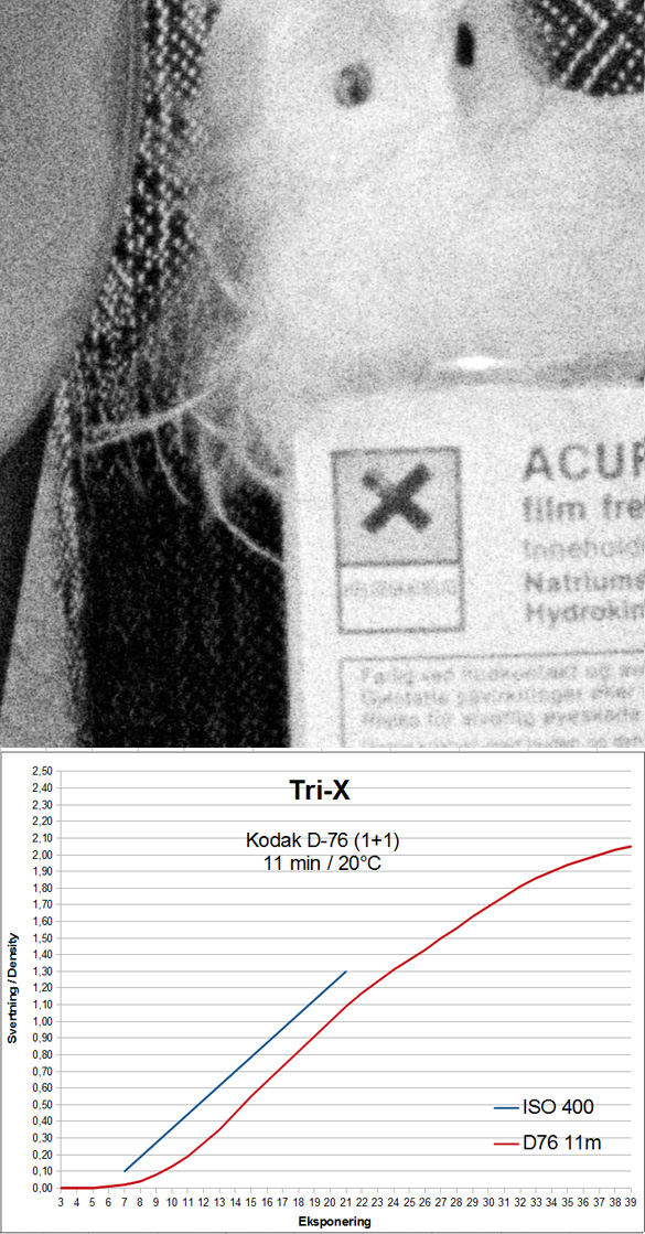

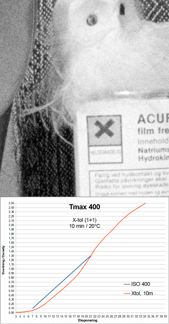

If you look at the film testing here, ( https://fotoimport.no/filmHP5) you'll see that HP5 is practically a "perfect" film in either Xtol or D76. In Xtol especially, it's true to speed and has a very long straight portion. No other 400 speed film he tested has the same long, straight curve. FP4 is very similar curve shape to HP5, and also true to speed.
Notice how Tri-X in D76 doesn't make box speed ( while HP5 does) and there is quite a pronounced shoulder. TMax 400 in Xtol has virtually no straight line, it's a big S curve.
The upper portion of each chart is a small crop from a test scene he photographed.
