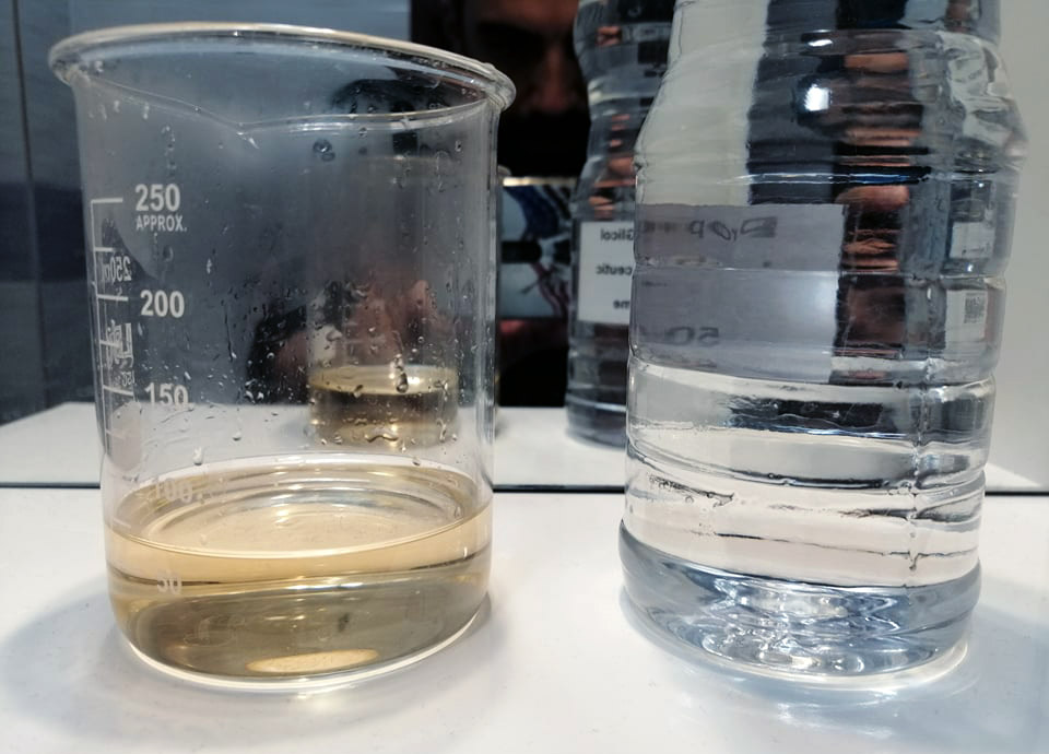

I just mixed 1 gr. of Phenidone in 60ml of propylene glycol heated to 65 Celsius. I am attaching a photo of the mixed solution sitting next to the untouched propylene glycol bottle. I can see a pale-brown tint of the phenidone solution while the original propylene glycol is crystal-clear. Is it ok? The phenidone powder seems to be a bit colored itself, but I am thinking that maybe the solution is tinted because it quickly oxidised. I really don't know how it should look like so that's why I am asking 🙂

Looks probably OK to me. It can be quite clear to slightly pink/yellow depending on concentration. It has probably oxidizied a little, but when you add it to solution with the rest of the developer I would expect the color to go away.
So the propylene glycol wasn't pure enough, you think? Actually it was yellow/pink tinted, but my bathroom mirror-light it's a 3200K led spot, so I guess that a proper white-balance is hard to get. with a smartphone. This oxidation is reducing the developing strength? Maybe some potasium/sodium metabisulphite added in propylene glycol before phenidone would prevent any oxidation?
No, sorry I think it's fine. You don't need to to anything.

Phenidone often looks a bit pink until other components are added.

Phenidone and its derivatives, if left to their devices, go through at least two oxidation steps during development. The first stage creates this colored compound, which is surprisingly stable, and more important: it is fully reversible e.g. with a secondary developer. The stability of this first oxidation stage allows for these high ratios of P vs. Q or C in practical developers.
Therefore I would not worry too much about moderate discoloration. Often I used discolored Dimezone-S in PG to mix E-6 FD, and as soon as I added the HQMS-K the color all but disappeared.
That's a very good thing to know! I was thinking that the coloration means that some oxidation happen and that will increase over time. Thanks for.explanation!
