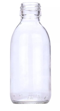

Btw, I use these:
With a generic white cap:
Unit price, consumer retail, is €0.71 for a 150ml size.
No need to make things overly complicated.

Btw, I use these:

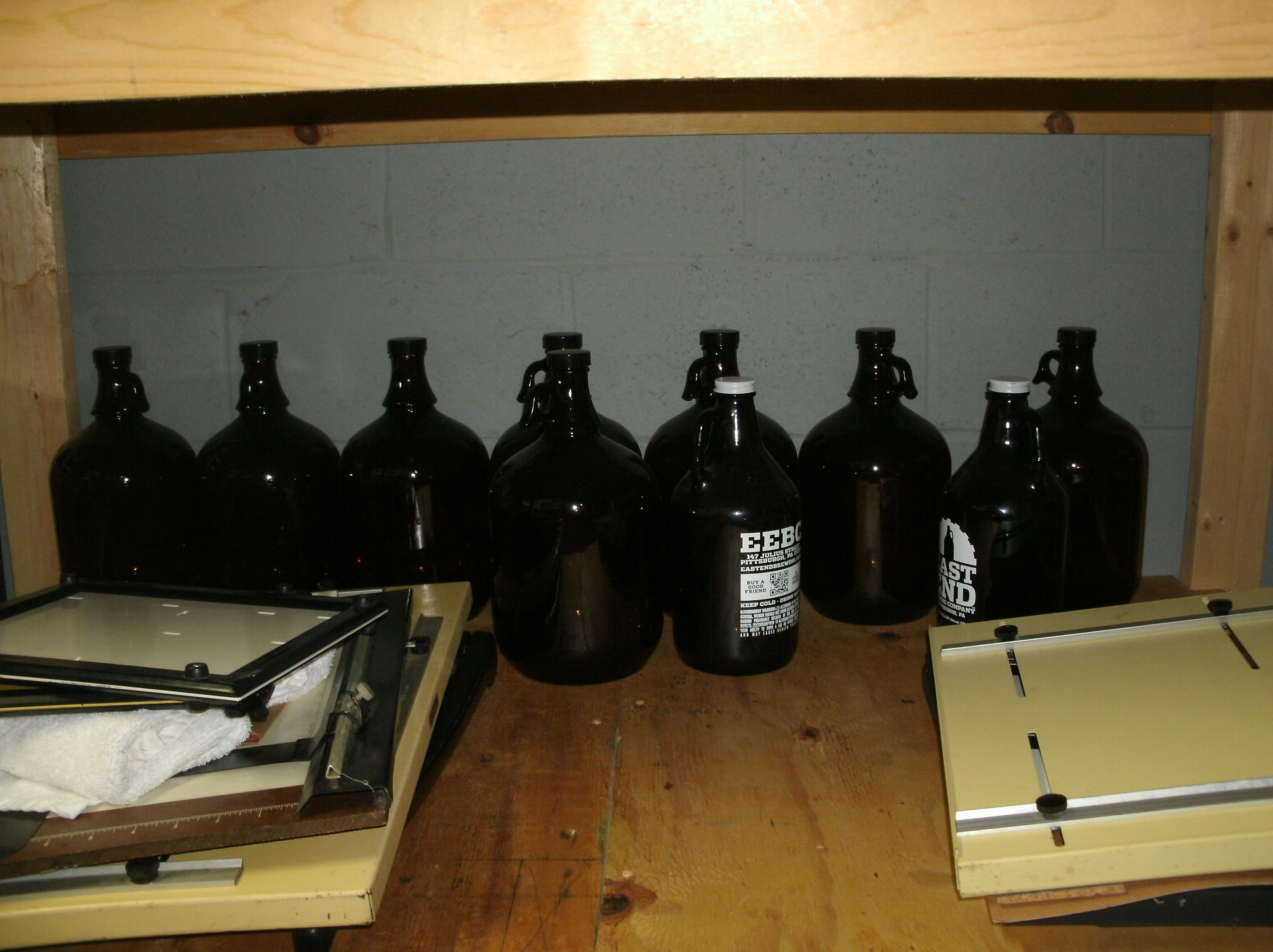

I have quite a few 100ml, 250ml, 500ml, and 1l brown bottles in my cupboard, all used for alt process chems. Then I have 8 one gallon browns plus several half gallon growlers (four of them are filled in the fridge). I don't use my growlers for chems, they make their way to the local brewery to be refilled, but I really have no need for the one gallons.
