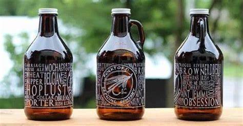

Hello,
I want to ask about glass bottles for storing chemistry. Is it very important that glass bottle or beer growler would be amber? Or it doesn't matter for storing chemistry if glass bottle or beer growler is clear? I find amber beer growlers 10 x more expensive than clear ones so maybe anyone who has used clear ones for storing chemistry could share their opinion?
I also found reagent amber bottles which can be used for storing light-sensitive chemistry. As I know photography chemistry is light sensitive, so is it true that simple amber / reagent amber glass bottles are way better for storing chemistry? Or it depends on the place where that bottle will be stored? Lets say that I will store bottle filled with chemistry in complete dark for most of the time and I would only expose it to light for a short time when I need to use chemistry. What are your thoughts about it?

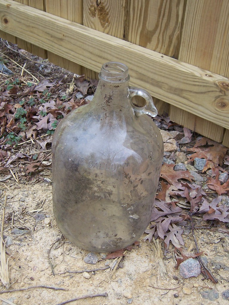

The latter and store in dark. That’s one dirty Gallo bottle. Amateur newer guy here. I have film stuff in bad temp conditions. Xtol replenished in glass brown bottles, filled, in a closed cardboard box. And fixer etc in clear plastic crushable jugs. In a cardboard box. But located in a garage which temps approach 95 degrees Fahrenheit and various fluctuations. Despite, all work fine after six months (by when it’s used up to make a new batch - oh, only once had my fixer turn brown orange). I’d suspect whatever bottle you use, don’t overthink, just box it from light, eliminate air inside, but maintain a cool(er) temp.

Most of the photo chemicals aren't light sensitive, so the amber glass is only important for the small number of exceptions, and with respect to those, only if you don't have a cupboard to store them in.
I like and recommend using the growler bottles to store photo chemicals because of their robust construction, the good caps that fit on them and the additional handles on them.
IMHO they are worth buying new and empty - no concerns about first cleaning out beer residue. That being said, they are relatively easy to thoroughly clean - assuming they haven't been previously used to store harsh cleaning chemicals or something similar.
I'll repeat the usual cautions about being sure to keep them away from anyone who might mistakenly think they contain beer or other beverages - especially if you have a teenager!
One minor caution: when full, a 2 litre/quart bottle is fairly heavy.

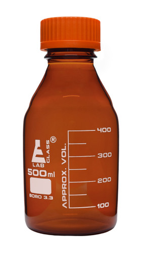

May I ask what are your thoughts on reagent amber glass bottles when storing chemistry for longer term? They are even more expensive than amber glass growlers but do you believe that they provide better chemical resistance than amber glass growlers? Has anyone used them?
These are likely overkill and unnecessary for ordinary darkroom work.
The main concern with glass bottles is really the cap. Otherwise, glass is pretty much glass, unless you start heating it up etc. I can imagine those 'reagent' bottles come with a really nicely fitting cap that's (mostly) impermeable to gases. A regular bottle with a tightly fitting cap will perform the same. I just buy generic clear glass bottles in various sizes with regular white plastic caps. My C41 color developer stays fine in there for a year or two, and perhaps even longer. That's as perfect as it needs to be, IMO.
