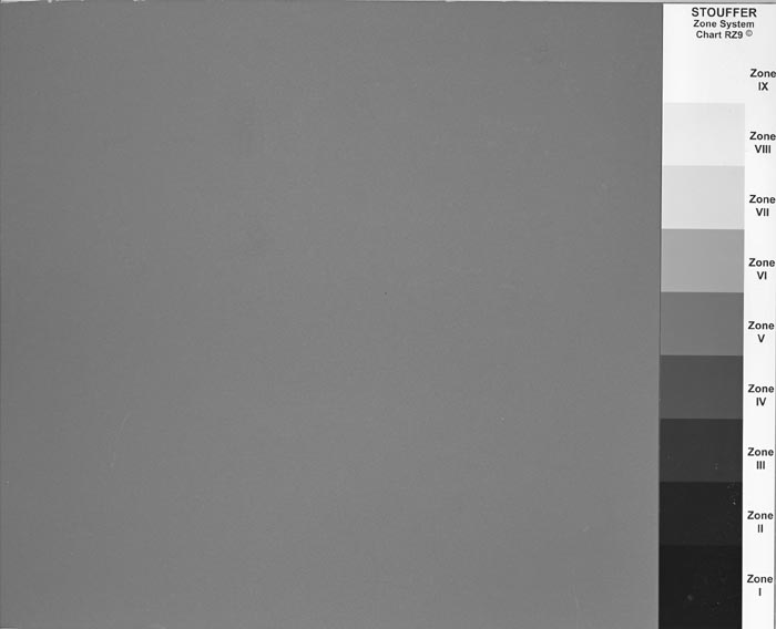

Here's a down and dirty system that I use... First of all, I am a nut job with 3 densitometers and have been back and forth with many trials, mostly out of curiosity and wanting to learn over the years. Still, I normally rely on the following and general experience.
I have mounted a Stouffer RZ9 Zone strip to a Kodak gray card edge. I can quickly see if there is separation at the extreme zones and make some reasonably accurate decisions on exposure/development times, etc from a quick look. I always do this on new films or developer combinations. When I have a spare frame and/or remember to, I include a frame on known materials and equipment to catch if anything is going amiss on metering, solution activity, etc. I can also do subsequent frames up/down in exposure to determine shifts.
I've attached the card/zone combo to illustrate. The large gray card area also gives me a readable area for checking on a densitometer so I find it a usable, consistent reference point. I can also plot projected curves from the smaller step wedge areas if I want to delve further. I find myself doing less of this as experience starts to allow a lot of interpretation from a simple inspection with a loupe on the film.

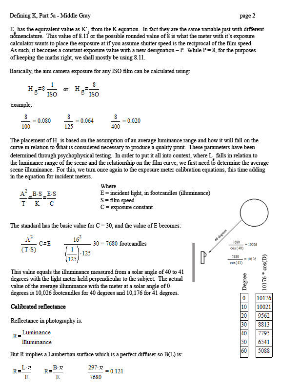

Thornton:
"Nevertheless exposure meters are supposedly set to render anything they read as standard 18% grey, which is zone V in the zone system."
Exposure meters are not designed to render tones. They use luminance and the exposure calculator to determine the exposure settings necessary to produce a log-H of 8 lx / ISO at the film plane. A detail explanation is in Defining K. Here is an excerpt:

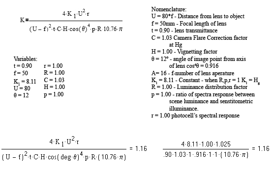

Thornton:
"Theoretically it's possible that all the factors could pull in one direction to give a higher than nominal speed. But I have never come across it in hundreds of cases. It is also true that some film makers have stopped quoting rigid ISO speeds in favour of an EI (exposure index) figure. The basis for this isn't always clear, but Kodak's own publications state that a four stop subject brightness range for full detail in shadow and highlight is considered normal."
His use of the term "film speed" is incorrect. Most of the factors he has listed will influence exposure, not the effective film speed. The films that manufacturers have stopped quoting ISO speeds were T-Max P3200 and Delta 3200. This is for a different reason than Thornton is implying. Not sure what Kodak publication states a four stop subject "brightness range" (should be luminance range) is from, but if the quote exists than there's a question of what "full detail" defines. The statistical subject luminance range is 7 1/3 stops and this excludes accent black and specular highlights.
