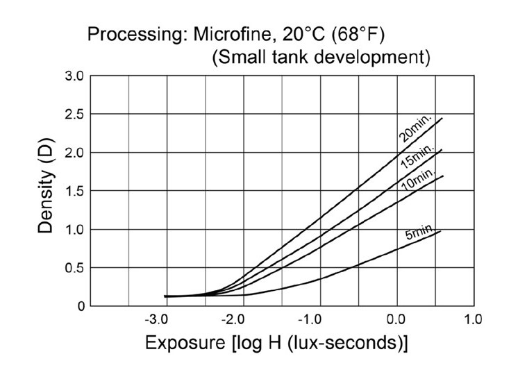

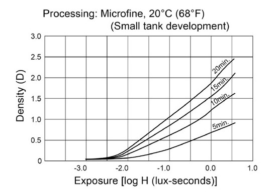

...Shape of the characteristic curve:
Fujifilm has explained - and it is also visible in the published characteristic curve in the data sheet - that there is steeper contrast and tone separation in the highlights (Zone VIII to X). More of an "upswing", disproportionate shape of the cc with more dense highlights.
Form my tests I can confirm that it is there - with standard agitation and developers, which produce a straight, linear cc (like DD-X, T-Max Dev, Tetenal Ultrafin T-Plus etc.).
Personally I don't want these more dense highlights. I prefer a linear shape of the curve, or often also a curve which is a bit flattened in Zone IX and X (semi-compensating development with a bit more highlight detail)...

Have you noticed any differences in the characteristic curves between 135 and 120 sizes of ACROS II for each developer type? Thanks in advance for your reply.
Sal, no I haven't got significant differences.
I am convinced in the end it is really a "non-issue", at least for photographers with a basic knowledge in BW film developing. As written in my test report, if you get a steeper curve in the highlights, just reduce agitation. More agitation leads to denser highlights, and less agitation to less dense highlights. And (semi)compensation developers and higher dilutions are further measures to limit highlight density.
As you have the knowledge and a densitometer you are perfectly prepared to get optimal results for you :smile:. And you already have got and posted your first perfect results with Perceptol.
Best regards,
Henning
