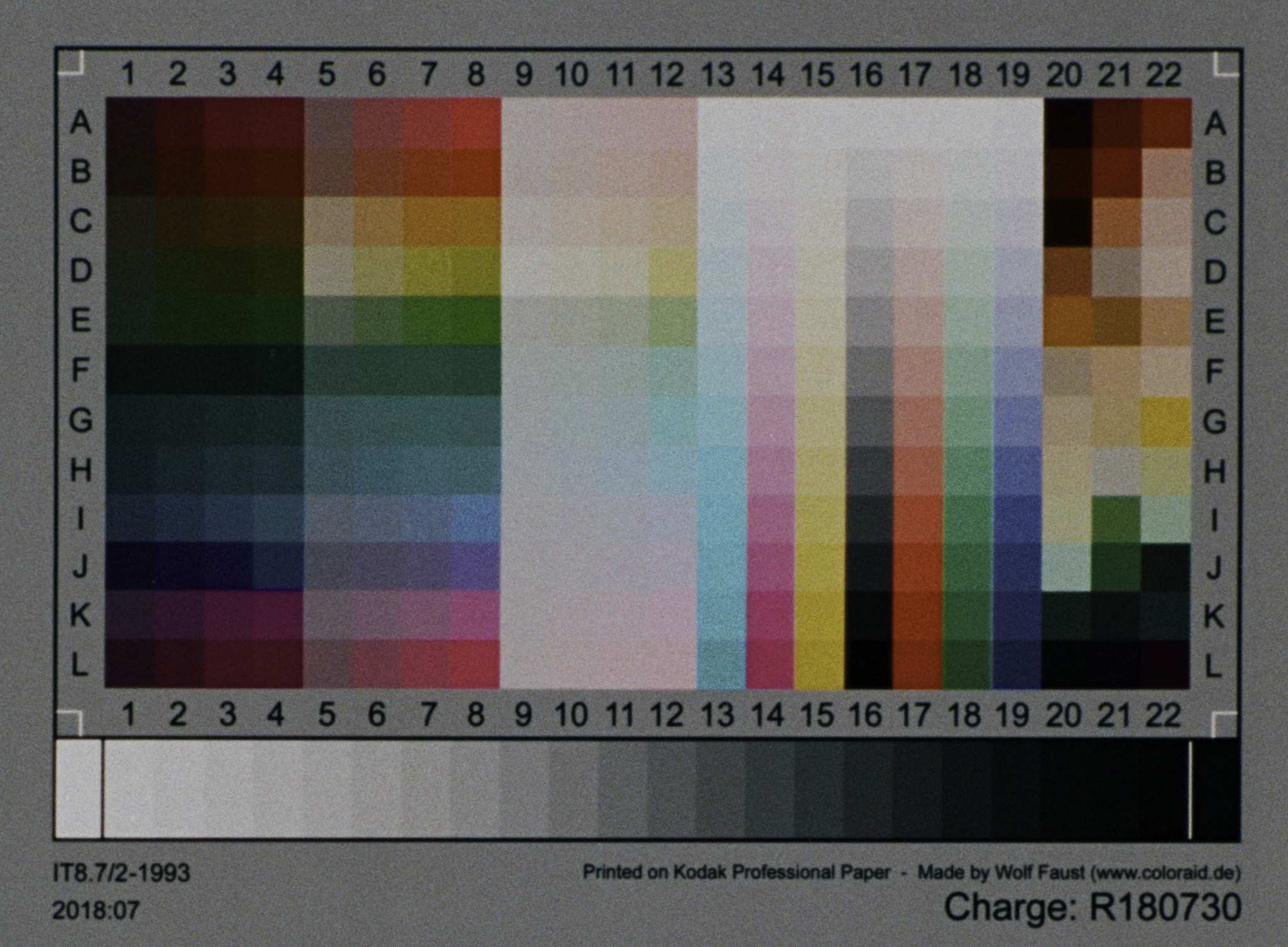

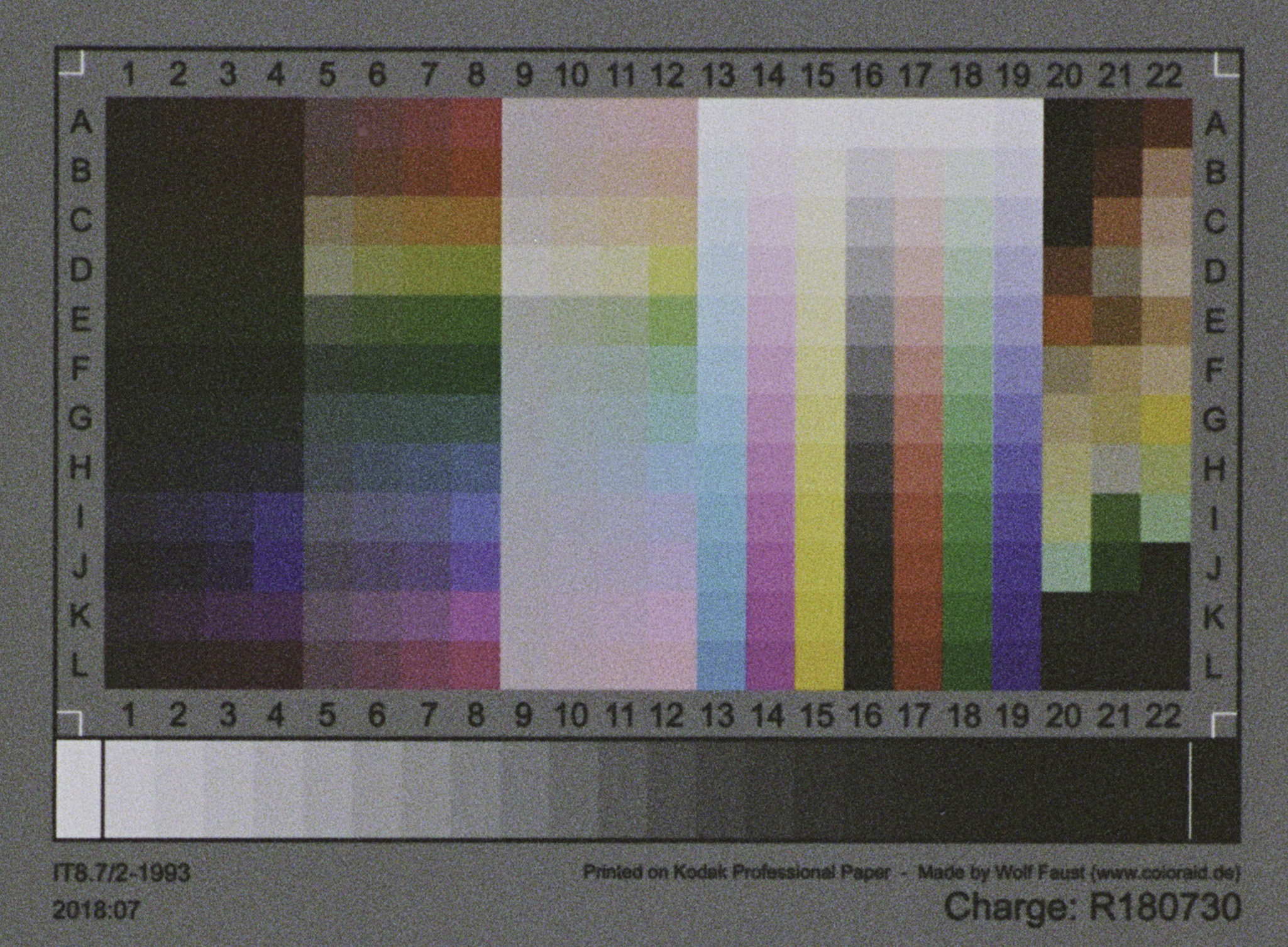

Perhaps I can un-lurk for a moment and finally chime in with a bit of useful information from my experience. I have a Noritsu LS600 scanner and have investigated its behaviour fairly thoroughly.
It's quite likely that the lab used a minilab scanner like the Noritsu (or perhaps a Frontier, which behaves similarly). These minilab scanners perform an auto-exposure and auto-colour balance on every frame, under the hood. Yes, underexposed shots will look slightly darker and over exposed will look slightly brighter, but the scanner generally tries to make the average values of the negative close to middle grey, as an evaluative meter might in a camera. Similarly, the scanner will try to balance the colour. Here is the Noritsu at default settings scanning a series of shots of the neutral grey bottom portion of an IT8 chart (bottom of the frame) laid over a neutral grey background (first pic) and then coloured cards (the rest). Notice how the colour of the neutral grey shifts to the opposite of the predominant colour cast in these.

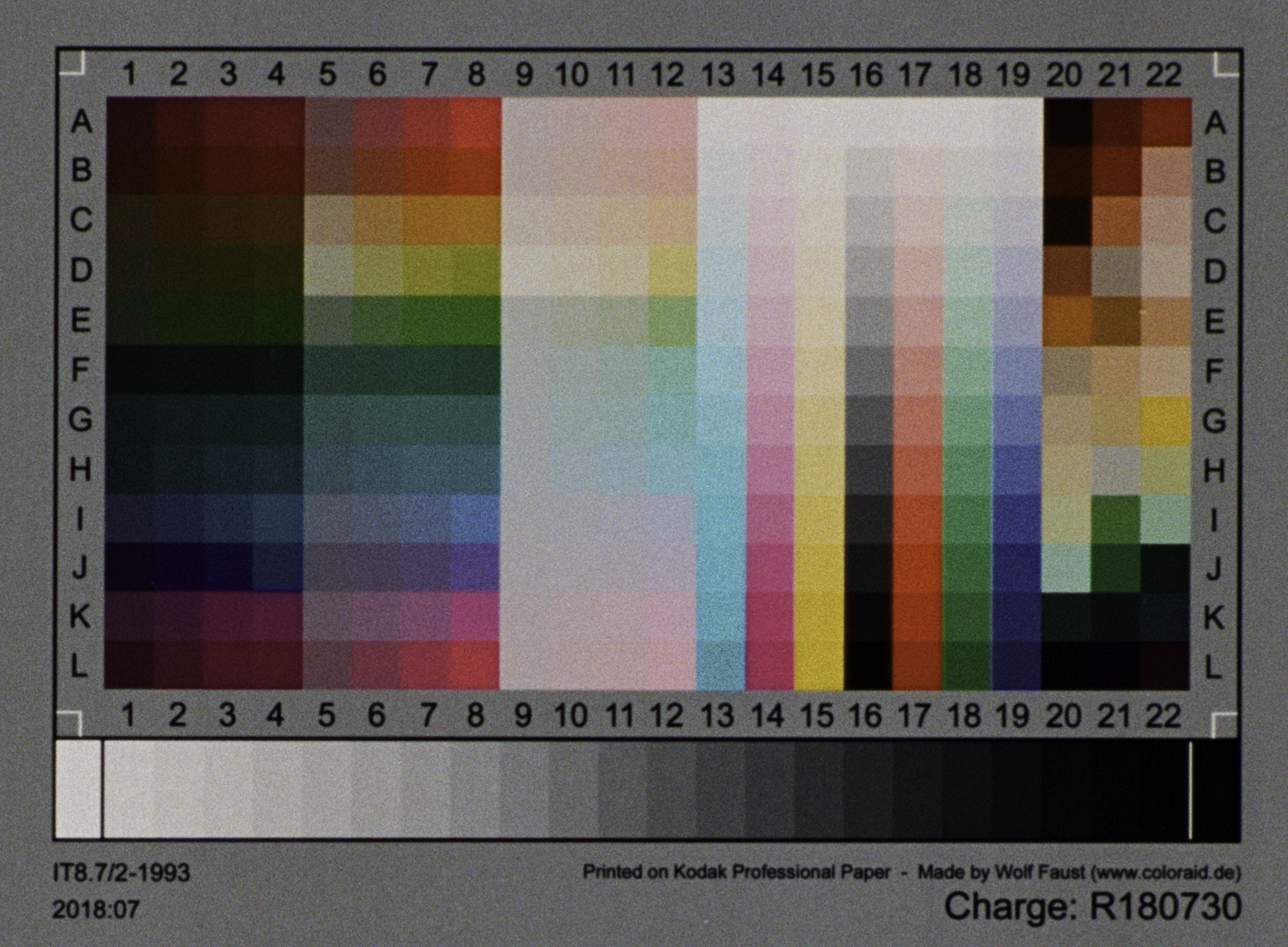

Sorry for the poor quality. It's a screengrab from a FaceBook group.
So this little test provides an extreme illustration of how a minilab scanner compensates for colour. There is some algorithm that looks at the colour in the negative and performs a colour balancing operation accordingly. This can be a little disconcerting to the scanner operator when faced with a series of shots taken in the same lighting and with the same settings: there are often slight colour imbalances from one frame to the next as the algorithm adjusts for the shifts in predominance of colour due to different framing. The immediate response is to use the scanner's cyan, magenta and yellow colour balance controls to balance for these. Or, the Noritsu offers a sub-menu option to apply the same exposure and colour balance compensation to all frames.
So in the case of a bracketed sequence, the colour in the original scene is constant, but on the negative it's not. There are differences in brightness (which the scanner will try to adjust for) and there are various differences in colour (due both to colour crossover and also a variance of saturation and hue with exposure level).... and the scanner also will try to adjust for this.
That explains why all of the scans in that video have similar-ish exposure levels. It also explains why koraks is correct to maintain that we can't properly draw useful conclusions about hue (in particular) as the scanner is making colour balance adjustments under the hood that vary from frame to frame.
@LolaColor, thank your very much for posting this illustrative example and accompanying explanation. This is indeed the very problem I'm worried about and that I have seen with various consumer scanners. It's very useful to know that 'pro-lab' scanners such as Noritsus and Frontiers behave in similar ways. The auto-correction they do may be a huge productivity boost for non-critical consumer work, but it becomes a headache in cases where you really need more control over consistency.
Another issue that I haven't touched upon specifically is the risk of non-linearities in the scanning process. A scanner essentially captures an analog signal and then converts it to a digital value. Particularly in the analog part, it's unreasonable to expect perfect linearity. Put differently: a scanning element (e.g. a 'pixel' in a CCD array) is unlikely to track its output signal in perfect proportionality with changes in the input. Over a certain range, linearity may be quite OK, but once you land outside this range, all bets are off. Especially when trying to scan parts of film with a very high density (meaning only a little bit of light is available for signal capture), it's quite possible that linearity suffers. If this also happens to varying degrees depending on which color is being captured (which, again, is not just possible, but in fact highly likely), color casts and in fact color crossover will be present in the digital representation even if it's not actually there in the film.
The problems with scanning are that we're dealing with partly intentional but uncontrollable adjustments (the 'under the hood' behavior of a scanner and particular its firmware and software as implemented by the manufacturer), and we also have undesirable behavior due to technical limitations (such as imperfect sensors and amplifiers) to contend with. The inconvenient conclusion of all this is that it's very difficult indeed to say something meaningful about how the color balance of a film behaves once you start taking it too far beyond its normal exposure range. While my personal stance is that an old-fashioned RA4 contact print is a more feasible way of getting a feel for how a film behaves (at least for amateurs like myself), I'm also very well aware that such an approach is still not bullet proof. All this leaves us with the somewhat nasty situation that in all honesty, we usually can't really tell accurately how a film behaves, especially if you start overexposing it by more than 2 stops or so, simply because we don't have the means to evaluate it with sufficient fidelity.

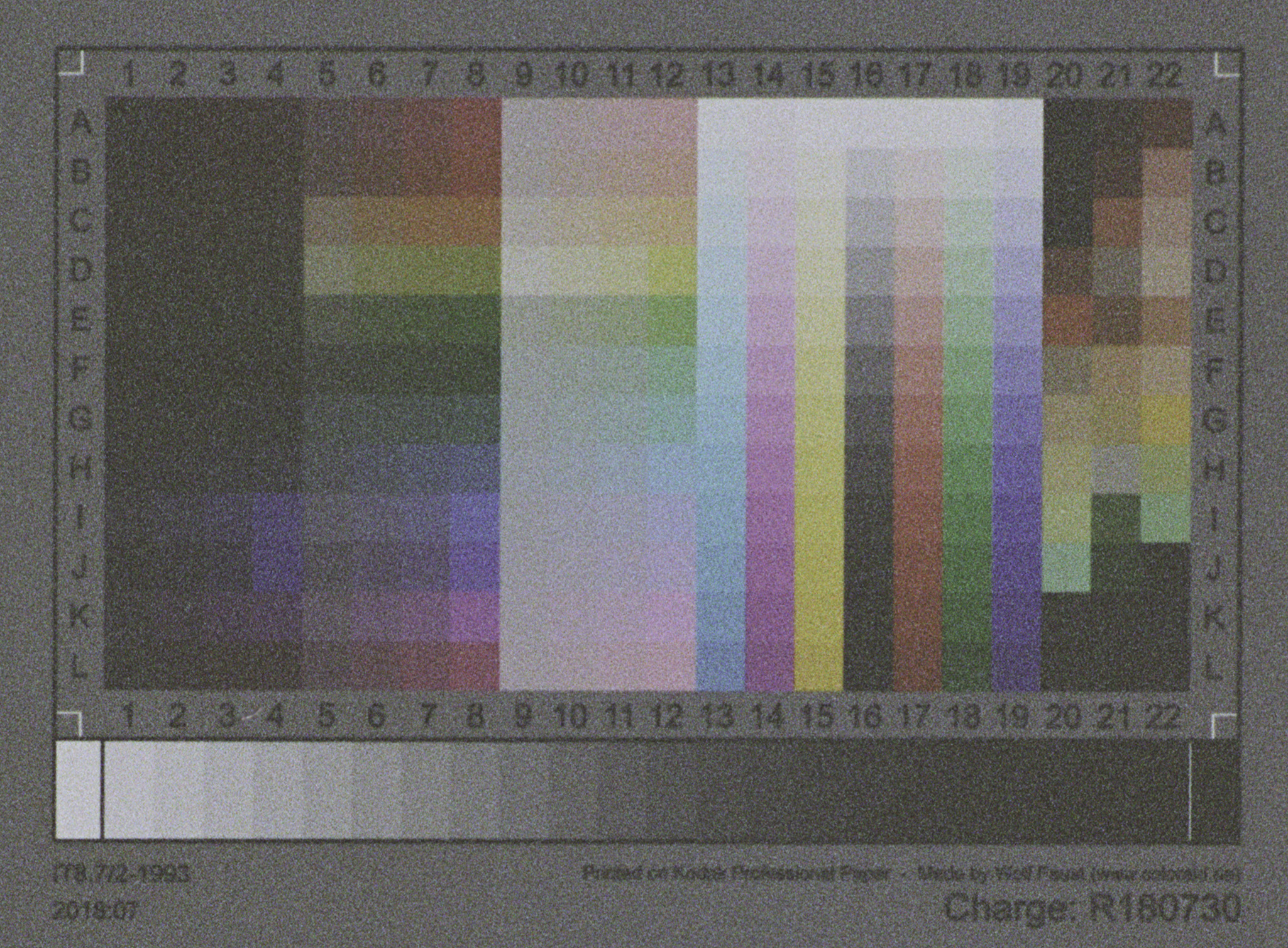

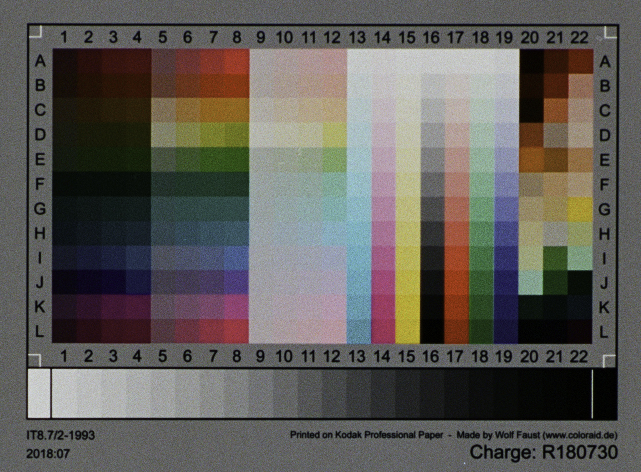

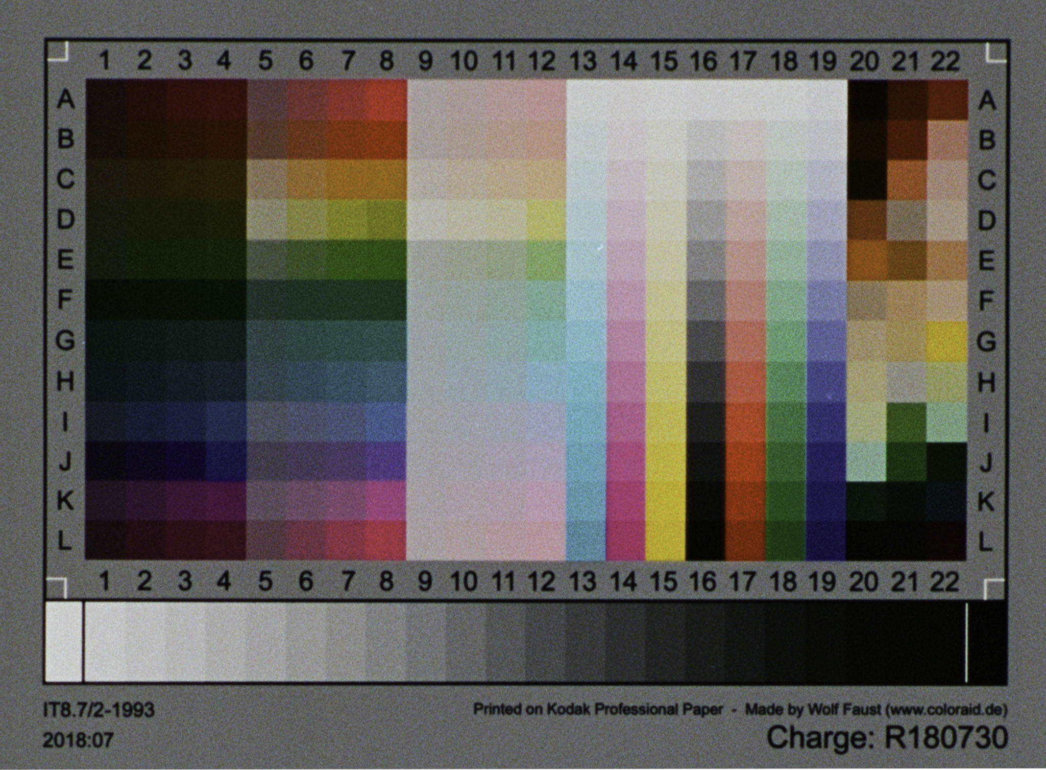

Apologies for the wall of images, but for what it's worth, here are some scans from a Noritsu of a bracketed IT8 chart shot on 400H at one stop intervals. Each scan was manually balanced on a Noritsu with "under the hood" adjustments disabled, so that patch F16 (18% reflectance) averages out to around 119, 119, 119 sRGB (middle grey) in each image.
If you download and flick through them you'll get a good visual indication of how contrast, colour casts, colour saturation and individual hues shift with varying exposure of Fuji 400H.... when scanned on a minilab scanner. Other scanning workflows will give slightly different results. But the general trend should hold true. The sequence is from -3 to +6, as noted below each image.
