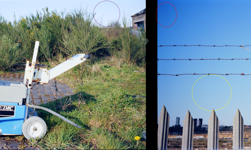

Here's an example from a couple of neighbouring frames that sort of illustrates what's going on. Both were made within a few minutes and metres of each other & both display overexposure issues. The fall off in the RHS frame makes it easier to see what's happening - red circle might be OK-ish exposure-wise (though it's on the edge), but the cyan starts to get going towards the centre (yellow) and then in the LHS frame where the exposure ended up being based on the undergrowth (you can see the trolley handle is needing burnt in & getting well up the exposure scale), you can see what happens as the cyan gets stronger - on this frame, the blue channel clips well before the scanner carrier edges clear to white. They're not as egregiously cyan as some I've had through my hands & I've kept them tonally flat to try and give a fair showing - the sky was was definitely blue, but not that cyan. A mild warming filter may well clean these up fairly well at the time of exposure - or at least make them less unpleasant, especially if printing on RA-4 in the darkroom - I've noticed that sticking to sRGB through the post-scan inversion process (arguably closer to RA-4 paper gamut) tends to keep the lid on colour flying off the scale when the exposure gets generous - something that tends to get forgotten is that coupler response in the paper is important too! I've found that if you incident meter/ spot meter the highlights Ektar behaves fine - and that on my Konica Hexar AF, the correct EI for its meter with Ektar may be between 100 & 200 - I shot a roll at 200, bracketed, then pushed it +1 to really torture the film's colour response - but at 200, I had none of the highlight problems I had at 100 - I'd suggest a roll of careful tests should get you on the money.

In this context, trying to compare 'out of scanner' results is only a test of the scanner's software, not looking at what the neg really can provide - nor is it delivering a realistic picture of the (very real) gamut limitations of the Epson. If you try and match them then you'll see the Epson's colour faults both more clearly and realistically.
Of course since I have a second opinion readily accessible, easy for me to know. Unfortunately others may see results like this and say that Ektar 100 goes cyan.
This of course goes back to the original topic, if one thinks the colors from the color negatives they are using is off, how would one know if it's the film, scanner or other?
