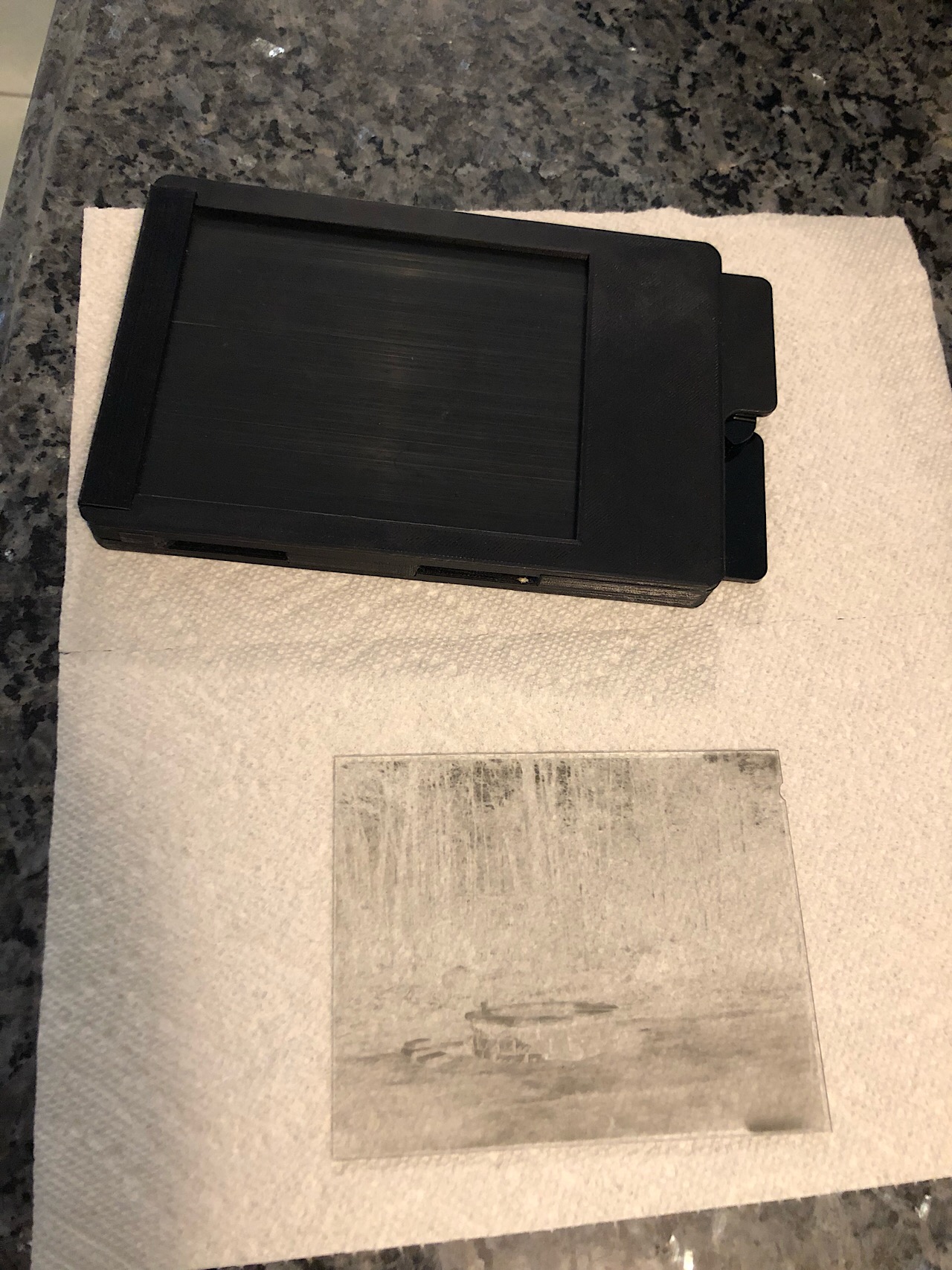

I’m happy to announce that I’ve just begun testing of a dry plate holder prototype which Chroma Camera and Pictoriographica have partnered to create! This holder is an affordable, quality solution to the problem dry plate photographers face in that this critical piece of equipment hasn’t been made in decades! There are high quality wet plate holders available that work, but honestly I’d prefer to carry two plates per holder just like I carry sheet film.
Leveraging our engineering backgrounds and our uniquely suited familiarity with dry plates and large format cameras, we have a design for a modern dry plate holder which meets the requirements that we as photographers ourselves would expect for quality, practicality, and — most importantly — affordability.
We currently plan to offer plate holders in the most common sizes of 4x5, 5x7, and 8x10 thru the Kickstarter.
Pic is of the two 4x5 prototype designs that I am testing, from which we will downselect to the final design in time for the campaign launch.

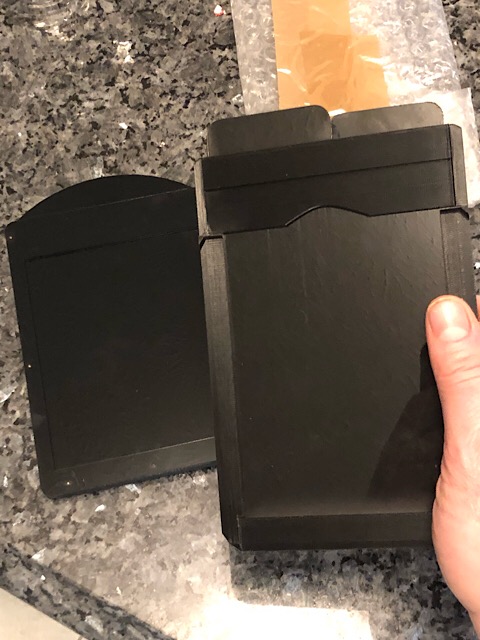

The prototype 4x5, 5x7, and 8x10 holders have gone through an iteration, and Steve is getting ready to ship the latest versions to me for testing. It’s been slow going since both Steve and I have been extremely busy with work, family, etc. I know he had the 4x5 holder at the Photography show he attended recently.
Update!
People interested in shooting dry plates often ask me where they can find holders for the plates. In the past, I’ve suggested auction sites, antique camera shops and shows, or to the handful of crafters making hand-made wet plate holders today.
My goal is to make dry plates accessible. I decided to do something about the availability of dry plate holders.

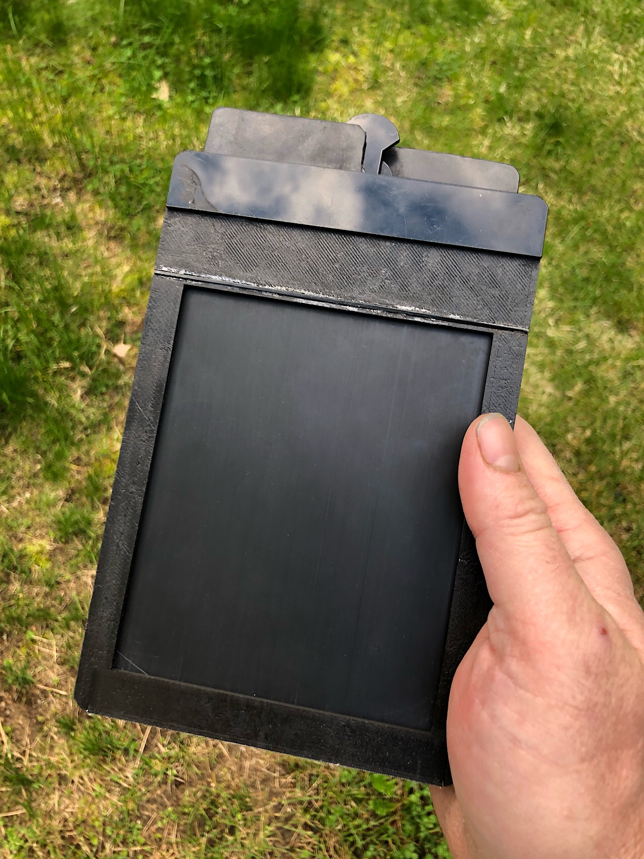

Results of testing the latest prototype 4x5 holder that Steve Lloyd (of Chroma Camera) and I are finalizing for our upcoming dry plate holder Kickstarter! Still needs tweaking but it’s in pretty good shape. If successful, the Kickstarter will offer holders in 4x5, 5x7, and 8x10. All other sizes will follow after.
Affordability, functionality, quality. The confluence of my experience in large format, dry plates, and my deep engineering background, coupled with Steve’s experience making the Chroma Camera, his large format passion, and his deep engineering background. Stay tuned!

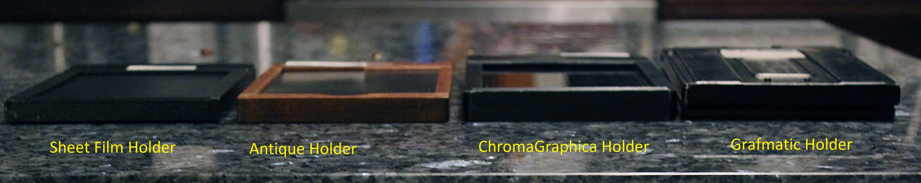

Here is a comparison of holder thicknesses.
